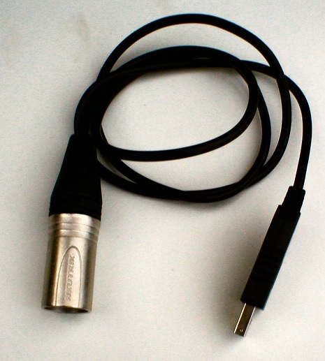

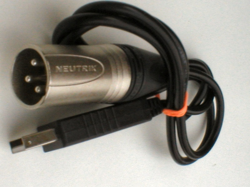

I can supply programming leads for the Penny & Giles / PGDT range of controllers ...price £20 including postage in the U.K. ...approx £4 extra will be required for postage overseas.
Please Note:-THESE LEADS ARE USELESS WITHOUT THE PROGRAMMING SOFTWARE.
I do NOT supply the leads with software ...YOU will need to browse the web / forums and acquire it.

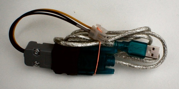

Leads are also available for the scooter S-drive controller... same price.
As are leads for Curtis controllers...see pic below for Curtis.

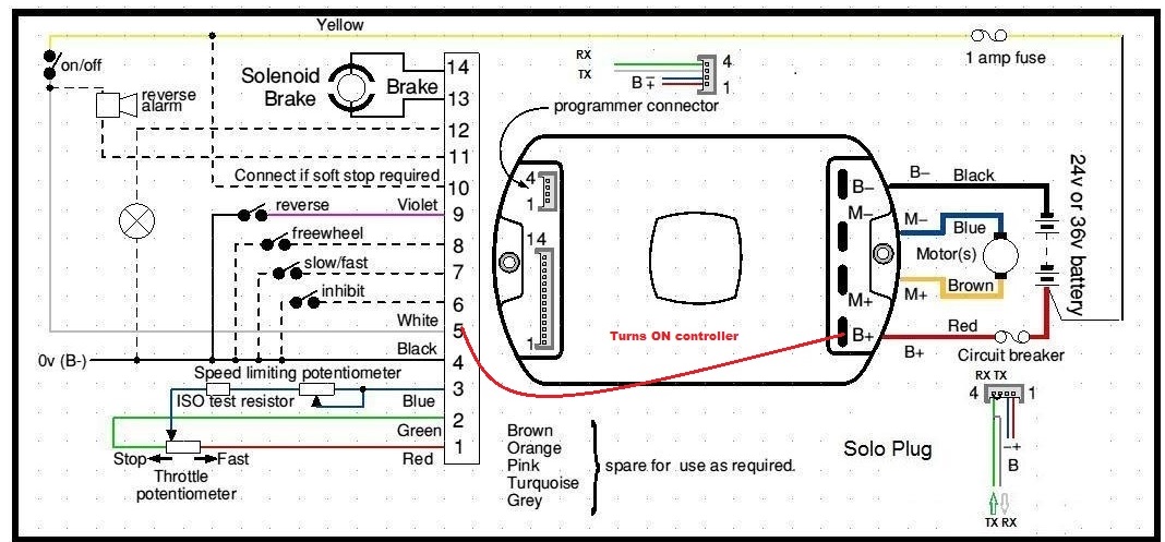

Postby Daveincaol » 26 May 2016, 23:20
Woody
Can you supply a programming lead for a Solo controller which has a 4 pin inline programming socket?
Dave B
Daveincaol
Posts: 41
Joined: 15 May 2016, 13:11
Re: Programming leads
Postby woodygb » 27 May 2016, 07:56
Hi Dave,
Yes ...or I can supply you the info to modify any existing PGDT programming leads that you have.
NOTE ...The SOLO requires INDUSTRIAL Programming software.
Woody.

Postby Daveincaol » 10 Jun 2016, 21:54
Woody
The Programming lead arrived today. Many Thanks.
Can I program the controller while it is sitting on the bench and does it need a 24v supply while being programmed?
Dave B
Daveincaol
Posts: 41
Postby woodygb » 10 Jun 2016, 22:33
It can be programmed on the bench and does need a 24v supply AND one wire connected from a pin... I'll look up the pin number ... to the 24v positive.
NOTE... That you'll need the INDUSTRIAL Software NOT the MOBILITY Software.
Postby woodygb » 10 Jun 2016, 22:50
Here you go ...
