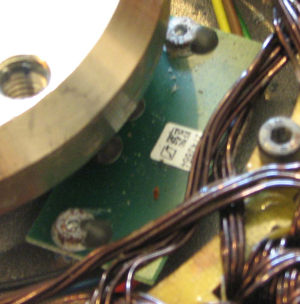

The sensor :

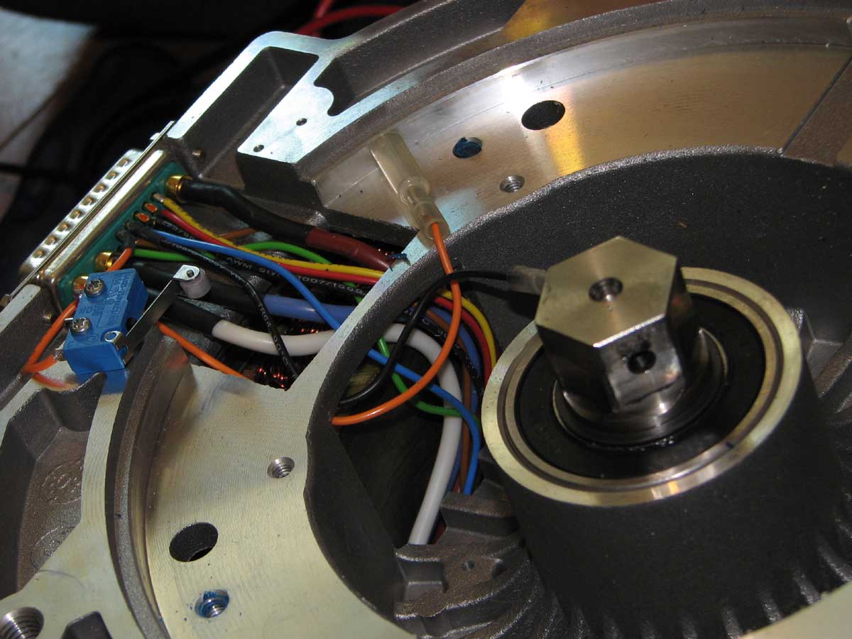

Postby shirley_hkg » 04 Apr 2011, 13:12
:D
Connector. 3 thick ones are power lines :
Posts: 4657
Re: Brushless Motors
Postby Burgerman » 04 Apr 2011, 14:02
That looks like a huge pile of possible problems!!!
Rather you than me.

Postby JoeC » 04 Apr 2011, 15:50
Thanks for posting those photos! I've never opened one before. It's amazing that these motors work as well as they do- I have to give some respect to the company for actually pulling it off. Also, with all of the rare earth magnets and large windings, you can see why they charge an arm and a leg for a replacement motor.
