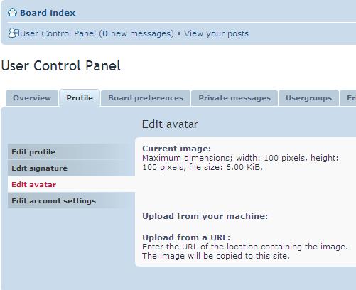

Postby woodygb » 14 Jun 2011, 22:00
Re: Marks very flawed LITHIUM article...
Postby nandol » 14 Jun 2011, 22:20
obrigado woodygb,i´ve tried that..didn´t work,i´ll try again
