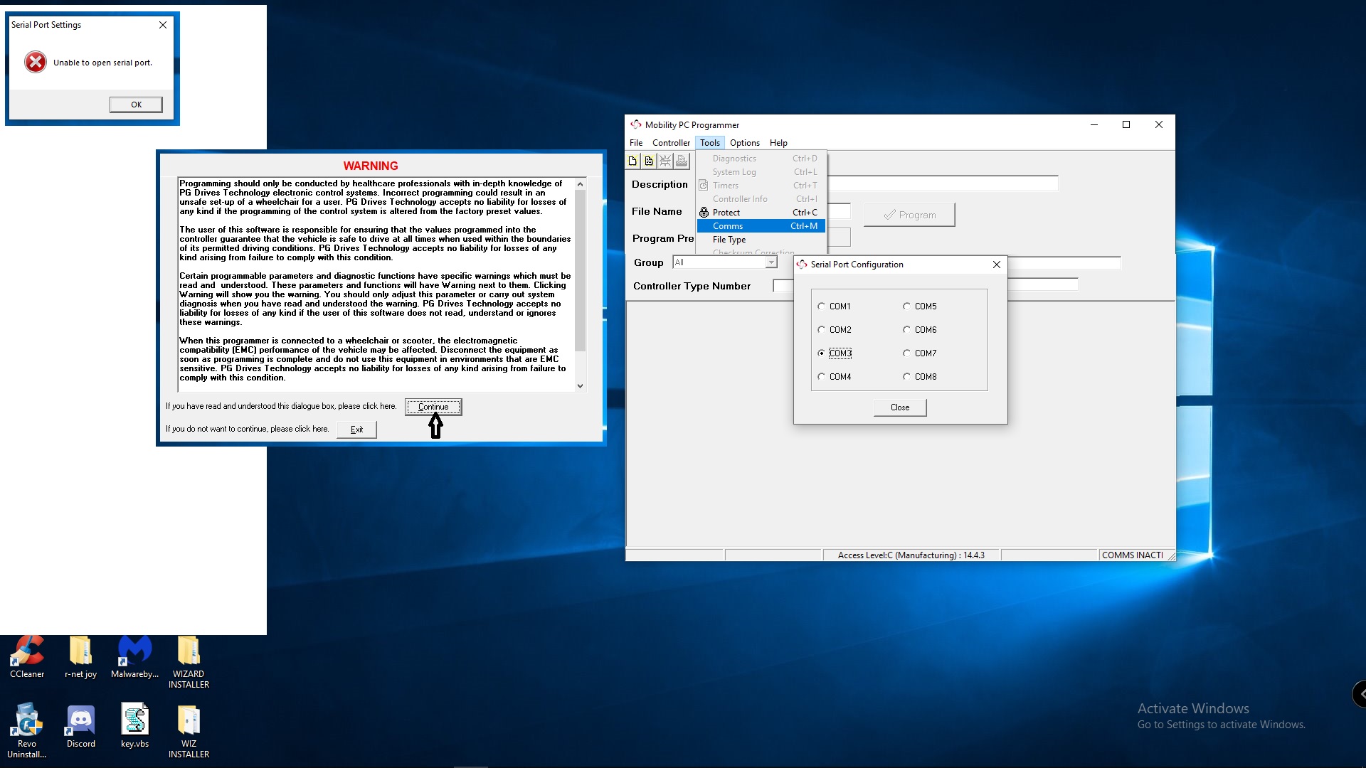

NOTE:- The software requires YOU to designate the CORRECT Coms Port and the Com Port number assigned to the programming lead MUST be between 1 & 8 inclusive.
The software may initially complain that it is
unable to open serial port
Follow the pic ...click Continue ...click Tools ..then Comms

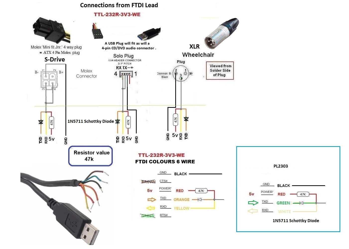

One Question: is this the Correct Wiring ?
Stern-300E24V
Posts: 6
Joined: 21 Jun 2021, 10:21
Re: Where to find PGDT programmer software
Postby woodygb » 21 Jun 2021, 13:22
Yes ....here is the latest that uses a Schottky diode
download/file.php?id=15638&mode=view

I will try it with an CP2101 USB to RS232 and an 1N5819, because: i have both items here....... i will report...

The new Controller works now, and my Mom means, its driving a littel bit faster as with the old one ?!? I read the Params form the Old Controller and wrote it to the new one, i changed nothing..... Dosn`t matter, it works !
The Cable (Link somerwhere here in this Thread) works and the CP2101 works also with this Cable and Controller !
