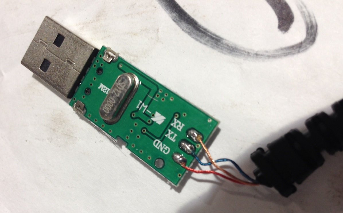

Most USB - Radio Programming cables seem to work ...but not all.
The number of wires is normally three ..but can be four ...colours vary depending on the whim of the Chinese supplier.
E.G.
http://www.ebay.co.uk/itm/USB-Programmi ... 565bb777a0
Re: VR2 programing
Postby woodygb » 24 Jan 2014, 17:23
The photo's show the diode being soldered on the internal board ...this entails "popping" open the USB case which can usually be done by gently squeezing it in a vice.
IF you can identify the RX and TX wires then you may want to put the diode in the XLR plug.

Postby mous3 » 24 Jan 2014, 18:39
thank you loads that just what I needed
