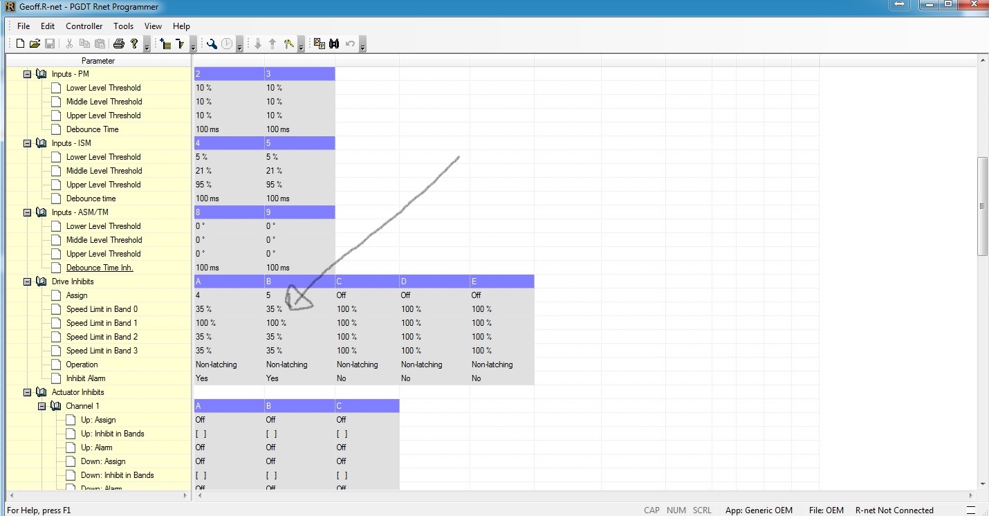

BM
Is this the correct place to disable the tilt inhibit crawl mode, I presume I just set it to 100% if it's not correct can you please show me correct location to disable it
many thx john

Postby Burgerman » 10 Nov 2014, 19:07
I think so. Its a bit like guesswork. OK if its right. But if you didn't set it up, or know what the names or inputs are called you cant be sure.
Just set everything marked inhibit on every profile and every band and every option to 100 one at time until you find the right one if not. Really everyone needs an OEM programmer themselves to play about and get things correct over time.
