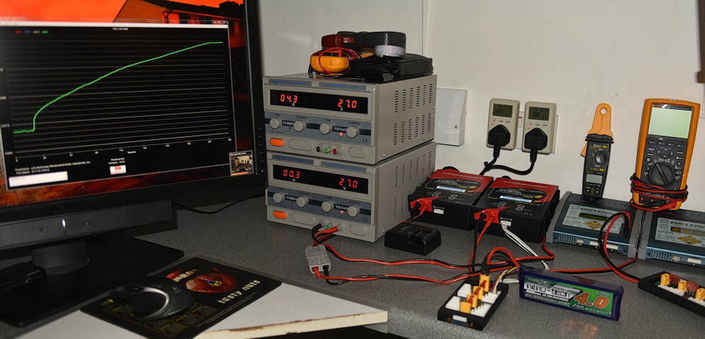

Postby Burgerman » 05 Feb 2015, 19:07
Shirly_hkg you need to treat yourself to a 40 amp charge 1A balance 1344 watt PL8v2 charger.
Here are 2 FMA PL8v2 chargers.
And 2 Hyperion 1420.
And 2 40A 30V power supplies.
I can charge anything!
Posts: 71096

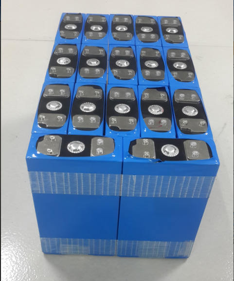

Someone on this site is going to build a 24V 180AH block
He means nandol. But I wouldn't do it this way. For a number of reasons. Not the cells that are a problem, because even though they are lower C rate there is enough added Ah to cope - at least on a 24 volt pack. Although quality or service life/reliability is unknown. And finding or swapping a bad cell is almost impossible as the hundreds of small cells are all welded up...
But the charge system is messy, offers little information, is slow, and relies on a weedy low power BMS balance circuit...
So I watch with interest!
My 3240wh pack made from headway cells can be bought for around 950 uk pounds for eg. 1300 us dollars. So not sure there's any advantage doing this. Although a larger capacity increase is possible. A 24V 120Ah pack would be under just 1k with headway cells. http://www.evassemble.com/index.php?mai ... ucts_id=21 for a price.
But if I did use those cells as they allow a bigger capacity, I would throw away the bms and use a 40A PL8 HOBBY CHARGER so that they were properly and safely charged and so I could graph and see that this was the case. Because it takes 40A to charge a 180Ah battery in 4.5 hours.

Postby Burgerman » 26 Mar 2015, 22:46
120Ah is the most you will fit using headways.
That will cost
$18.99 x 80 cells. $1520
or...
£12.63 x 80 cells. £1010
That is for cells that will give you FULL rated capacity, and are 10C rated. And 2000 cycles tested.
See http://www.evassemble.com/index.php?mai ... ucts_id=21
BMS that you would connect up and use ONLY for charging £12
http://www.evassemble.com/index.php?mai ... cts_id=209
If not that one find a better lower voltage one... BMS are cheap. You would connect the powerchair directly to the battery like lead. So BMS only working for charging.
Charger?
Any 12V charger, designed for say gel. Or AGM.
You have some.
Or, from http://www.evassemble.com/index.php?mai ... cts_id=167 £24
I doubt you will measure the full capacity from the smaller welded cells. Probably nearer 150Ah if you did a full capacity test on a hobby charger. I would need to test a couple of cells to find out for sure. But I have looked at these small cells in the past and they don't often measure full capacity.
£1010
£24
£12
+ carriage. And you MAY have to pay tax but so far no problem here.
Also needed cables and connectors (Andersons?) etc. All these prices are on the evassemble site.

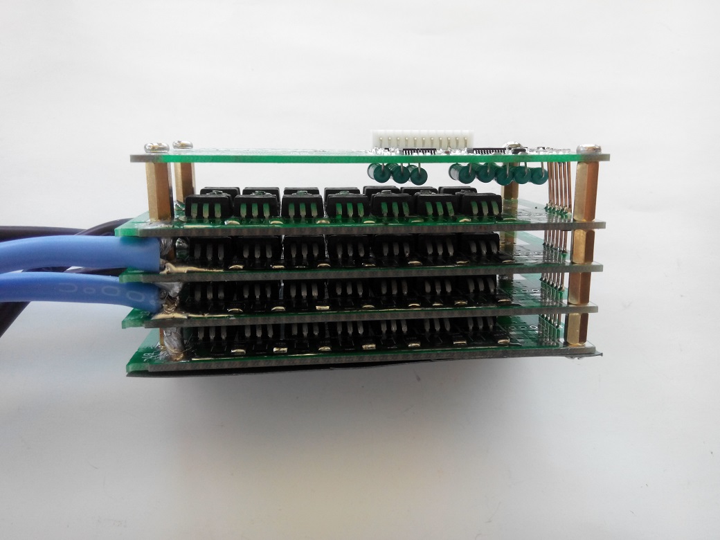

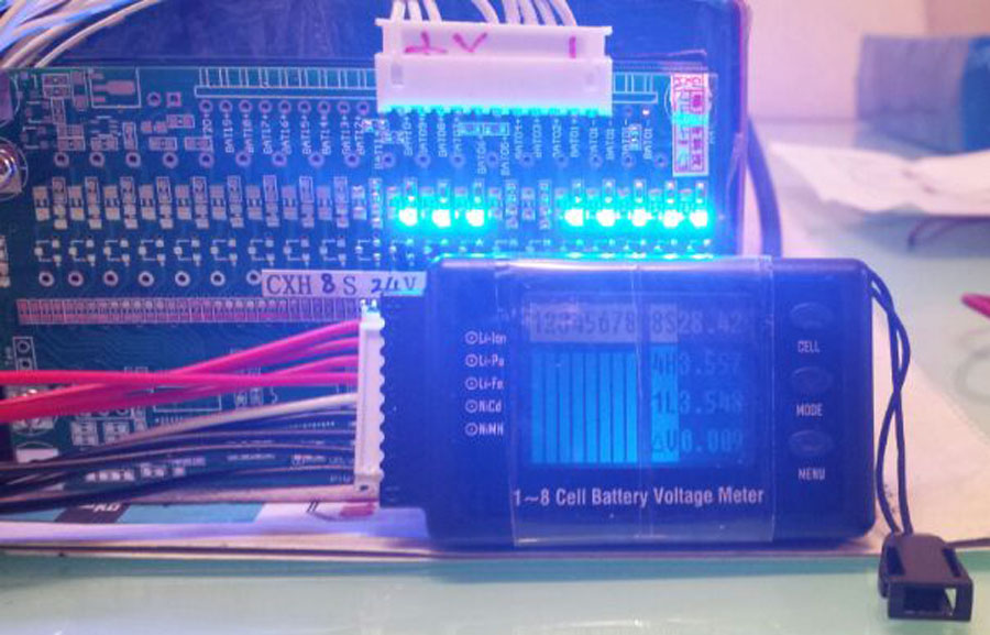

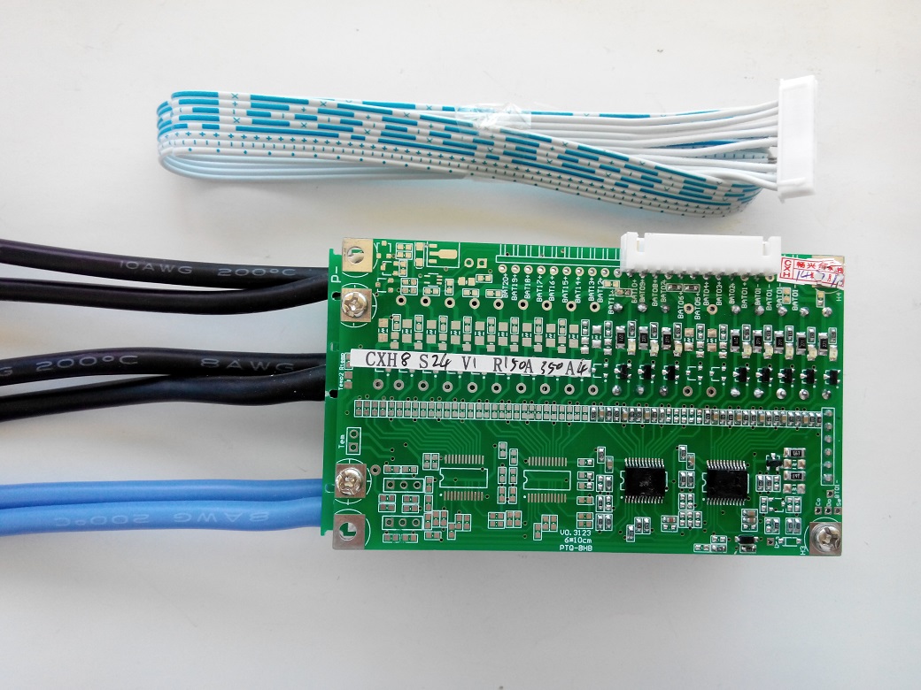

;) Battery will have a even bigger BMS , 180A / 400A , powerful enough to drive your chair through it.
Worry about being strangled by malfunction of BMS ? Add a jump start power line to by pass BMS completely . In case of emergency, connect the plugs / flip a circuit breaker, so chair resumes power and go home .
What do you tnink ? :)
Posts: 4656
Re: alternative charger for lithium?
Postby Burgerman » 28 Mar 2015, 09:27
I think that I would throw it away!
And use a 40A PL8 or similar hobby type charger.
Then I can see any cell balance issues, failing cells or connections etc as I charge. Graphically in detail. And I get to see how much in, out, etc. And have accurate adjustable charge control, as well as 1000mA balance capability. And its still simpler to connect everything up than what you have there. And one connector.
Other than charging all the rest of its functions are not needed and may cause issues. To me it makes things more complicated rather than simpler! And adds more complication, failure points, and less capability.
But it will work.
For Nandol who wants to be simple and use a dumb 2 wire charger its really the only alternative. I would still connect the chairs power system directly to the battery, and only use it as a cell balancer. Then its less likely to die, or cut out etc in use.

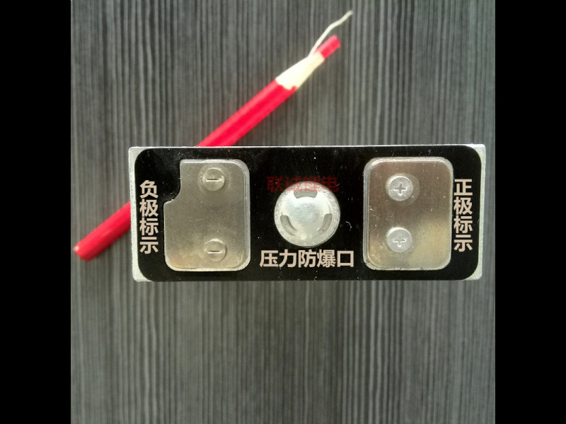

What are these LiFeSo4 cells? (instead of the LiFePO4 that we know are safe/2000 cycles etc?)
Posts: 71096
Postby shirley_hkg » 28 Mar 2015, 10:05
New old stock. Continueous 3C, instanteneos 5C (30 sec)
3.2V 20Ah LiFeSO4,3C,型号LP2770134-20AH
