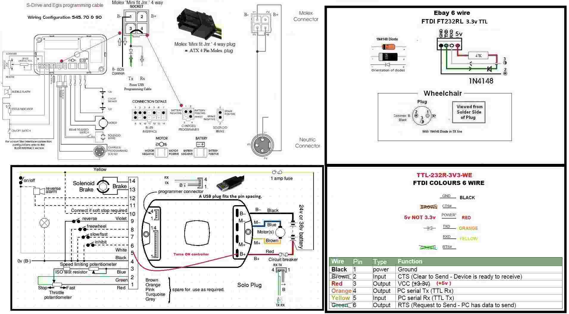

Postby woodygb » 12 Oct 2017, 15:27
http://homepages.spa.umn.edu/~frahm/CustomCable2.pdf
You simply alter the connector in the above guide....note the guide wasn't made by me.
Careful with the colours in my pic as they do not match that of the recommended FTDI lead ...rather than a cheap Chinese Ebay purchase... which are Yellow RX, Orange TX ,Red + and Black-.

Postby BulldozerDK » 13 Oct 2017, 14:28
woodygb wrote:
Software can sometimes pop up in private messages.
I appreciate it, but unfortunately this does not get me any further than what I already read multiple places. - I am sorry, I might be a bit slow, but I would appreciate a bit further assistance;
The guide that you link to seems a bit off, it is with an XLR plug as I only have the 4 pin no-name connector
I have a connector that will fit that plug, but based on the shown image and the linked guide I do not feel certain as to which pins to use from where;
Is it because I need the FTDIdevice(which seems to be parts from Arduino work)?
I've tried to attach a document containing pictures of my equipment, I hope that someone will be so kind to look through the pictures to see if it is even possible with said equipment? https://1drv.ms/b/s!AjoFHPKwGUx6hKR9ZF1dnnem2-RUlg
Also, does anyone have a assembly guide for a cable for the Solo drive only? one-to-one guide maybe even?

Postby woodygb » 13 Oct 2017, 15:36
I recommend an FTDI lead.... specifically the TTL-232R-3VR-WE .... other types of USB-TTL Cables MAY work ...but not always.
Your using a SERIAL Lead ..it WILL NOT WORK.
The guide does show an XLR being fitted.
Simply alter the connections to the different plugs .... THUS.
I use the MALE XLR Version ...then have the other 2 plug types on a FEMALE XLR and simply swap ends/plugs over depending on the controller.
Postby woodygb » 13 Oct 2017, 17:09
Updated pic to try and make it clearer.
Hopefully it's clear that the SAME LEAD CONFIGURATION is used on ALL the plugs... just wired to different numbers/places.
Postby BulldozerDK » 13 Oct 2017, 21:28
Thank you once again.
I am very sorry to be the slow guy in here.
I have now looked through local webpages to find a dealer in my country who can provide these specific models, with no luck.
So I placed a few orders from Ebay that should get me the devices.
I believe I understand the setup now, I just never saw any models with XLR or the molex connector. We have 95% PG Solo controllers in the models sold here, and the rest being Dynamic controllers and a few others.
I hope I'll manage to build it once my hardware arrives.

Postby BulldozerDK » 31 Oct 2017, 23:06
woodygb wrote:Note that I can supply the leads should you wish.
If your in Denmark you have a branch of Mouser.
https://www.mouser.dk/ftdi/
Sorry, did not see that reply until now.
I managed to get the FTDI adaptor from a guy in UK selling on Ebay, while ordering the diodes from Germany and having the resistor in stock anyway.
And it worked, I managed to fix quite a few issues that we have had over the past. Thank you very much!

Postby woodygb » 01 Nov 2017, 00:08
Here you go......

Postby woodygb » 01 Nov 2017, 00:43
As for the Solo D50052/6:
Has anyone experienced that the engine driver/solenoid brake suddenly stops working. Everything else works fine but from one second to another it would stop working. I have experienced it with two controllers mounted in the same test board I have a feeling that a resistor mounted in place of the solenoid brake was causing the issue as this was on 30R and 20W instead of the nominel 50R.
The controller software doesn't seem to care much about a correct resistance value as it's usually just checking for an open circuit.
I use a 24v relay ....this gives an audible indication of the brakes being set or released....if you use one with a clear case you'll also get a visual indication .
A low wattage 24v bulb should also work instead of a resistor.

Postby BulldozerDK » 01 Nov 2017, 00:51
woodygb wrote:The controller software doesn't seem to care much about a correct resistance value as it's usually just checking for an open circuit.
I did not want to try just using some small usage device, I just see a lot of power being consumed in the heating of the 20w resistor, but that is of course a given if it is just sitting there using that much power for no reason at all.
I have mounted a small LED to give me the visual indication while the relay in the controller it self provides a clicking sound.
Maybe I should just give it a go, I think I will go for the relay solution. - That could be used for something else as well. - Thanks for the great Idea!
