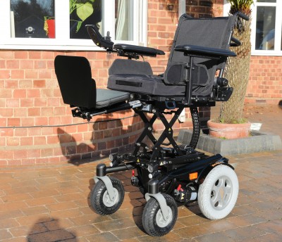

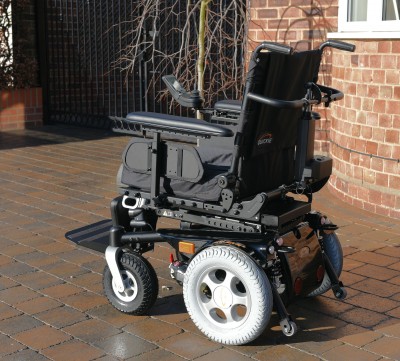

Right, getting up for a few hours today. So a quick pic or two. This is with everything done except
- rear wheels and tyres.
-Jay3 seat back.
Those are still to be done. As soon as the parts come.

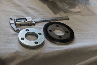

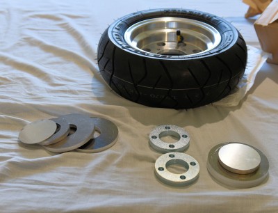

And now my lazer cut wheel adapter parts are here. 3 days! And now to mark/drill...
On the left.
Remember this:
Spacer ring:
Inside diameter 41.5
Outside diameter 110.0
Cover plate 2 parts.
Posts: 71096
Postby Burgerman » 08 Feb 2018, 00:06
Marked the easy way. Sit one on top, and spray paint to mark holes.
4 times...
Then drill 8.5mm on all plates. Two used each side as the laser will not cut more than 8mm and I wanted 16.
So two halves will get bolted together.

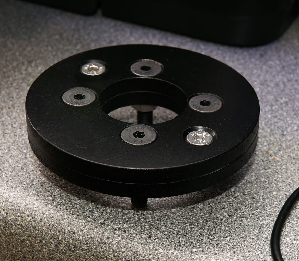

Postby Burgerman » 08 Feb 2018, 00:19
Part done, hard work when all your drils, allen keys, bolts, files, are all on the floor... So not done yet.
This bolts on in place of the otiginal spacer/wheel. And it will tomorrow have another 4 holes, tapped M8 for the new wheel at 92mm PCD. Near the outer edge.
Then theres 2 more parts that wiull bolt to the centre to centralise the wheel, and to give a flush finish on the wheel centre hole. As you will see. The black bolts fit to the chair. No nuts used. The two stainless ones just hold the two halfs together.

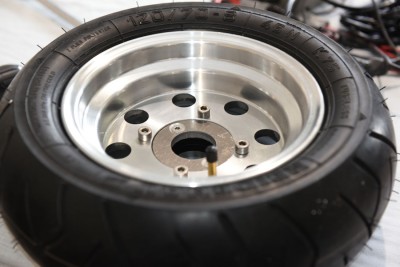

Postby Burgerman » 08 Feb 2018, 14:32
Wheel adapter bolted to wheel, no cover, needs cleaning up, spraying black etc.
And it then gets a 1.5mm thick cover, that will be polished, and held on with two 4mm countersunk screws.
And then I get to start all over again andmake another one for the opposite side... The fun. :cussing

Postby Burgerman » 08 Feb 2018, 15:51
Screws done (1st wheel...).
Just needs a polish and fitting. Centre cap bolts are not fully tight here.
Makes you wonder why they dont offer a properly sorted chair for control freaks. It woud sell.

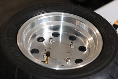

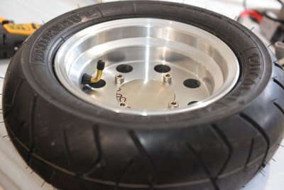

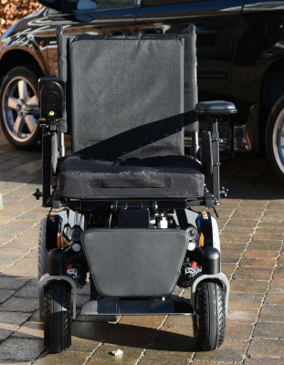

Postby Burgerman » 10 Feb 2018, 21:31
Done! Rims fitted. Just awaiting back/headrest. And removal of push handles.

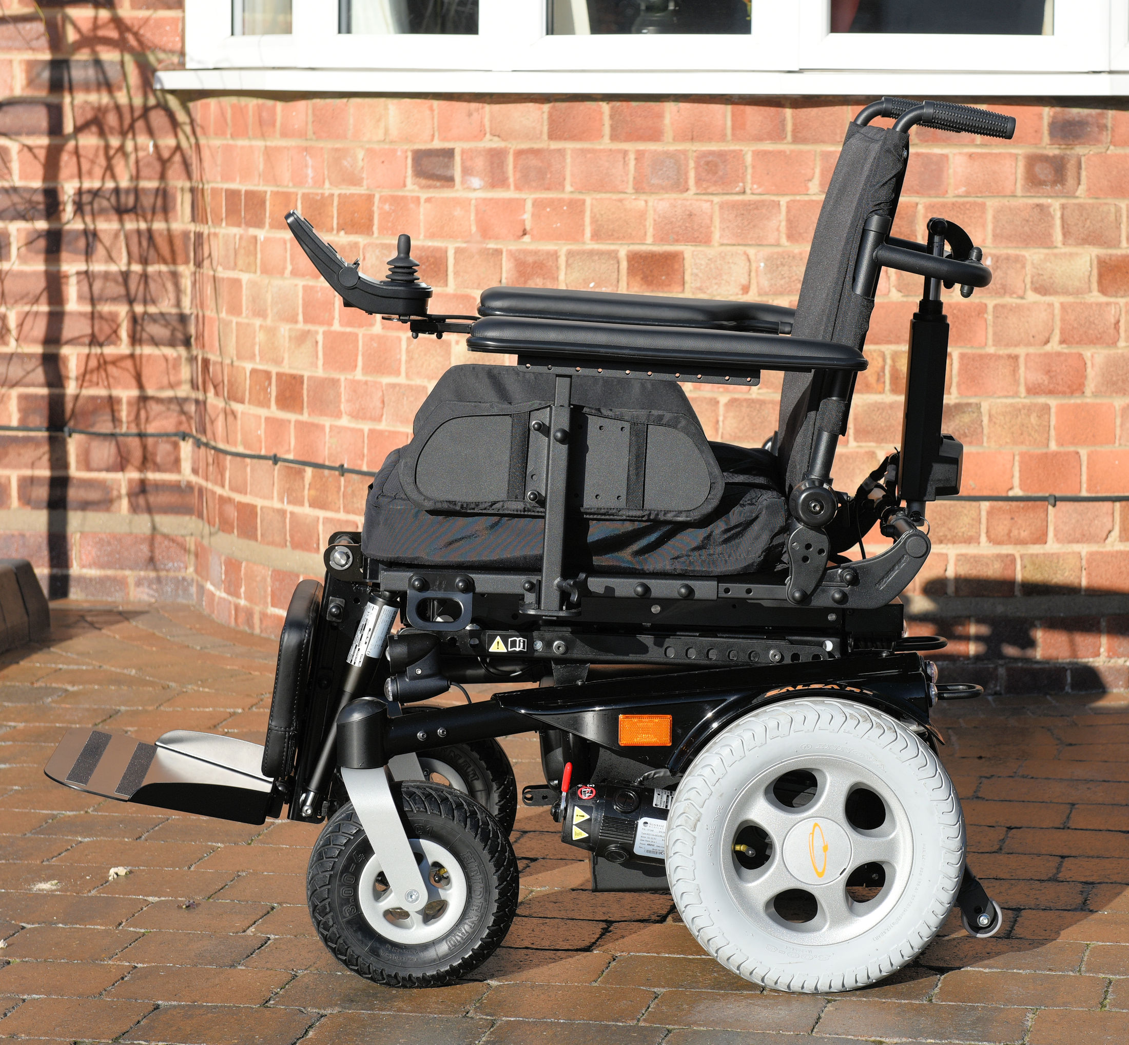

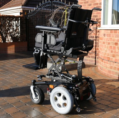

Postby Burgerman » 10 Feb 2018, 22:25
Amazing how much difference a few small changes, seat position, modified centre footplate etc can make.
From nasty and unusable to cool and works!

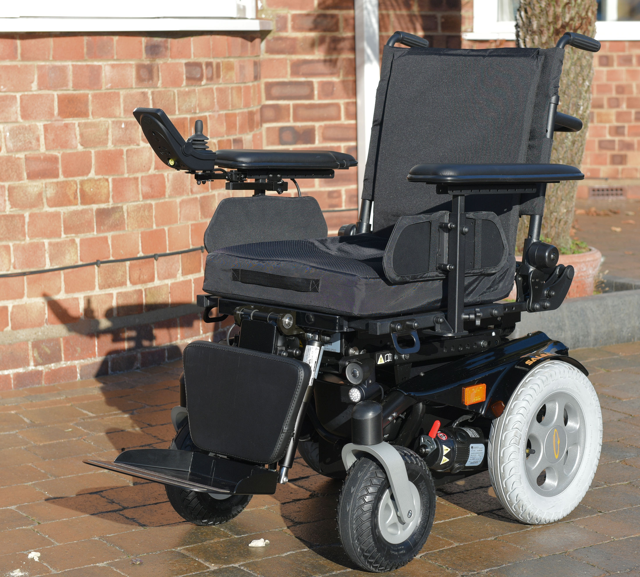

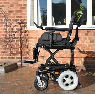

Heres what they look like stock, note seat position.
She is sat over the front. Wont steer, no rear grip, drives like an oil tanker. And nothing you can do because her feet have to be in front of the casters as they rotate when reversing. Stupid. Even worse if you are fat! Your weight is even further forwards.

Postby Burgerman » 10 Feb 2018, 22:34
Seat is only around 3 inches further back And feet maybe 4 inches too. But that makes a huge difference to controlability and feel. The slightly wider rear tyres give more steering "leverage" too, also helping steering response. Footplate still too big however. I see a saw in its future...

Postby Burgerman » 11 Feb 2018, 12:11
No image?
There is no right position, only the best for you. I like my chairs light on the front, centre footplate so that your heels are between the caster wheels, and legs tucked as far back as the footplate/casters allow. That aids steering, feel, and allows less battery to be wasted steering, and gives better control on carpets, grass, slopes, ramps etc. And makes the chair shorter with no corners to hit doorframes etc when turning into rooms or turning around in a confined space. Also means a flat caster tyre or even one wheel missing does not prevent you getting home from the pub! Or even going to the pub!
Too far back gives less stability climbing a ramp forwards, and you tip out. But allows you to more safely decend a curb or ramp forwards. Best position is the one you prefer.
Look here: download/file.php?id=7710&mode=view
My back/my back is about 1.5 inch ahead of the rear wheel centre point. And my seat cusion front is about 1.5 inches behind the caster wheel barrel.
Look here: http://www.wheelchairdriver.com/BM3-con ... 3-crop.jpg
Same thing. Only more so. Why more? Because the new chair has 100lb of heavy seating up high! And it would tip me out on a ramp.
Then look at a stock chair: download/file.php?id=7709&mode=view
And look at the footrest position. It must be that far forwards as the caster rotates as you reverse.
