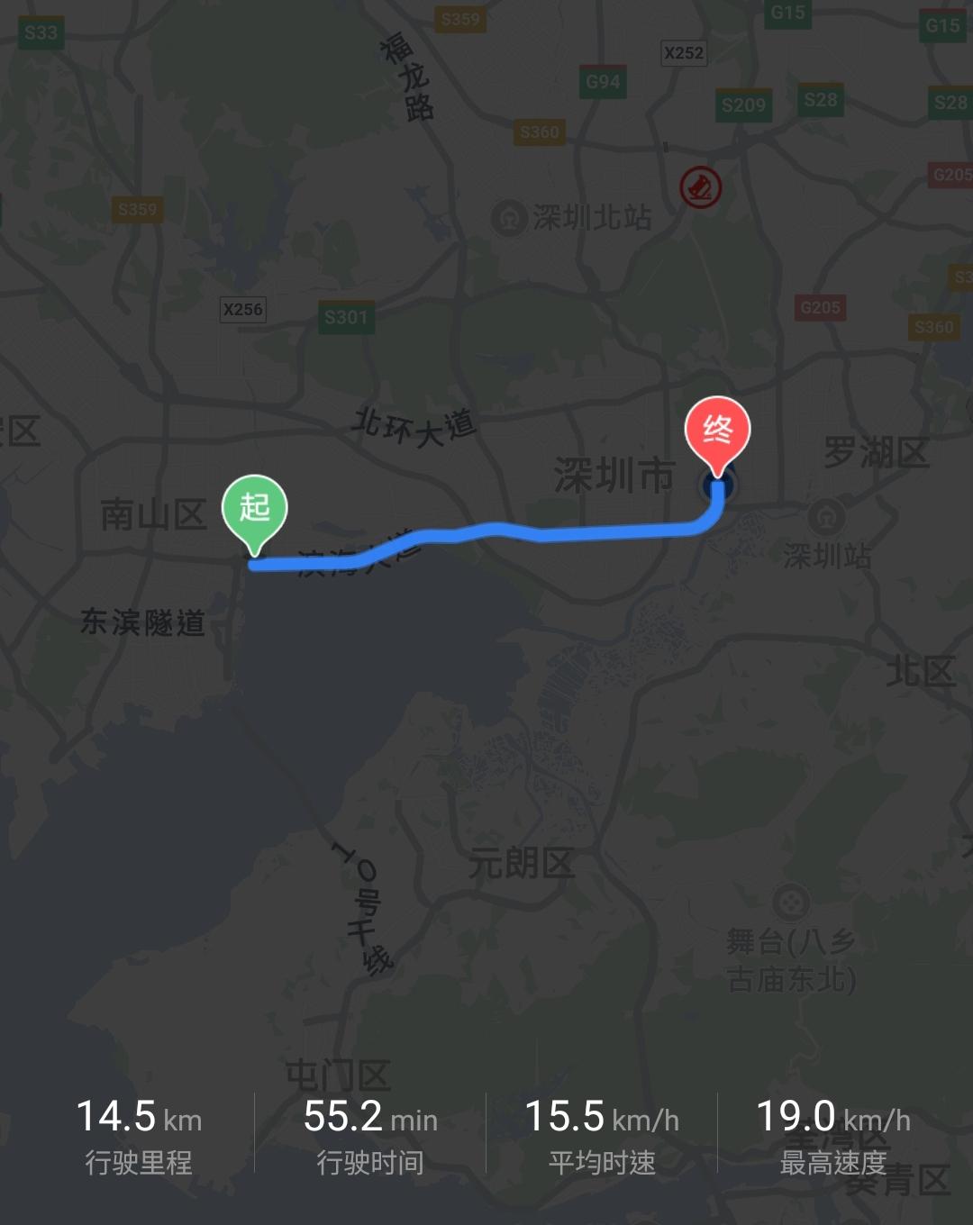

Run a quick trip to find out shipping quote this afternoon ; 35℃ under the mercyless sun.
Avoid slowing down as far as possible , but only get average speed 15.5km an hour .
Best I can do .
Hat off to snaker , who ran 8 hours non-stop.

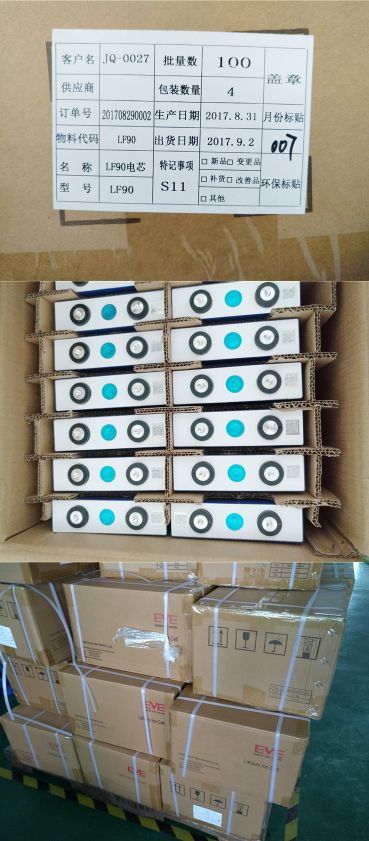

goodpost Air freight : £6.75 / kg to UK ; custom fee included . No more extra at all . That's what I've been told. :worship

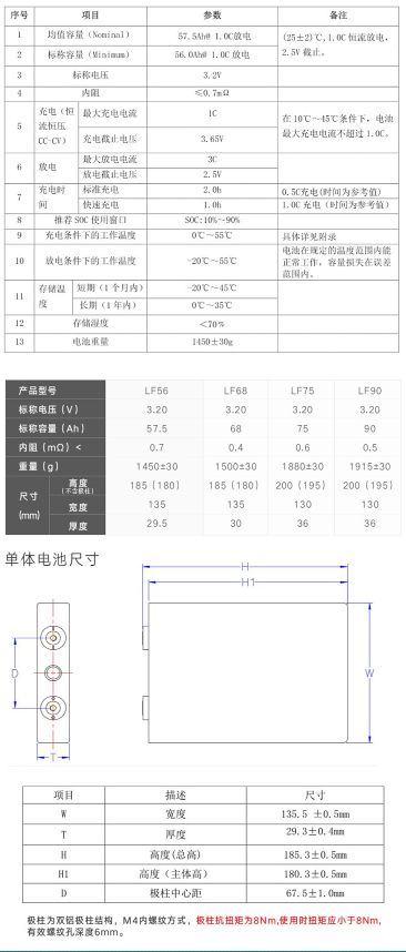

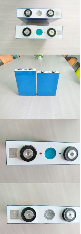

EVE-LF90 , Rated --- 3C (5C max) ; IR @ 0.5mΩ .
90Ah cell , 2017/8/31 NOS @£27.50 :clap
* * * * unknow batch NOS @£18.80 :dance
Any guinea pig ? ? ? drunk2

hey shirley - maybe i take a shot at them since i havnt ordered any yet for an ADD ON i want to do -
i noticed one cell has the size i can use - 185 x 130 x 30 68ah ? if i am correct - if the total height is no more than 185mm for real - i can use it - 30mm thick is perfect also and up to 145mm wide i can do
if i can get connectors and screws etc, all the hardware - i take a chance and try them - if you dont mind ?
if so - i can use 8 of them
