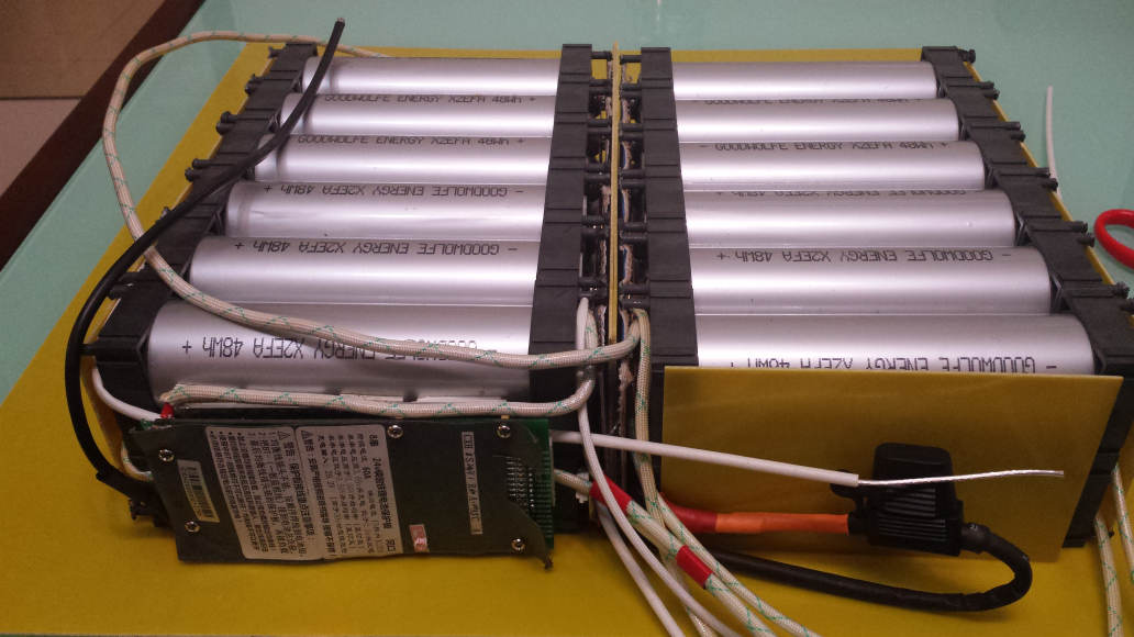

Postby expresso » 05 Nov 2016, 05:42
Ok finally redone the Pack with a 100A breaker in the Wire - i packed it a little better this time to keep dust out and cushioned both ends - its a very snug fit - wont be moving at all in there - dosnt look pretty - alot of tape around - and the wiring i did on the charge wires - ADD On etc, - on my next pack - will make those wires longer -
its very hard to connect and disconnect this pack - wiring a bit too short and being a tight area to work with - makes it much harder than it needs to be - its done - i hope this is it now - would love to never have to take it out again :) charge works - i just have to ride it around some and charge etc, - i want to make sure the balance wires etc, are good and were not stressed or pulled on when trying to connect the pack and install it -
thanks to Scollard - BM for helping me out with this breaker thing - i feel better at least now knowing i have some protection - i hope it never trips at all -
also those heavy duty lugs i got this time - they are MUCH better for crimping for sure - wire is a perfect fit for crimping but harder to add some solder in there - so had use little less solder -
it was a very solid feel after crimping - then after the soldered - done - never coming apart - i wonder for the next time - if its better to get a larger 6 AWG lugs to make it easier to solder them after crimping -

Postby expresso » 05 Nov 2016, 16:38
Burgerman wrote:It shames the stock powerchair wiring.
yeah - really does and i am new and never done this - i am sure its not the best soldering job done but its solid and wont come apart for sure - with heat shrink looks very nice - the lugs are very good - even for crimping alone i think - but since i am no expert here - i was only able to add a little solder in there - was too tight a fit - - wasnt able to pull apart before i soldered it - and after forget it :)
i be very very shocked if they ever failed that way -
would using these heavy duty lugs at 6AWG for 8 AWG wire and add a bit more solder - instead of one piece - i may be able to add 2 or 3 easy - for the future - would that be a good idea ?
these lugs are True to size and thick walled compared to the rest of the pack -

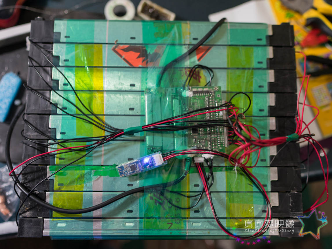

Postby shirley_hkg » 11 Nov 2016, 14:54
ADD-ON for vacation is taking shape . ;)
Postby expresso » 13 Nov 2016, 01:37
looks nice - how large is that pack ?
the BMS is that the same kind you sent me ?
Postby shirley_hkg » 14 Nov 2016, 02:39
There are 24 cells , 40152 @ 15AH . .
It will be put inside a SS box , with inside dimensions 358 X 88 X 270 H.
Same BMS but with bigger output @60A continuous .

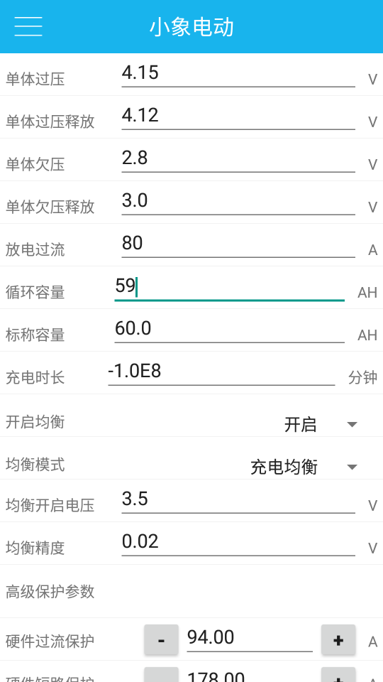

Postby shirley_hkg » 15 Nov 2016, 12:26
:D
I'm convinced that PL8 is best , especially for large pack .
It's been 40 months and these sub standard cells don't show any aging yet . They give our freedom to go as far as we want .
You get bonus too . The MK GEL are 6 years old now and still power us 5 days per charge . My last pair were 10 years old, still holding on when we parted . :D
For us out of the safety net of insurance and social security , replacing an $800 pair MK every 2 years is not subtle .
BMS is WiFi connected and parameters are adjustable through cell phone now as well as real time battery status monitoring .
CUT OFF VOLTAGE CAN BE SET BELOW 3.6V …
