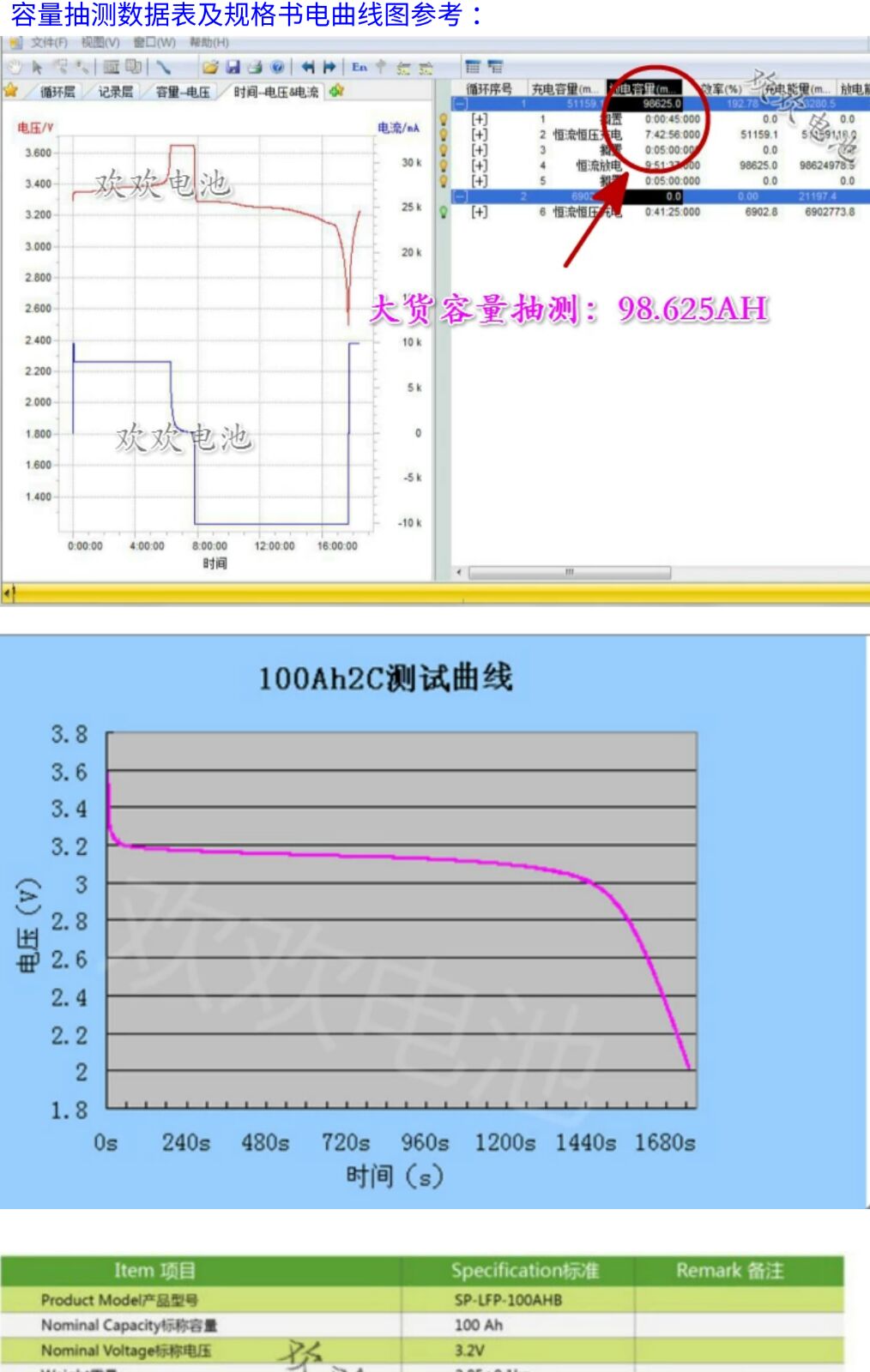

Found one similar , 100Ah rated 2C , tested @98.5Ah .
@ £25.00 ;)

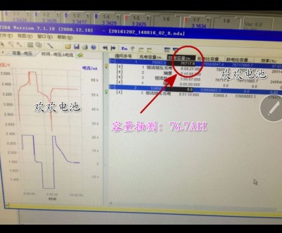

Found this too , and think you'd give it serious thought .
Look at the super low internal resistance , and tested capacity .
I'm quite confident that you can fit 16 of them in it , and that's 150Ah .
Should be good stuff . 0.36mOHM @ 2.65V That's really good , itsn 't it ?
@£17.00 :lol:

I can fit 16 of these. My box is 346mm L x 260mm W x 240mm H. Would work in either my backup chair or main chair.
For the price, 16 of those is less than a pair of MK.
Shirley do you know anything on the history of these? Are they new, used, new old stock?

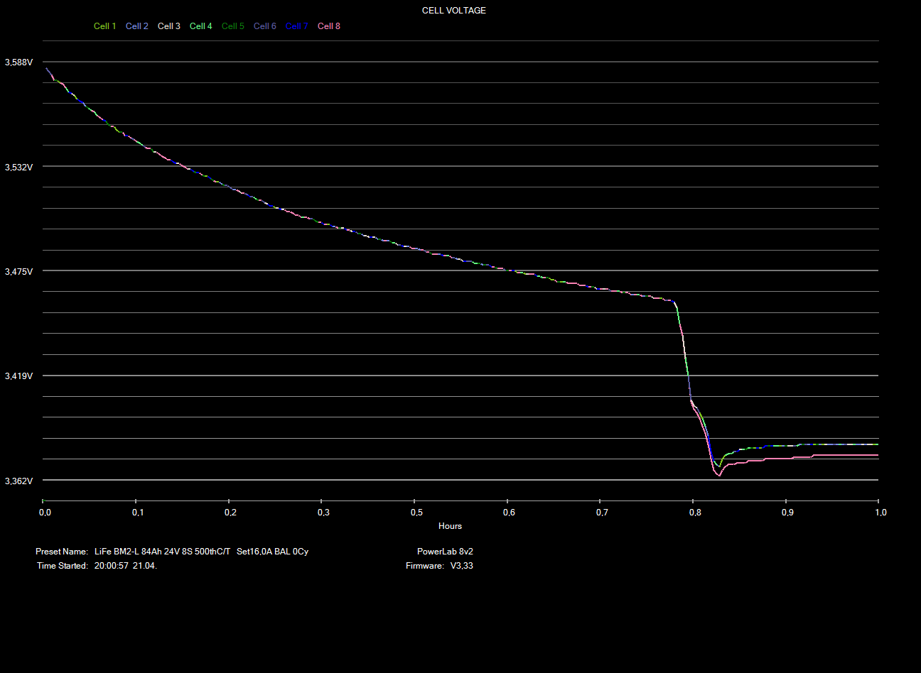

Yes its safe to use. Has it just started to happen or is it a new pack? Does the voltage of group 8 fall faster than the rest after charge, if you choose to monitor?
I built this pack in September 2016, all cells was tested, charged, discharged (same amount of Ah), settled for few weeks and charged again. Combined in groups to have same amount of self-discharge before assembled in pack.
I can't be sure that the issue isn't because of cable (it is not thin, 12AWG silicone cable from hobbyking) but I worry about soldering for example, I did my best, but I had no experience before.
I did monitor test just after charge (first 45 minutes I did nothing, then I started to move chair). On group8 voltage drops more under loading.

Postby Burgerman » 21 Apr 2017, 22:12
Only by a few mV.
Drive it for a day, then choose monitor. And lets see how it looks with half a charge.
