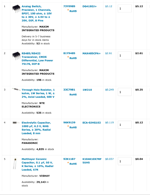

Hi, I recently picked up a Jazzy 614HD with the PMB50 and was looking to make it RC as well as keep stick drive functionality. I came across this topic and have to say wow you guys have put a ton of work into getting this working. I was originally planning to toss a sabertooth on it but after reading around this forum i think if i can build/buy one of these boards it would be the best way to go. I have a few questions though,does anyone have one already made up and functional they would be willing to sell and ship to the US? I like to tinker but time is not on my side. if not is there a detailed list with part numbers for the components needed, i have tried looking at the board diagram and am having some issues with a couple parts. here is what i have pulled out
    MAXIM DG419
    MAX485
    resistor 22k
    resistor 1k 1w
    capicator 6.3v 1000uf
    traco 2450
    2 signal diodes
    thing between 22k and dg419 ?
    Is there anything else i am missing?
i already have a few ATMEGA328 328p 5V 16MHz arduino boards laying around i was planning to use one if it would be ok
When i search for the parts there are several variations for each. For example the traco 2450 has several output versions with different watt and amp ratings. I just want to make sure i get the right stuff from the start. If it is easier i can toss all the items into a cart and screenshot it or something. like i said i am in the US but not sure the best place to buy components.
For the PCB when adding it to the cart there are several options like size which defaults to 5x5 but it the name infers 10x10 so i am assuming it needs to be changed to 10x10 but are there any other options that need to be changed?
In the video of it being used RC while sitting in it, it appears that it is connected through the XLR input on the stick is that an option or would it be best to tie it in with the lead going into the power module? I want to keep it as clean as possible but the xlr option would make it less invasive.
I see some other posts about programming the controller does anything like that need to be done? I was thinking about building up one of the dwiz adapters when i order these components but if there isnt a real reason i can hold off.
Thanks for any help you can provide.

Postby woodygb » 25 Jun 2019, 16:38
The Traco comes in many output voltage variants....the 5v Traco is the one that you want.
TSR 1-2450 | Switching Regulator,6.5-32V in,5V out 1A
Check out this thread.
viewtopic.php?f=2&t=4867&start=570

Postby woodygb » 25 Jun 2019, 16:53

Postby pungohboy » 26 Jun 2019, 16:26
Woody, thanks for the links i had somehow skipped over the schematic that allowed me to see the .1uf capacitor that i couldn't read. I have attached my potential shopping cart with what i think is all the parts except the Arduino I already have if you wouldn't mind checking over it and making sure i am not forgetting anything, or have anything wrong. I like to tinker with electronics but nowhere near the level you guys are at so when i am presented with several types of each component it worries me that i may be getting the wrong one. I was going to probably order enough to build up at least 2 but have the quantities set to what i see in the diagrams currently.
parts shopping cart
gcebiker, Thanks for the extra info. Splicing into the shark cable sounds like the best method i will go that route. I think i will hold off on any programming of the controller at the moment i really dont think i will need to go that way like you said i can trim stuff down in the remote. I was going to use my flysky GT3B TX which doesn't have Sbus, I have a Taranis X9D that does but I would rather use the pistol grip (and much cheaper) radio for when i pass it to others to use. You are right it is probably cost prohibitive to ship over here and i probably should just do it myself and make time to do it. I have a screenshot of the cart for the PCB with the 10x10 option selected but nothing else changed except color I just wanted to verify i didnt need the coatings or extra copper or anything, just like the parts I would rather order once and get the right stuff. Thanks for the tip on the external LED that sounds like a great idea. With the joystick in place would the light on it light up when powered on when it is being remote controlled, and would the joystick be active at the same time or is it if powered on by RC the joystick is inactive and vice versa?
Thanks again

Postby gcebiker » 27 Jun 2019, 00:02
Parts list looks right, only missing header pins to hold the Arduino off the components underneath.
That version of the Board also needs jumper from the 5v rail after the Cap/Traco2450 to the 5vIn of the Arduino, a switch could be soldered in or a jumper.

Postby pungohboy » 27 Jun 2019, 16:19
gcebiker wrote:Parts list looks right, only missing header pins to hold the Arduino off the components underneath.
I have header pins already, i probably have all the resistors i just wanted to verify the list before going through my parts to see what isn't needed.
