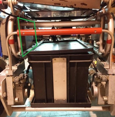

Postby nealnlx » 27 Nov 2015, 22:21
would it safe? or maybe risky?

Postby Burgerman » 27 Nov 2015, 22:51
Well terminals touching means a huge short circuit and thousands of Amps flowing. So not unless you want to get a very hot backside.

Postby nealnlx » 27 Nov 2015, 23:03
That means a two pack/rows side by side even with acrylic sheet like 3or5mm is a no no?

Postby Burgerman » 27 Nov 2015, 23:40
No that would be fine. But you don't want a short.

Postby nealnlx » 27 Nov 2015, 23:53
No way, my ass worth ten times its weight in diamonds. I got a promisse to keep so i cant burt it.
Thats a releive to know that it can be side by side.
I was all most watchin my self going backwards with half of space capacity.
With acrylic in the midle of it it will be much better
Now all i have to do is to bring back my chair and find a way to gain those 32cm width.

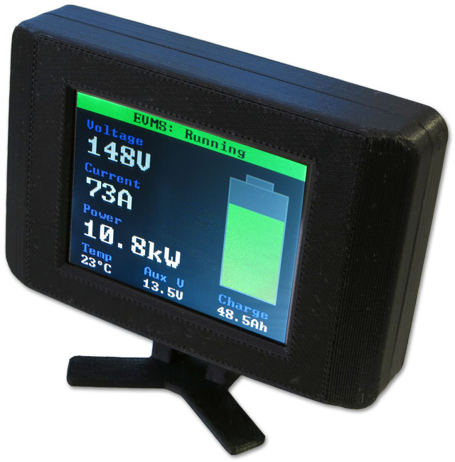

Btw, shouldnt it be the way we all should monitor our power?
http://zeva.com.au/index.php?product=119
Take a look a tell me if you know it and if it works and how good is it.
Looks simple and straight foward to me.

Postby Burgerman » 28 Nov 2015, 01:13
For LiFePO4, we recommend an undervoltage threshold of 2.8V (which results in 2.6V cutout and 3.0V re-enabling for any loads on the battery), and an overvoltage threshold of 3.6V (for 3.8V charger cutout and 3.4V re-enabling). These thresholds give about 1% hysteresis on the battery state of charge to avoid rapid cycling of the charger or outputs.
A proper charger like the hyperion (out of production) or the PL8 I am using now, charges and cell balances to much better accuracy. To 0.003mV per cell in fact. It doesent keep bouncing them to 3.8/3.4V all day while it tries to balance them.
As BMS systems go this is better than most but still intended to allow diy conversions by those that don't realise you don't need one! It only does 12S anyway I think. Most real EVs are using high voltages and probably 5x this. My battery is already too many at 13S.
Seriously most of this things job is already taken care of by you. By using adequate C rated batteries and enough capacity that the battery is barely loaded whatever you do. You can then go nowhere near its current or discharge limits where the BMS needs to "cut the power". And a controller with current limiting already prevents overcurrent, and a charger that balances cells and charges better than that BMS can, and that displays the same data and cell voltages plus graphs and history, internal resistances, of every charge on a cell by cell basis, does the rest. Its for DIYers that "know" lithium must have a BMS! Trouble is they are wrong. You only need one if you fit the wrong battery into the wrong place, or if its too small for the job.
It does lead too. You could fit one to your lead chairs. But I also don't see the point. It really is the same thing. And it STILL cant tell you the state of charge!
The only advantage that would have is that you can use a simple 2 wire charger.

Postby nealnlx » 30 Nov 2015, 20:21
LROBBINS wrote:
My chair have one box on the left side that has a on/off switch. When i try to climg on to hard curbs and it is in a bigger effort it just shuts down.
Thats when some good samaritan have to reach the on/off button and turn the power on again.
Then the joystick can be turned on and is like reseted to minimum speed. I have put it fast and furious again. Not that fast and neither furious but thats what we have...
What is that box cut off thing by the way?
Hard to know for sure without seeing it, but from the description this sounds like a circuit breaker that is cutting off all power when it senses that too much current is being drawn. It could be undersized, or it could be old and tired - especially if it's been tripped many times. If it is a circuit breaker, somewhere on it it will say how many amps it should continuously carry. It will trip after a significant delay at twice that current, and much faster the more the current exceeds its rating. If it has gotten weak, it may trip at a much lower than rated current.
If you suspect that it is tripping too easily, it is probably easier to just replace it rather than try to test it - for that you'd need a peak-hold ammeter to see what current was actually flowing just when it trips. If it is a standard type, you should be able to find a replacement at an electronics supply for a price much better than what a wheelchair dealer would charge. Even if you can't find it there, you may be able to find it online from a wheelchair parts supplier (such as Monster Scooter); they are not the cheapest source, but still better than the dealers.
Ciao,
Lenny
I dont know if its a circuit breaker or not. But from my expirence it those what i said.
Seams that mine is connected to the power module from what i can see, the pic i show below, the cable goes on its direction...
I dont even know what a circuit breaker does, but from what it sounds, looks like it works kind of like a fuse. It sees that theres is a overload somewhere (dont know where from) and switches off the eletrical circuit to avoid biger damages.
Go thing is that its resetable like turning on again so we ont have to carry fuses around where we go.
I dont know how much mine can handle. Also dont know yet how much my power module has in amps matter. But lets say that my controller is a 50amps, so it can only sucks out 50A max from the baterry at a given point, when in effort. So does it mean my circuit breaker also is 50A so that way it shut all down in a case of a overload to protect baterries to get that big puch that maybe they could not handle?
If so, it means that a circuit breaker is another protector when it come to the BMS issue.
Having this much protections such as the power module controller that only comands the entire chair to drain only untill the amount of amps it is suposed to, the circuit breaker with the same principle, a large Ah capacity and large C rate cells that have the double or more times the capacity that the circuit can drain it (remind me if im forgetting something) to prevent it to discharge so drasticly and kill the baterry, what job can a BMS do in the midle of this?
nealnlx
Posts: 41
Joined: 22 Nov 2015, 19:24
Postby LROBBINS » 30 Nov 2015, 20:35
The purpose of a circuit breaker is not to protect the battery from a heavy load, but to protect you from the fire that might break out if a + and a - wire shorted. Its rated value is usually near to the current-limit set in the controller (assuming that the controller actually is current-limited; current standard wheelchair controllers are, many hobby controllers aren't, and early-days wheelchair controllers weren't). If the controller doesn't limit current, that breaker becomes your primary protection from damaging the batteries or, more importantly, from frying the output stage of the controller itself. People do try to make a BMS substitute for current-limiting in the controller, but it's a lousy way of doing things because, just as a circuit breaker opening or a fuse popping, you just plain stop when the overload happens, while a proper controller keeps you from ever getting into an overload situation.
Ciao,
Lenny
Postby Burgerman » 30 Nov 2015, 20:36
No a 50A controller sends a Max (limited to) 50A to each motor. So 100 total. But here is the weird thing that you will struggle to understand. For technical reasons, 50A at a stalled (or slow turning) loaded up motor, may only be half of that at the battery. As you speed up, the motors get a wider pulsewidth, or if you want, a bigger voltage, so then the 50A at the motor may really be 50A at the battery. Hope that didn't hurt too much!
And the thing on your chair that cuts out, is a breaker. These are bi-metallic strip switches. A 50A one may take 100A or more for short periods without issue. But will trip at 50A continuously. They take heat over time to make them trip, or large intermittent currents. Its not there to protect the battery, but the cables, or the motors in extreme situations. Replace with either a new one, the same Amp rating, or replace with a slightly larger fuse such as 60Amp. My chairs have no breaker, only a fuse. The idea is that a fuse fails before the battery cables melt!
Posts: 71086
Postby nealnlx » 30 Nov 2015, 21:06
LROBBINS wrote:The purpose of a circuit breaker is not to protect the battery from a heavy load, but to protect you from the fire that might break out if a + and a - wire shorted. Its rated value is usually near to the current-limit set in the controller (assuming that the controller actually is current-limited; current standard wheelchair controllers are, many hobby controllers aren't, and early-days wheelchair controllers weren't). If the controller doesn't limit current, that breaker becomes your primary protection from damaging the batteries or, more importantly, from frying the output stage of the controller itself. People do try to make a BMS substitute for current-limiting in the controller, but it's a lousy way of doing things because, just as a circuit breaker opening or a fuse popping, you just plain stop when the overload happens, while a proper controller keeps you from ever getting into an overload situation.
Ciao,
Lenny
Same idea that i thought it woul do. When i said protect the baterry i mean, it and the all circuit because many things can melt and catch fire before it gets to batetty, so yes you are right and my thinkings were not for from it.
