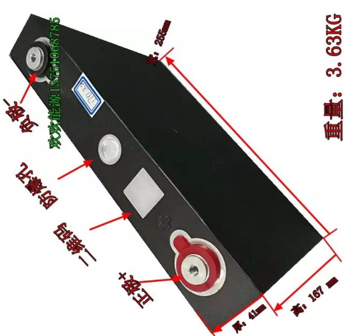

Found these good cells , and good price .. Reviews from buyers are ALL positive .
0.3mΩ rated @5C . 75Ah@£20.
May fit 16 of them in a G24 space . cheers :clap:

Postby shirley_hkg » 25 Apr 2018, 02:59
Claimed to be new old stock .
Shipping rate as mentioned previously .
Those are gone .
User's review below , has lower IR than that of the 170Ah ones .

Postby shirley_hkg » 25 Apr 2018, 03:22
Will work.
IR is higher than mine , and you can't fit 16 of them . Only 2 reviews so far .
Enough room to fit a 2P9S pack into a G24 space . Any good ? cheers drunk2 :dance
