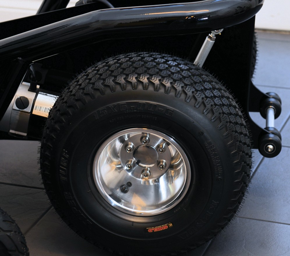

Theres no reason that powerchair tyres have to be tubed. Or weak. All of my powerchairs are using much stronger tyres. Proper roadgoing scooter tyres. Or kevlar reinforced puncture proof tyres. And they are tubeless. Just like the car.
Theres not just 2 choices.
The manufacturers only give us two... But they do not offer tough, puncture roof, or runflat tyres. They could. Its simple enough.
My Salsa for e.g uses these strong, tubeless, tyres.
Posts: 71119

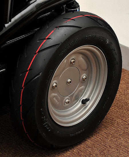

And another one of my chairs uses these:
Again tough, tubeless, and a bit bigger/stronger. The total chair width is still narrow at 25 inches.

Or these which are PUNCTURE FREE and kevlar reinforced. These run at 8PSI and are practically everlasting! But eat battery faster. So lithium...
Posts: 71119

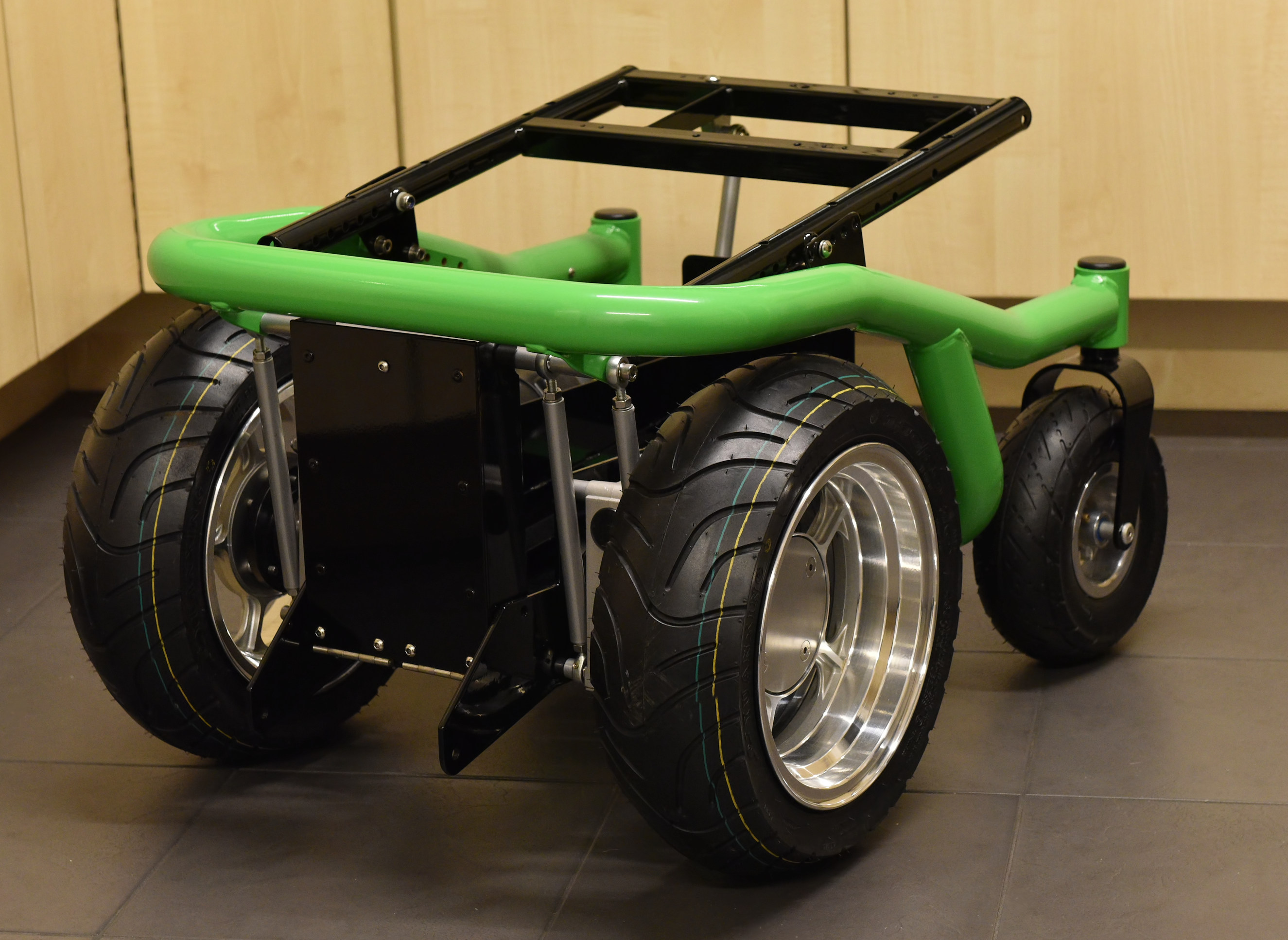

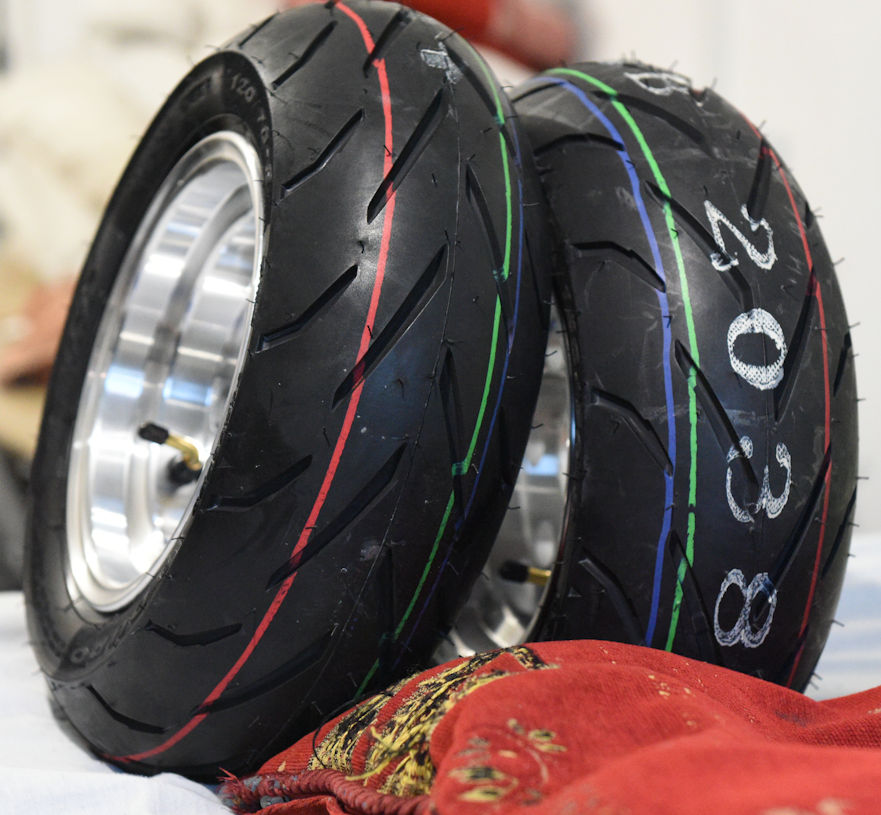

Re: Amylior R3
Postby Burgerman » 28 May 2024, 16:55
I do this because I dont like punctures and have never had one yet in a tubeless tyre. At least not that stopped me getting home. Because unlike tbes they dont expand around a nail or hole, the tyre traps the object. If it doesent the tyre sealer fixes it every time! That doesent work on tubes. AND because solid tyres hurt my spine, set off my muscle spasm.
The manufacturers could all do exactly the same as I do. Theres many many different ways. But they dont. Because no proper competitive market exists in this area. They DO use them now on some scooters. Because people are buying those with their own cash. And the manufactyrers want that cash!
Heres another tough TUBELESS tyre. ALL of these are on different but TUBELESS rims.
Posts: 71119
