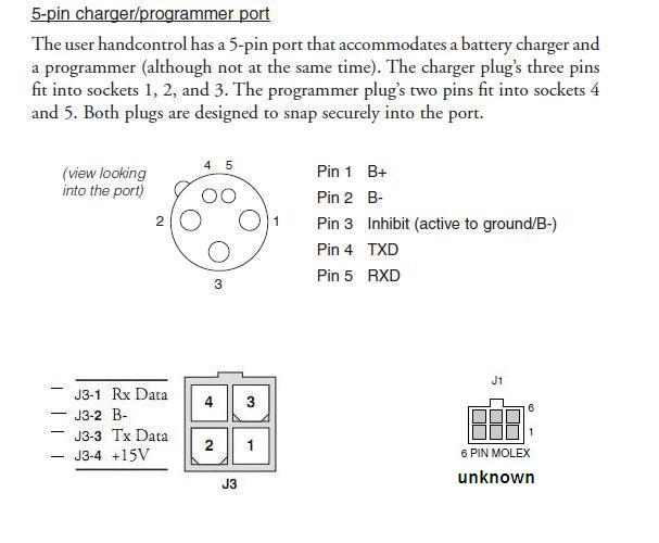

The power module needs a 6 pin , this 4 pin?

Postby woodygb » 13 Jul 2011, 21:17
I'm not familiar with the Enable 40.... everything I've programmed has used the 4 pin molex.
Here's what I can find...communication and programming is via the RX and TX ..

It would seem that you really should get the genuine Curtis CAN/RS232 cable / interface for the Enable controller...this might prove difficult/impossible/expensive.

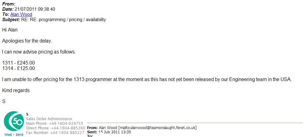

I contacted Curtis UK last week and used my ownership/use of the 1307 as a means of legitimising my enquiry ...firstly via the technical helpdesk.
I have a 1307 programmer that I've been mainly using on mobility scooter controllers..it's been superseded by the 1311 or the 1314 PC Programming station.
So my question is can the 1307 still "talk" to the new generation controllers like the Enable 40 or is there an add on option that will allow it to?
I doubt that my usage justifies the cost of either new option...I would however appreciate a rough price guide for the various new options
the reply was ..
Hi Mr. Wood,
The 1307 can still be used for the older controllers. It can not be used with the later controllers. There is no add-on so a 1311 will be required or you could wait a few weeks and have the very latest unit, the 1313.
Hope this helps.
I then forwarded the conversation together with the price enquiry to sales.
I've just had a "word" with A C...per ..see attached...
I wondered if you could be so kind as to give me a price for..
1311 hand held
1314 PC programming station .. software and cables
The "NEW" 1313 hand held.
Best Regards
Alan Wood
I finally got the following email.
