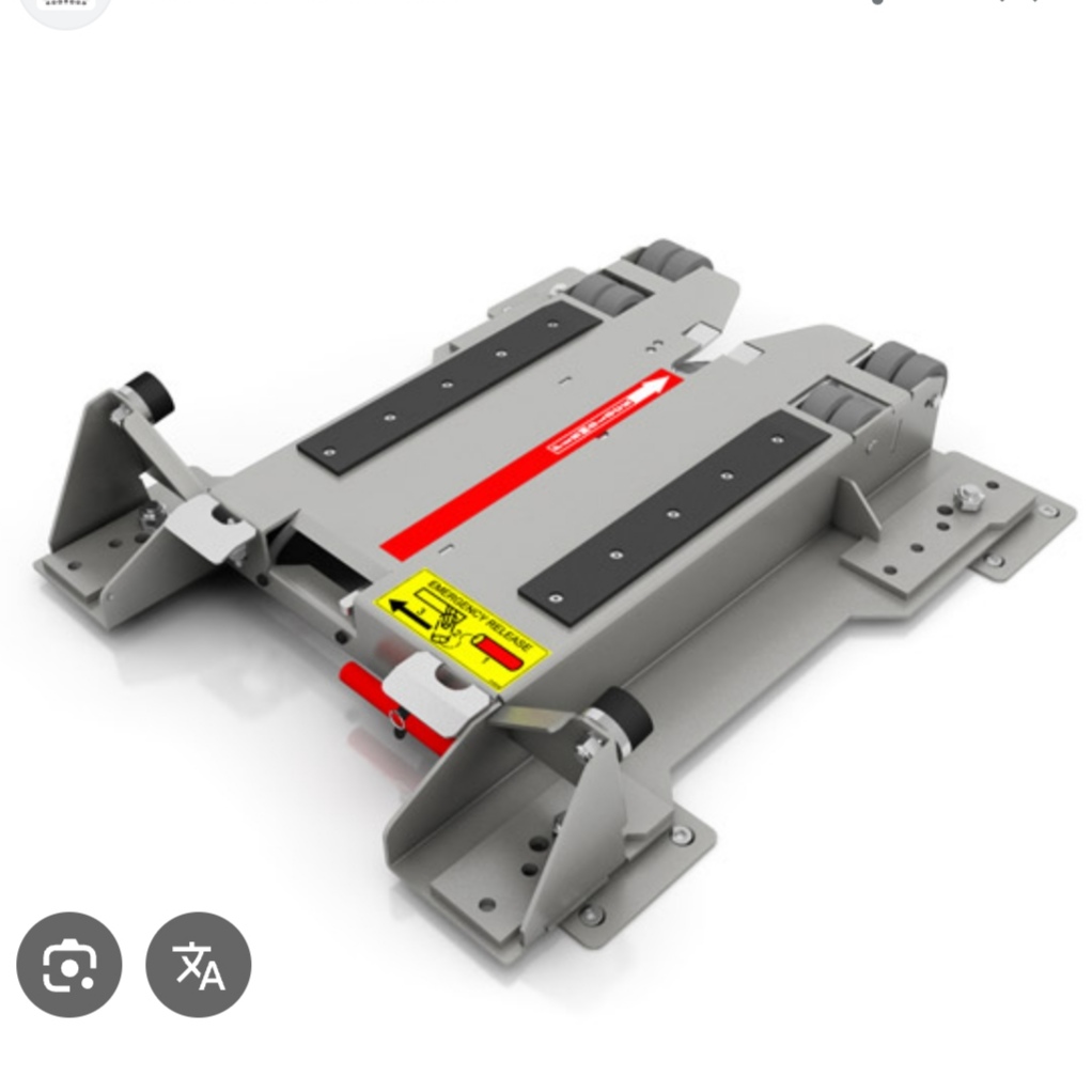

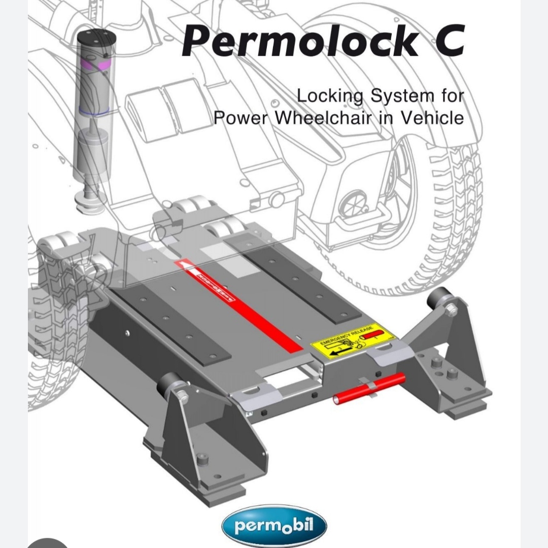

Does anyone here have a permolock c installed and use a permobil F5 corpus VS chair? I ask because I don't know if they are compatible.

I think an F5 would require the Permolock C3 with 2 pins rather than the single center pin. https://www.motusmedical.co.uk/wp-conte ... ock_C3.jpg

Surely it is as you say slomobile, the permolock c must be for older chairs

Unfortunately, Permobil disconnected their locks several years ago. Any of their newer chairs will not be compatible.
