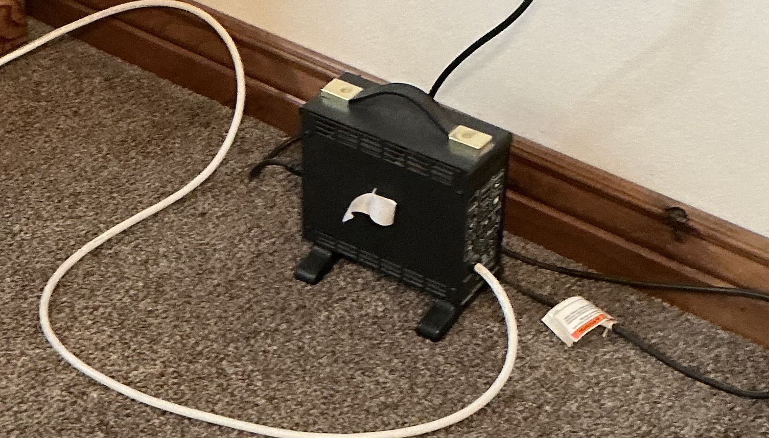

There are no settings on my charger. I just plug it in and that’s all. Below is a picture of my charger. Does it charge with a float like you describe and it won’t overcharge the batteries? Thanks.

Those things do all kinds of things. Never tested 2 that did the same thing. Every one was abysmal, innacurate and over voltaed and undercharged. Then they generally go to a too high 13.8V (27.6v) float.
If I used one of those and I wouldnt, I would charge a nominally full battery for 8 hours. And hope for the best... Every 2 weeks.

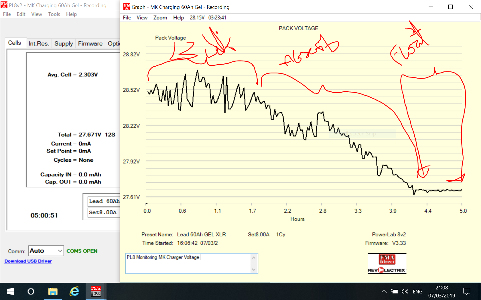

Heres a wildly spiky graph, that was MONITORED by the PL8 hobby charger, so we could see what one of those chargers actuually does. And I still am not sure!
By a user on here.
This one was supplied by invacare.

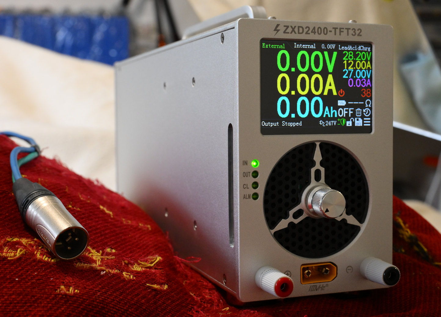

If you REALLY care about chargng properly are willing to learn and spend a little you need one of these...
But for just charging lead its a bit overkill
With this you get complete control. It can be a 2 stage charger, a power supply, a 3 stage charger, lithium and lead, and from 0V to 70V and 0 Amps to 50A. It can be used to test motors, electroplating, charging, or a general high powered bench supply.
Its a long way beyond what you would need. And not much difference in price...

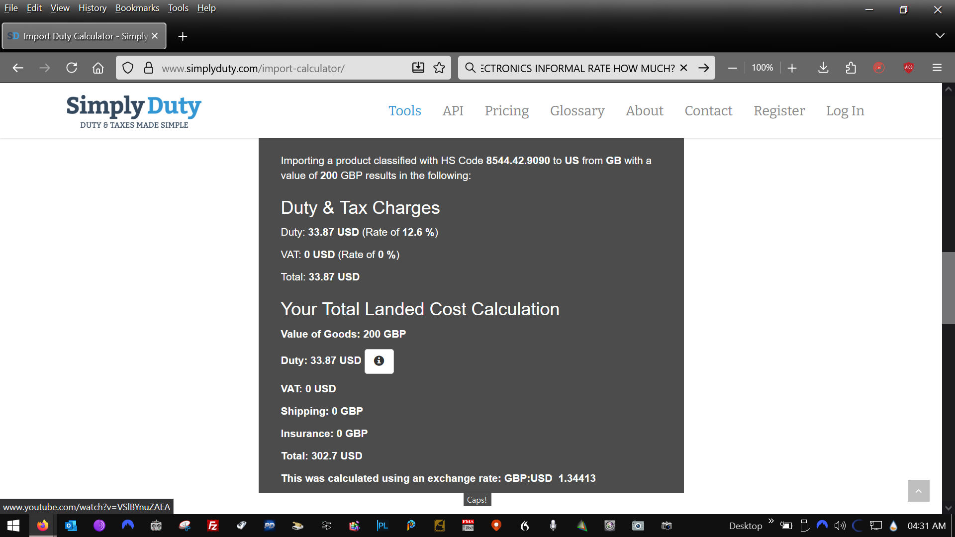

Taxes and tarrifs from the UK to the US are 12.6%.

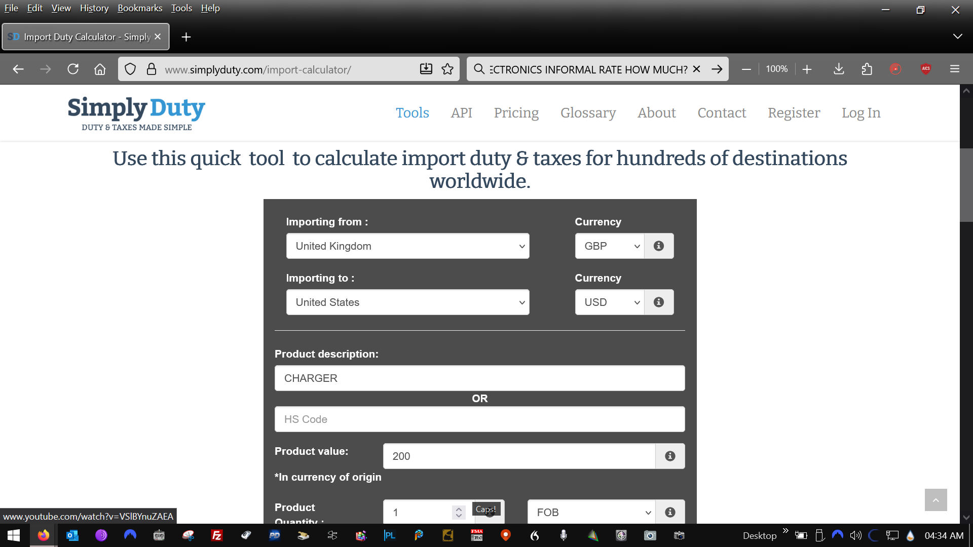

This calculator below allows you to enter CHARGER and its value (at which point you can be less than truthful!) and I put £200 uk pounds.
Which is about £200 is $269 dollars at todays rate. Total is $33 dollars tax/tarrif/duty. $303.00
You can also add your sending country and any receiving country. So I put UK to US. Theres no tarrifs or taxes on any shipping costs.
So its really pretty cheap. Maybe less than it was pre trade deal even with tarriffs added.
At least from Great Britain. Less than our VAT for e.g.

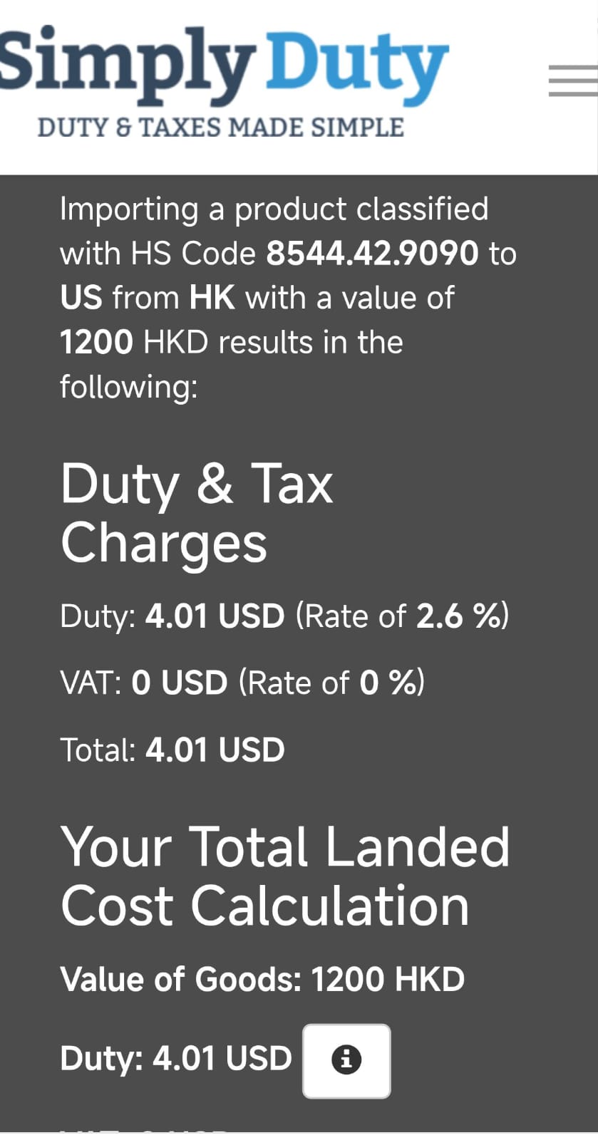

Postby shirley_hkg » 03 Oct 2025, 05:08
I'm surprised that he treats us so kind.
Posts: 4657
Re: Maintaining batteries on old chair
Postby Burgerman » 03 Oct 2025, 05:20
Its a deal or no deal thing!
HK is not China... Well not really, it was British.

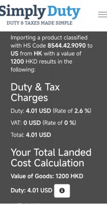

But its not 4 dollars its 8. Because your 1200 HK is about half the £200 UK value I used? (I think???) Still cheaper than here, just!
