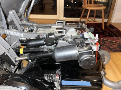

Postby jefferso » 02 Aug 2025, 12:51

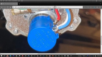

Thanks. I couldn't find a microswitch other than the main one in the middle under the seat under the big plastic plate (which was removed long ago due to the switch being activated when it shouldn't).
The chair will drive now when one of the plugs to the standing actuator is unplugged (with red, white and blue wires), but of course it won't change position then. With the cover off I can see where the wires go, but not sure how that part works.
Someone said the 2G VS has a metering rod next to the actuator to get position feedback, so maybe something in that small round blue device needs to be replaced.

Postby Burgerman » 03 Aug 2025, 00:12
Permobils have twice as many wires as other chairs. So no idea what the blue thing is or what it connects to. But you may be right.
Take apart and see what it is/does. Might be obvious then.

Postby DSmidgit » 06 Aug 2025, 13:59
That blue thing is a potentiometer. It is used to measure the length of the actuator. If that isn't working correctly it could be giving errors. I have not seen one of these that where faulty but I don't have a permobil.

Postby Burgerman » 06 Aug 2025, 19:07
I am not sure that it is.
The wires are in the wrong place, should be radially positioned on a pot. And its too deep. And the size of those wires is the same as the current carrying ones to the motor. And a pot normally has say 10k or 500k written on it too. That soldering is abysmal. Well not the fact that its soldered badly but it should have heat shrink.
Its obviously doing something. Maybe a type of microswitch, or something. Take it apart! Only way to know.

Postby Burgerman » 06 Aug 2025, 19:12
You may be right! I found this after a lot of searching!
$3
https://www.walmart.com/ip/10K-Ohm-Rota ... /771634533
Measure its resistance after desoldering it and order a new one.
There will be lots of values. Measure whats there. Order and replace. Or get one from permobil $500.99.
Measure yours between terminal 1 and 3 -- the two closest to the actuator. It will be close to 1, 5 10k or something. You dont HAVE to use the same blue one, as long as it physically fits any similar value pot should work.

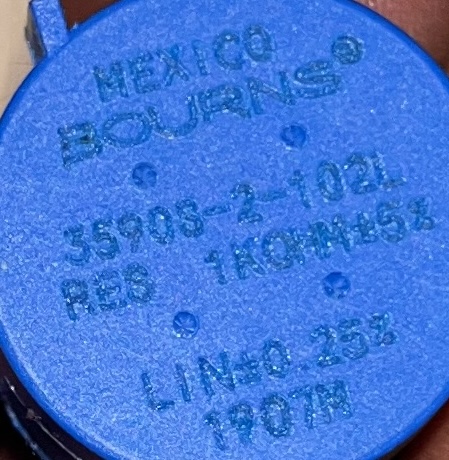

Postby jefferso » 03 Oct 2025, 20:32
I ordered a 1k
MEXICO
BOURNS
3590S-2-102L
RES 1KOHM+/-5%
LIN+0.25%
1907M

We tried to set the turns to the same place (almost all the way open when in standing position). Put everything back together again, soldered the blue white and red wires back on and nothing has changed. Still has the same symptoms. If the standing actuator is unplugged the chair will move. If it's plugged in, it will stand, and it will move while standing, but about 25% down from standing, the first light on the ICS buttons turns red and it will no longer move. And the joystick only goes between M1 and recline.
Inside the actuator. Photo missing the creme coloured gear wheel which sits next to the black gear wheel.
I was able to use the Permobil "Take me down" mode (press and hold buttons 2 and 6 while off, turn on and hold for 30 seconds until all lights red) to get the chair to lower from the partly elevated mode which is at the end of the lower of the standing mode.
Take me down mode works to elevate or lower (very slowly) when the standing actuator is unplugged, so the chair can currently be used as a backup if someone is around to plug or unplug if I need to stand.

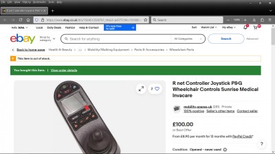

On top of all that, it was also giving a JSM Bad Cable 7F00 error on its ancient R-NET monochrome joystick. I had gotten a new cable for it some time ago, along with some replacement buttons, and finally got around to replacing them. So at least I don't get that error on the joystick any more.
jefferso
Posts: 347
Joined: 18 Jun 2016, 22:18
Re: C500 standing actuator maybe
Postby Burgerman » Yesterday, 18:22

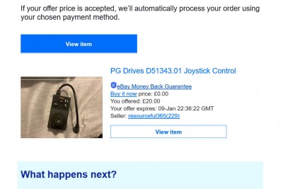

Modern version colour. Upgrade it! Plug and play.
I offered £80 and it was accepted.
I waited many months. Nothing. Then many of these appeared and were sold for anything between 70 and 100 brand new. For maybe 6 months. Now nothing again. This stuff happens in waves. Watch and be very patient. I call it fishing ebay. Never offer full price unless someone doesn’t know what they have and sells at a silly price. I bought a 120A power module, 2 bus cables, and a ISM6L actuator module for £50 and I clicked buy now asap. Search for stupid descriptions not what it really is too.
Same with CJSM2, and the smaller LED ones. Those sold for £50 and loads of them. All these are sold as "opened unused" and still have original plastic screen protectors etc. They come in a plain box. No idea why, how or when...
Brand new.
