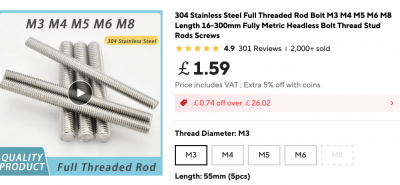

I use two lengths of M3 threaded rod which I pass through connectors through two holes drilled in seat base and clamp connector to underside of seat.
I use threaded bar cos can’t buy long enough M3 bolt.

How long?
50 and 70mm are easy to find.
Posts: 71113
Re: D-SUB 13W6 Pin Connection Wiring Diagram?
Postby Scooterman » 13 Aug 2025, 09:59
They'd have probably been long enough. I ended up buying some short lengths of M3 threaded rod from Aliexpress.
