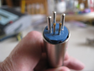

Postby Seajays » 18 Mar 2012, 21:27
This is my programming cable end that I made to try to make the Woody programming cable for my Q Logic Quantum Q 6000 .

Nice one ...any chance of some exact dimensions for the pins and their positions?
Re: Q logic/Curtis Cable end
Postby Seajays » 19 Mar 2012, 00:52
Woody, The best I can do is the Spring pins a 25 mm x 0.053. The holes are 4 mm OC apart and 8 mm up from the centre of the bottom pin. The spring end sticks out 9 mm Very hard to get an more accurate measure. The spring end of the pin is a smaller diameter so there is some play there. I used a 0.051 drill and some Crazy Glue. Hope I can get the cable stuff mastered. Might be back to you with some questions.

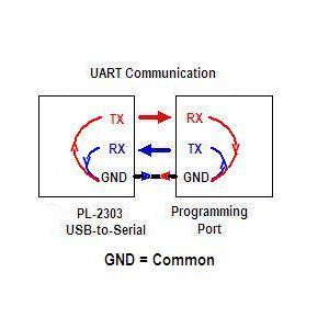

Postby woodygb » 20 Mar 2012, 11:50
This revised and clearer? ...pic may help.
LED's are NOT required ...they just show that a signal is flowing...so they aren't in this pic.
Things are GREATLY simplified.. IMO ... IF you can reconnect the 5v in the USB plug and use that as the 5v power supply for the 7404 chip.
NOTE:- ANY two A - Y "pairs" of chip input/outputs can be used.

Woody, Good drawing. Do I need to install the Disk Driver that came with the cable?

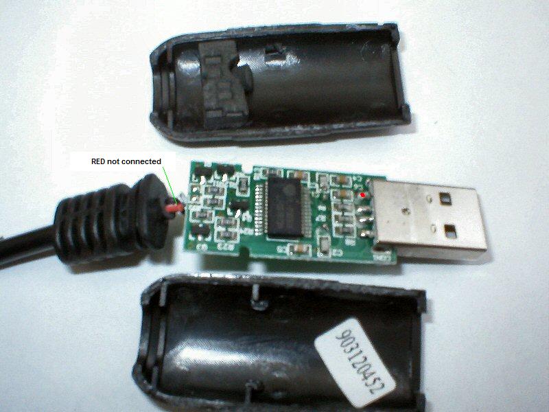

Postby woodygb » 20 Mar 2012, 15:12
The red wire is present in the lead ...but chopped short inside the USB plug.
I popped open the casing ... cut into the rubber retaining wedge and added in a small length of wire to attach the existing wire to the 5v USB pad.

Postby woodygb » 20 Mar 2012, 21:27
Seajays wrote:Correct now added green and put Red to power.... Bottom row is Programming Port right? Can I connect the BLK from the USB to the same place as Pin 2?
OK.... All wire colours match my pic?
If so then the ... USB - Black ... Pin 2 ( chairs negative ) and Chips GND are all joined together as a COMMON wire.

Postby woodygb » 20 Mar 2012, 22:03
This is perhaps even clearer.
ALL grounds ( GND ) joined and become the COMMON wire of the circuit

Postby woodygb » 20 Mar 2012, 22:49
Common or GND ( Ground ) is normally the negative of a circuit...it is the wire that ALL signals/voltage travel through.
