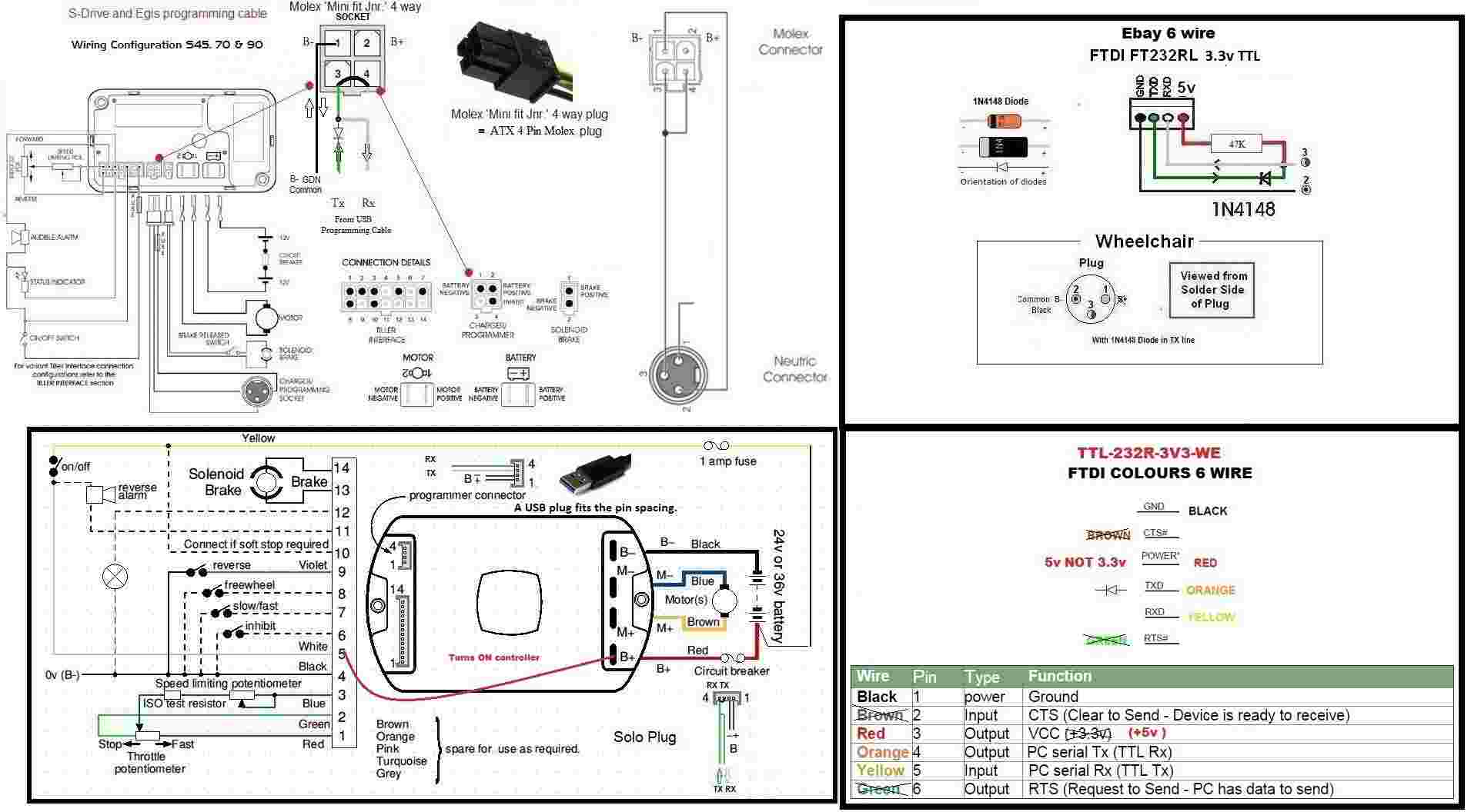

Postby nSRaiden » 09 Feb 2018, 14:03
woodygb wrote:Sadly I cannot help any further other than recommending a specific FTDI lead.
TTL-232R-3V3-WE
download/file.php?id=7152&mode=view
viewtopic.php?f=2&t=2111&start=1040#p109600
thanks i go buy this and cross my fingers thanks for your help

Postby nSRaiden » 29 Mar 2018, 21:50
TTL-232R-3V3-WE
have puchased the cable but the programmer software stay Innactive i'm waiting for my new battery i'm going to try with 24v i think it's the last issue i can have with this controller if this not work any of member of your community have a clue about hacking the pwm controller with an arduino?
nSRaiden
Posts: 14
Joined: 23 Jan 2018, 16:45
Postby woodygb » 29 Mar 2018, 21:59
Have you looked in Windows Device manager.?
Has the FTDI driver installed correctly?.
Did you know that the COM Port number assigned by Windows to the lead MUST be between 1 & 8 inclusive as the programming software will ONLY work with those COM Port numbers.
Did YOU tell the software which COM Port number to use? ... the software will not find it for you.
Posts: 5911
Postby nSRaiden » 30 Mar 2018, 00:02
yes for all no error in driver manager i have try 1- 8 as com and selected the port in the program with no result just stay innactive
nSRaiden
Posts: 14
Postby nSRaiden » 30 Mar 2018, 02:21
got it just opened the controller and solder wire inside and magic it's active
nSRaiden
Posts: 14
Postby Digipro » 11 Apr 2018, 13:35
Hi nSRaiden when u say u had to open your controller and solder a wire, what do I mean by this ?
I am having trouble with connecting to my s drive 200a as it does not seem to connect to the controller although the software recognises the cable and tries to send data.
would be good to know what you ment by soldering a wire in the controller.
steve
