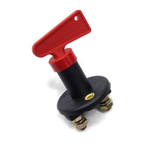

In my hobby of robots ( Battlebot / Robotwars ) we use an Anderson connector with a loop of wire linking both connections... this plugs into another unlinked Anderson on one of the battery lines....simply unplug the link to kill everything.
You could purchase a battery immoboliser switch ( manual kill ) or a solid state relay for use with a R/C kill switch http://www.jaycarelectronics.co.uk/prod ... &SUBCATID=

Postby thecleancompany » 01 Sep 2012, 22:18
Hey Woody,
Great suggestions I will get out tomorrow and purchase a the large kill switch like the one pictured. Thanks for the link too.
