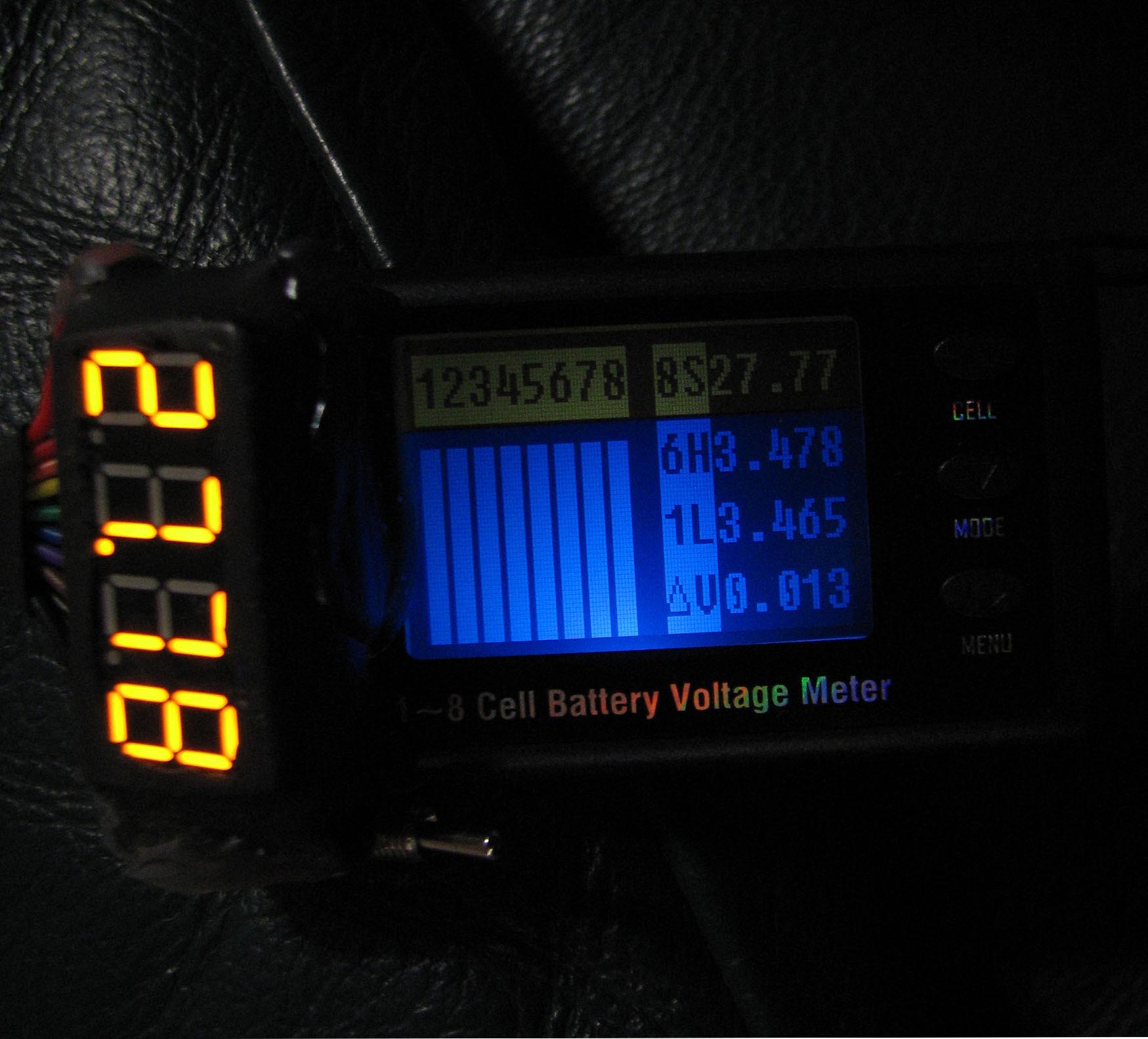

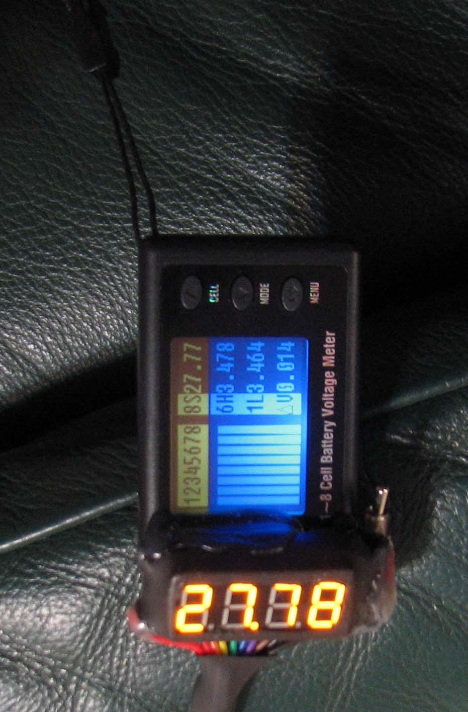

I'm using this / clone Celog8 to alert me if a cell is 2.8V low. BMS is for charging only.
However, it runs on the power of the first 2 cells; 0V -- 6.6V ONLY ; and it eats up an extra 1.5 Ah of that particular 2 cells in 10 days. :o That means you can't turn it on 7/24.
I turn it on when it gets 25.5V or lower , or when necessary. Put a switch in the 0V path SO YOU CAN SWITCH IT ON / OFF. :D
Endless-sphere has thread on how to even the power drain on all cells connected. :D

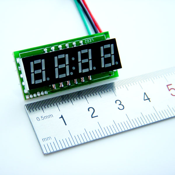

I purchased a second monitor and am going to unsolder the 7 segment LED displays and replace with sockets so I can plug/unplug the displays.
I'll then set it up for the voltage I want the alarm to go off at, then remove the 7 segment LED displays.
As most of the current is likely to be used by the LEDs, removing them should massively reduce the power used and the alarm should still work OK.
... a bit OTT ...the leds will draw VERY LITTLE... mA'S
http://www.kpsec.freeuk.com/components/led.htm
Re: LOW VOLTAGE ALARM
Postby g7pvs » 28 Jan 2013, 13:03
1.5Ah over 10 days = 0.15Ah per day = 6.25mA per hour or 6.25mA current drawn.
So although only mA over time it does make a difference.
The only other component drawing current on the PCB is the microcontroller which should be uA.

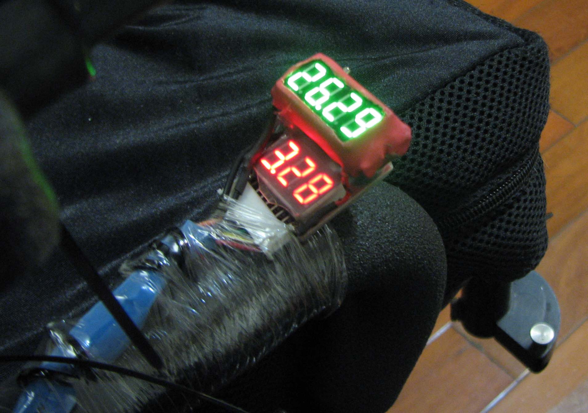

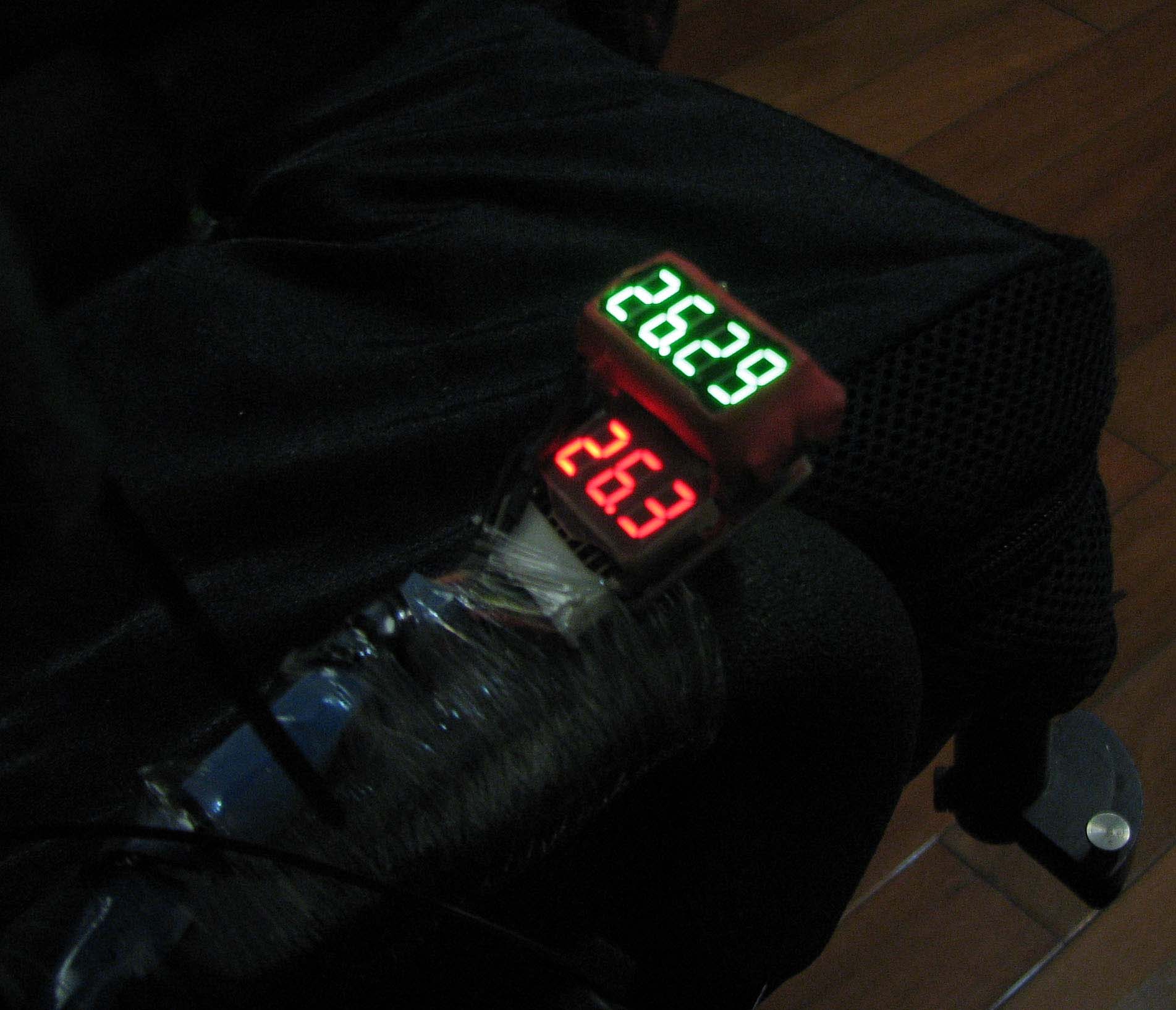

I have this small LCD voltmetre to read the battery volt all the time and turn on the 8-cells voltage monitor at 25.5V or when necessary !
LCD runs on the battery which it measures thought it's best to feed it with 5V. It sells @ $2.00 US
Postby shirley_hkg » 12 Feb 2013, 15:02
HAVE IT ON MY BACKUP CHAIR. :D
