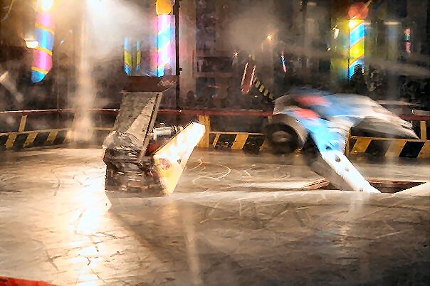

Postby Burgerman » 11 Jan 2014, 17:27
You still do robotwars?
Do you have a photo of the bot?
Why is it not televised now?
Posts: 69911
Re: Plug & Play PGDT R/C
Postby woodygb » 11 Jan 2014, 18:13
Recent rebuild/reshape. Image
http://www.youtube.com/watch?v=n6HND87KrGk
Video of first outing with new shape at Maidstone in Oct 2013...PLEASE NOTE THAT I DON'T DRIVE ... my Team mate does that...
but in his defence the gyro was dead ..... Ka_Pow! has the roll over "tombstone" on the back and the RED X that shows the panel covering the Link and Gas tap.
https://www.facebook.com/groups/robotwars/
http://www.roamingrobots.co.uk/
http://www.robotslive.co.uk/
Jonno ...the owner of Roaming Robots ..is constantly trying to get production companies interested in putting Robot Wars back on T.V....last year he obtained the rights to use the Robot Wars name and logo for his show and I believe that he now has some interested parties.
I assume it originally died due to production costs versus viewing figures .
