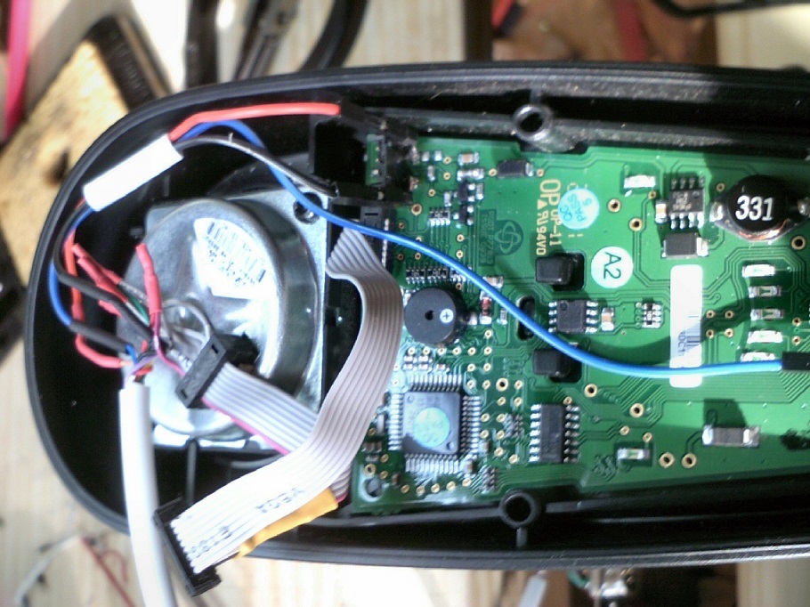

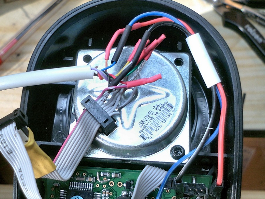

Mous3 kindly sent me a complete VR2 system from her old chair "Davros" to see if I could make a simple..ish R/C interface to plug into the joystick pod.
I now have a working prototype for her to try out and will be posting everything back after this weekend.
Here's the setup inside the joystick pod.

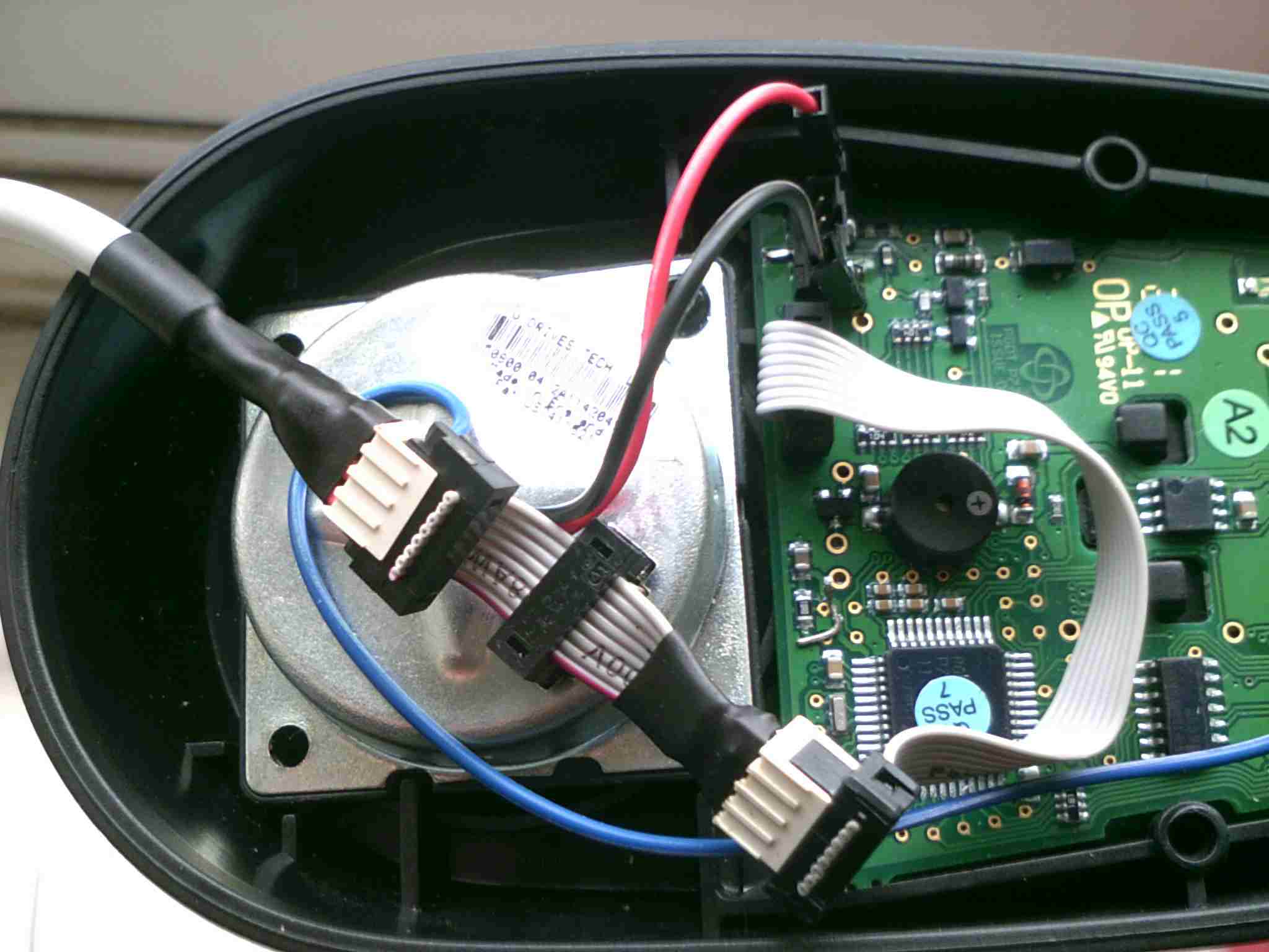

Postby woodygb » 18 Apr 2014, 20:34
A few more pics.

Re: R/C - VR2 Joystick interface
Postby ex-Gooserider » 22 Apr 2014, 07:53
Hmm.... Probably OK electrically, but my aesthetic sense is going "Seriously Ugly...." (sorry...)
As a suggestion, I think the ribbon cable and the IDC connectors that go on it are commodity items that should be available from your favorite supply houses for reasonably short money, even in small quantities...
I would be inclined to make a custom cable with three plugs on it, and a connector with the wiring to the interface that plugged into the 3rd connector - seems like it would be neater...

Aesthetics hardly seem to matter as it's hidden inside the pod.

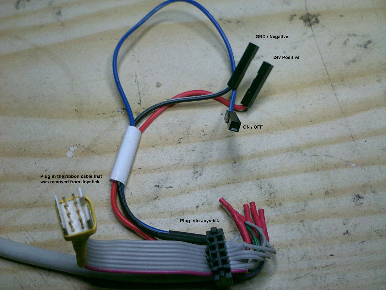

Postby woodygb » 22 Apr 2014, 09:14
I could however put a female socket where the messy multiple connections are.... and solder a male plug to the interface lead.
Postby woodygb » 22 Apr 2014, 17:12
woodygb wrote:I could however put a female socket where the messy multiple connections are.... and solder a male plug to the interface lead.
Better?
002 aa.jpg (120.99 KiB) Viewed 8704 times
download/file.php?id=2932
Postby ex-Gooserider » 29 Apr 2014, 09:30
Yes, looks MUCH neater / professional...

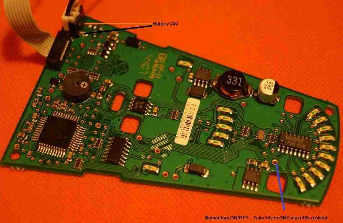

The VR2 interface is very similar to the Omni version .
With the VR2 version I use 2 extra pins on the Arduino's board for reading the pods joystick output and a fair bit more code to integrate the signals ... check for failsafe conditions ...and give the joystick priority.
The VR2 interface.. as is ....also works happily on the VSI pod.... I will however be making one very minor wiring mod for the VSI ribbon connector.

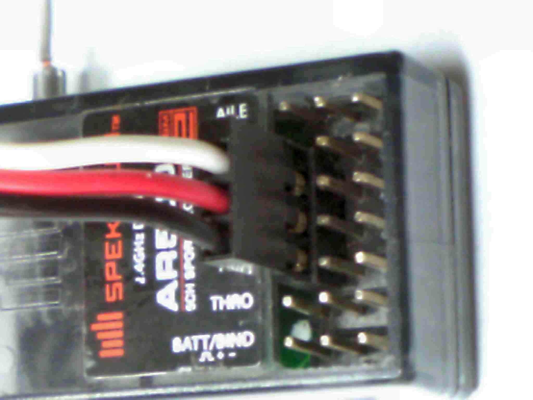

Postby mous3 » 02 May 2014, 14:48
Burgerman wrote:I think all servos and plugs are pretty much the same and universal. And she is using spectrum anyway now I thought...
Correct and no It's the receiver that differs as not all the pins are in one big block they are in nice enclosed 3 and 5 pin groups one plug one socket hole shrouded by the casing then offset next socket hole so my 12ch has 3 rows off 4 individual 3 and 5 pin sockets and then 2 battery input sockets and the telemetry port totals 16 servo outputs 12 control inputs before mixing.
And all I need is 3ch lol
mous3
Posts: 255
Joined: 23 Jan 2014, 11:05
Postby woodygb » 02 May 2014, 14:50
The lights will always flash if the interface isn't getting a R/C signal ..they indicate a failsafe condition.
The interface is working on and SUPPLYING 5v ..in fact it's just under 5v ...something like 4.85v.
Take care if you use a separate power source for your receiver .... DISCONNECT THE RED POWER WIRE TO THE INTERFACE ...but leave the Black ground / negative in place.

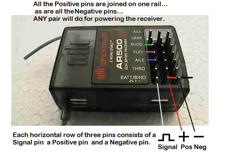

Postby woodygb » 02 May 2014, 15:07
Just to try and make the Receiver connections clear.
You have one STD servo lead BUT that is being used for 3 separate signal wires .
PLUS one servo lead with Red and Black that equals POWER /Bat .
The colours used in the pic for the RUDD, ELE , AILE signal wires are purely for clarity and not the same as the servo wires ...
So ..on the servo lead with 3 wires you have WHITE = RUDDER ... RED = ELE and BLACK = AILE ... ONLY ONE wire for each signal channel is required.
Postby mous3 » 02 May 2014, 16:57
Thanks I have the signal inputs plugged in and correctly linked up. I just had to take the plastic plug off and connect the individual wires to the signal pins on the Rx I am recharging a 6v pack but it will be an over night job.
So onward with a cheap 6ch no fail safe 4-6v Rx. The board is happy did everything it should and the chair drives so for multiplex EVO systems bind Rx and Tx set to mode 2, assign model name no flight phases and servos to1, Al 2, El 3, Ru without any mix option and reverse the Al input only! make sure you are using a 4.8v receiver set every thing ells as pdf then re-assign 3 to L.gear on a controls witch, change mode to1, 3 or 4 if you want to drive on outher sticks if you a nuts.
:shock: then :?: then :idea: then 8-)
So I need a way to give 6v + to the ipd receivers or find a 4v one It's somewhere
Postby Burgerman » 02 May 2014, 17:10
That was all Chinese.
Any receivers I ever have had (old style stuff, JR, Futaba, Sanwa (crap) etc were designed for a 4 cell battery originally so 3 to 6 volts works fine. Spektrum for e.g. works from 3v to about 10 or so.
And on all receivers, all the plus +, all the ground -, are connected together. Only the signal pins are separate. A servo for eg just needs a power supply, and a signal. Everything is interchangeable.
Woodys interface needs ANY steering, and any forwards/reverse channel. That means elev/rudder. elev/aileron, etc. And a ON/OFF channel. Woody used rudder for this since almost every set has a rudder channel... I use a gear switch.
I also disabled all trims, and all other channels.
