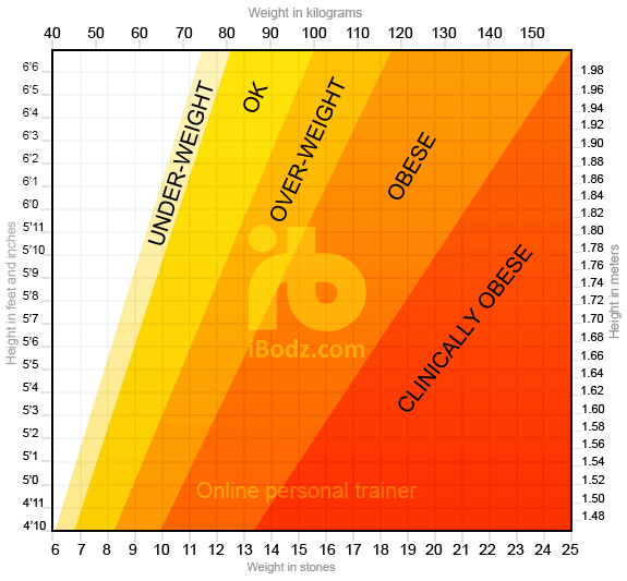

However, I am still a little overweight on some charts. (5' 9" n 12 stone) But I do 'scrape' in on this one;

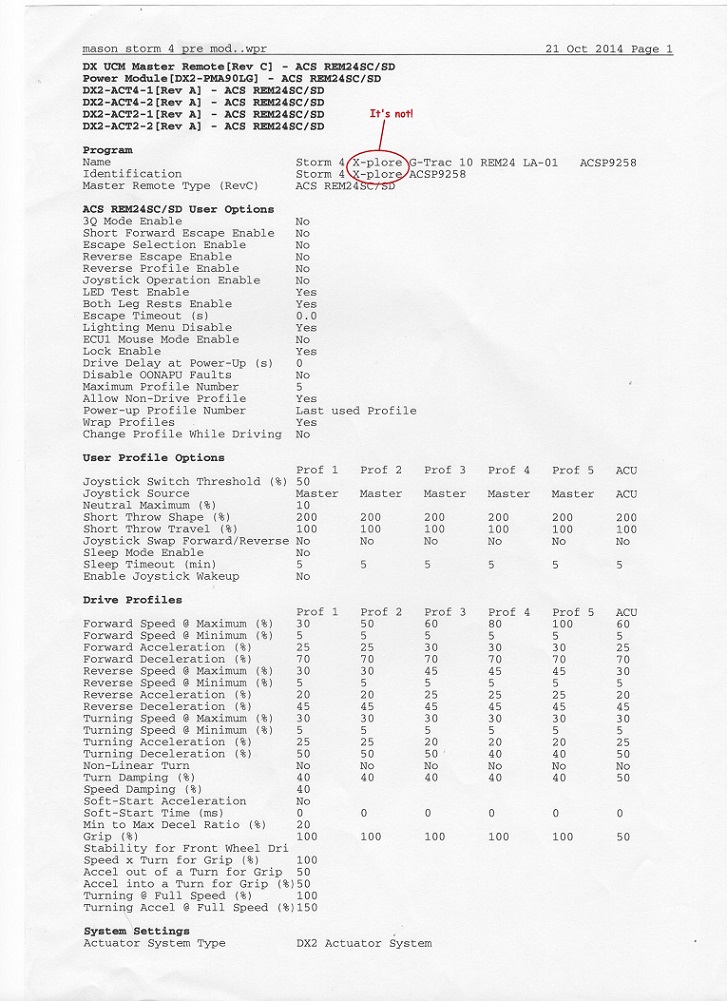

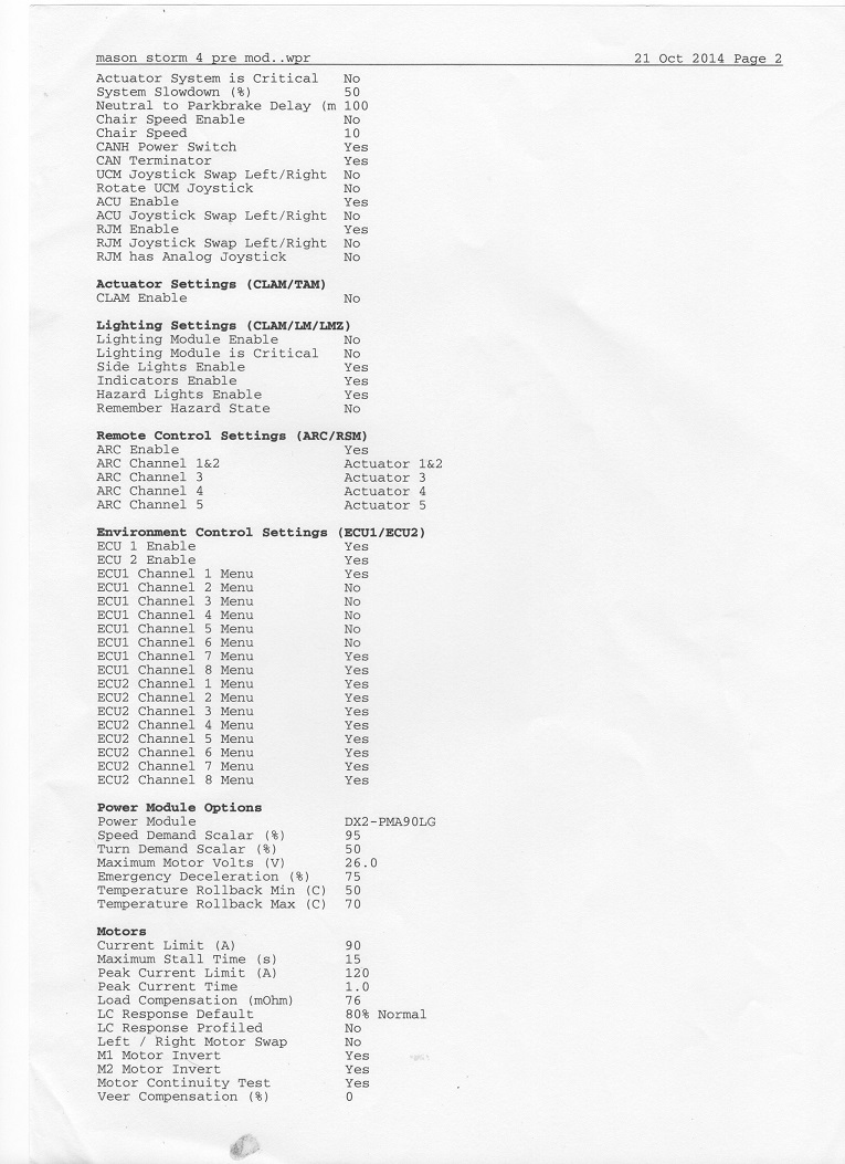

so I have attached the list of chair settings to the next reply. Perhaps u could peruse them and make any recommendations where necessary;
(I am sure the current wheelchair engineers can make the adjustments.)
I am 12 stone.
I have minimal but steady use of my hand.
It is quite hilly round here.
So it is a lwb chair.
I am happy with the acceleration/de-acceleration.
I am also happy with the joystick 'throw.'
DON'T FORGET I find the current set up very precise and responsive.

I would change almost all of the drive profile settings.
Everything is set to super delayed... And stock, and the same as all powerchairs I ever saw or tested. So trust me when I say it doesn't steer or is barely controllable.
The chairs I have played in were 2011 and 2012 and a few quite recently. I couldn't see or tell any difference whatsoever. They are all identical under the skin bar a bit of trim... I will mention a few obvious programming issues...
Turn acceleration (Yours 25) That is un-drivable to me and most others. Most chairs are set to 25 or 40. 40 is better but still abysmal and dangerous unless you have the patience of an old lady and go very carefully. Its super smooth, but begins to turn afterwards when it wants, not when you tell it, then speeds the turn up and does long after you wanted it to. It means you slam the stick fully left or right to make a correction and it gradually starts to accelerate into a turn over about 2 seconds period... The turn RATE increases as you wait. Yawn. Instant small accurate corrections are impossible. So you are heading for a door frame at speed, and no fast correction is possible. So in the panic at the lack of affect a few mm of stick had, you give it some more... Now the first bit starts to take affect (late) followed by the extra stick you also added in panic as nothing was happening... And the chair turns too much, too late. And then you cant STOP it turning because of:
Turn deceleration... This is a delay is STOPPING the turn. Once its going left nothing you do stops that. So you have turned too far due to the above, and so slam the stick the opposite way in panic. But it has no affect as decelaration delay makes sure that it cannot! So you now hit the opposite door frame to the first one you were scared of. This is followed by the chair lurching at the opposite side about 1 second later and you guessed it, you cant stop that either. Yours is set to 40. Also totally un-drivable - and worse than turn delay. You simply cannot drive in the sort of spirited accurate fashion that many want. It makes it plain dangerous unless you go slow.
My turn acceleration is set to 100. So it turns WHEN I say so. And by the amount I push the stick. Push it 3mm it instantly turns at a slow rate and continues to do so until I let go.
My turn deceleration is also set to 100. So when I am turning or made a high speed adjustment of say 2 degrees to hit a narrow gap at speed, and release the turn it instantly stops turning and goes straight.
There are also low speed turn acc and dec settings and these too need setting to 100 or you cant steer when going slow... And for what its worth I use just one high speed profile for everything. Once your chair steers properly you only need the one. You set the turn RATE separately, so after removing accelerations and decelerations, it will be too "sharp". So reduce this to taste.
I also have forward and reverse acc set to 100 too. So I can set of slowly or with the wheels in the air. I decide then by how MUCH stick I give it on how fast it turns, and how fast it accelerates, stops, or goes. But this needs normal hand and joystick skills and a hand on the side of the joystick for stability. If you don't have this than you will not be able to do this.

U say that it would be no good for you on those settings, OF COURSE NOT!
It would be no good to ANY ONE much over 12 stone.
It would seem those settings are just for the AVERAGE person of which I AM.
As u say “that I ever saw or tested.” The key word there is 'I'. They were not set-up for the heavier user.
I will ask again! U say that you tested the same chair. Is that pre 2012 or post?
Un-drivable to YOU and MOST others. It would be if YOU and MOST others were much over 12 stone.
Again!
I do drive fast and it's in my review.
begins to turn afterwards when it wants, not when you tell it,  …..
 Just like a computer mouse or my RC helicopter. I expect my chair to jump if I tell it to. Literally. And be smooth and slow if I am smooth and slow. It simply does exactly what I do. Wheels directly connected to joystick as if mechanically.
If I move the joystick just a tiny, tiny bit, the chair responds IMMEDIATLY. I don't get any lag at all. That's in my review
I have already said, in MY review, which is based on MY weight. The steering is very, very sensitive. Don't forget that it is based on a 12 stone driver. Not 13, 14, 15, 16, 17 or 18+ BUT 12.
Again!
I DONT DRIVE SLOW!
You need the acceleration and de-acceleration on a100 because you are a heavier driver.
If you get a driver of half your weight, they would need this set very, very, very low. I, therefore, need a much lower setting than you.
CAN YOU NOT SEE that different user weights require different settings? That's why they are there.
You are heavier and therefore require more substantial settings. As you say “you need” these settings to make the chair responsive.
I do that on the current settings. But those same settings would be NO GOOD to a heavier user.
Even with good hand and joystick skills. You need a reference for your hand.
 He NEEDS his palms resting on the controllers case to have the fine 1 or 2mm movement skills required. Same with a properly programmed powerchair chair.
I have told you that I have minimal but steady use of my hand.
I rest my hand on the control, because the steering IS so very sensitive.

Sakima, the storm 4 is an ok chair as stock but it can be vastly improved with some small programming tweaks despite what you want to believe.

Lets take just ONE of the 4 important turn related settings. As a simple example. So you can SEE WHY your chair isn't really controllable. TURN DECELERATION.
Bear with me.
First you need to know what TURN RATE does. Looking from above at the powerchair out of a high window, it simply controls the rate that the chair rotates in a circle on the spot. Like the hand on a clock. So at FULL RIGHT STICK it goes 360 degrees and more and will continue to rotate until you let go. Around and around. This TURN RATE, simply says how fast it does this continual ROTATION. Or right turn. Its the RATE at which it rotates.
Set to 1 it will rotate at a super slow speed that will make you fall asleep before you do a full circle. Super slow. Set to 100, and it will rotate so fast - maybe 1 revolution per second - that your legs will fall off the footplate and stick straight out due to centrifugal forces! You do not want that.
So 40 or 45% is about right here from experience. Gives about 2 seconds per revolution at full stick. THIS is the TURN RATE at full stick. Continually.
Now TURN DECELERATION. This is ONE problem... (We already set turn RATE correctly above).
Lets say that we set 10% TURN DECELERATION. We are ALREADY rotating as seen from above at a sensible max turn rate, with full right stick. Around and around... And you then suddenly zero the stick. Let go. Now. at a 10% TURN DECELERATION setting, it takes approx. 4 full seconds before the turn command dies off to zero. You rotate maybe another full revolution or so. It does not stop rotating as seen from the window, instantly, as you release the stick but it slows down gradually over 4 seconds to a stop. But it isn't now pointing the same way as when you released the stick. In a perfect world it would stop dead the moment you released the right turn.
Now rotate on the spot again (at full right stick). With TURN DECELERATION set to 100% and then release the stick. The chair stops rotating as seen from above ALMOST INSTANTLY in approx. 0.2 of a second in fact. Fast enough to give you a sudden jolt. It stops. (If you are heavier MOTOR COMPENSATION corrects for this and the deceleration remains equally fast or slow. So weight has little to no actual affect on this)
Now, imagine you are at full speed along a curved footpath, you are turning on the curve so you have some "turn" stick held in too. And now need to stop turning and go dead straight instead for an instant. To miss a pot hole, someone that steps out in your way, or to hit a narrow doorway opening. You have a fraction of a second to do this.
You want it to STOP TURNING right NOW. You do not want a further 4 seconds of turning that begins to reduce then gradually decreases until it goes straight. Because you will hit something. You will now tell me that your chair DOES stop turning. It does not, it BEGINS to turn less, the rate of turn decreases instantly, but ALL of the turning still takes a few seconds to cease altogether. That's why its called turn deceleration. Because its not instant.
Now your chair isn't that extreme. It has 40 TURN DECELERATION set, (rather than 10 above). But to make it stop turning WHEN YOU CHOOSE this has got to be set to 100. Or SOME turn continues after you let go. Making steering accurately (or in fact stop turning instantly) impossible. It will continue turning for a short time after you zero the stick...
The same exact issue applies to the other 3 important turn settings too. TURN ACC, MIN TURN ACC, MIN TURN DEC. So this delay or acc is actually added to every turn start, and turn stop command all of the time. It makes your chair drive like its got a mind of its own compared to what is actually possible. (That's the steak...)
