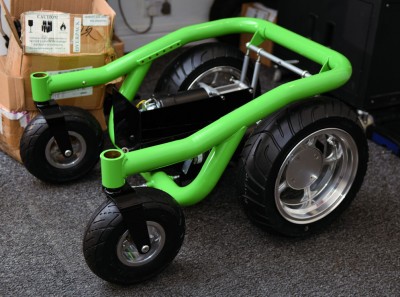

Casters and forks fitted...
Slowly but carefully.

Postby Burgerman » 30 Dec 2015, 15:54
Adjust and align...
Pic 1
Posts: 45302
Re: Rebuild BM2 green...

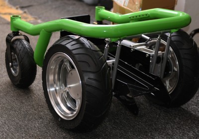

Postby Burgerman » 30 Dec 2015, 15:56
Again... Line up motors, adjusting all roast joints ((c) jenny) (2nd from left, top, too long, etc)

Postby Burgerman » 30 Dec 2015, 16:01
Rear battery door, hinges, etc, and replace top motor mounting bolts with thinner head ones to miss battery terminals by greater margin.
Postby Burgerman » 30 Dec 2015, 19:30
You can see the stainless steel door hinges used on the battery door! :lol:
For anyone skinny, building a narrow chair, you could still move the rear wheels 10mm inboard (each side) if required and then it will be under 25 inches total. I left the 10mm gap so I can later on bolt on 4.5 wide rims, and even lower profile 145 tyres. As soon as I can find a set this side of the Atlantic.
