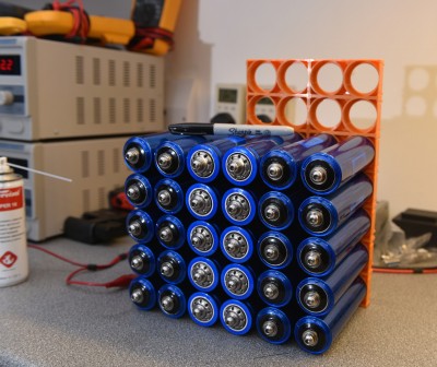

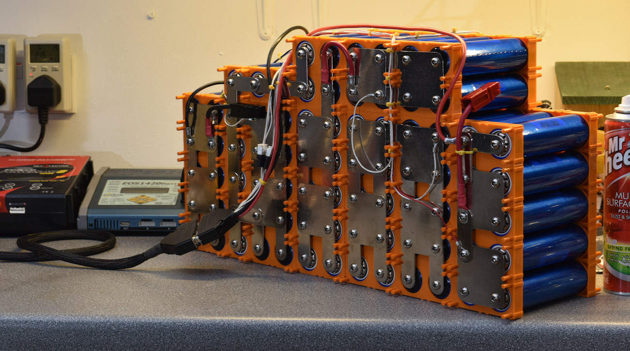

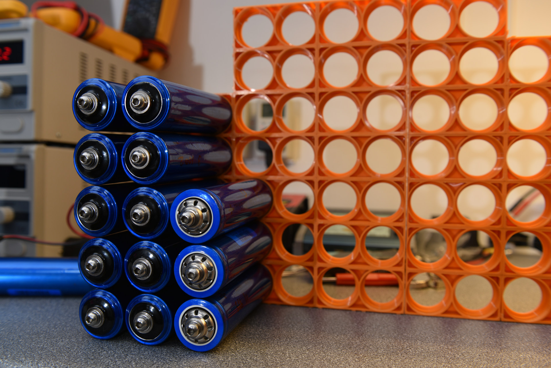

Built, cells carefully selected into 8 identical groups, so that they have equal self discharge rates, capacity, etc.
And under test. Wiring will be tidied up and cable tied. This splits into 2 halves.
80 Cells, 120Ah, 3000 plus watt hours, all cell groups selected after 6 weeks for similar self discharge rates, and for Ah capacity. This is under test.

Postby Williamclark77 » 18 Jan 2016, 00:23
Very nice! I wish I had known of those connectors before I did the Anderson and aviation plug connection to charge my 14s pack. It works fine but is three things to plug in. Simple enough but the aviation plugs are pretty annoying to get connected good.
What's the heavy red cable at the top for? The short one horse-shoe'd over. It looks to be making a parallel connection. I was wondering why it instead of a two hole plate?
Looks good! I'd like to see a real world range test when done.
WcMade.com - Get nearly anything you need made
Williamclark77
Posts: 1020
Joined: 21 Mar 2013, 01:18
Re: Rebuild BM2 green...
Postby Burgerman » 18 Jan 2016, 01:21
Part numbers, pictures of the correct connectors.
The battery is in 2 halves. Hence the link cables. Tried Anderson, has too much resistance and at 40A charge cell 4 shows 10mV too high... So solid cable link. And very tight bus bars. It even matters where you connect the balance wires. Can be 5mv difference from one end of a bus bar to the other...
Get it right and it looks perfect and the exact same voltage to 3 decimal places on every cell.
If you fit the cheap turnigy watt meter, you can find out ultimate range easily. With lithium as you already know, there's no Peukert. They run at full power to 99 percent. So you can measure actual Ah used, over a typical day, use your phone GPS to measure miles, and just do the maths. It will be within 1 percent. Range should be rather good. Lower current 6.2mph motors. Rounded profile 6 ply radial tyres have very low rolling resistance. Battery is lighter, chair is 100lb lighter. The stock chair claims an ISO 24miles from 56Ah Sonnenschein gel batteries. Which is bull but... With better tyres, less weight and a true 120Ah I should go at least 3x to 3.5x further. That's 75 to 85 or more ISO miles. Or real world about about 2/3rds that. We will see -- I am fat!!!

I actually look at this connector... when I salvaged my generic China pack... was it 2+ years ago? Since I had already made up the Anderson output to the TravelScoot, I just reversed it as the main charge leads...
However, building a pack that doesn't get disconnected with every use, a single connector is so much cleaner.
What is the service life of the connector?
Is there a rule of thumb for getting the best balance reading?

Postby Burgerman » 18 Jan 2016, 01:39
Service life? Unknown. But I can soon fit another. Looks pretty well made.
Its quite heavy gold plated. But even when that's worn away I don't see much of a problem. If there is it will show on the graph screen as uneven balance? But its proportional, and so will adjust for resistance changes on the fly... Cells all look pretty well matched here to the 0.001V level! (This Shirley, is why we don't use a BMS!)

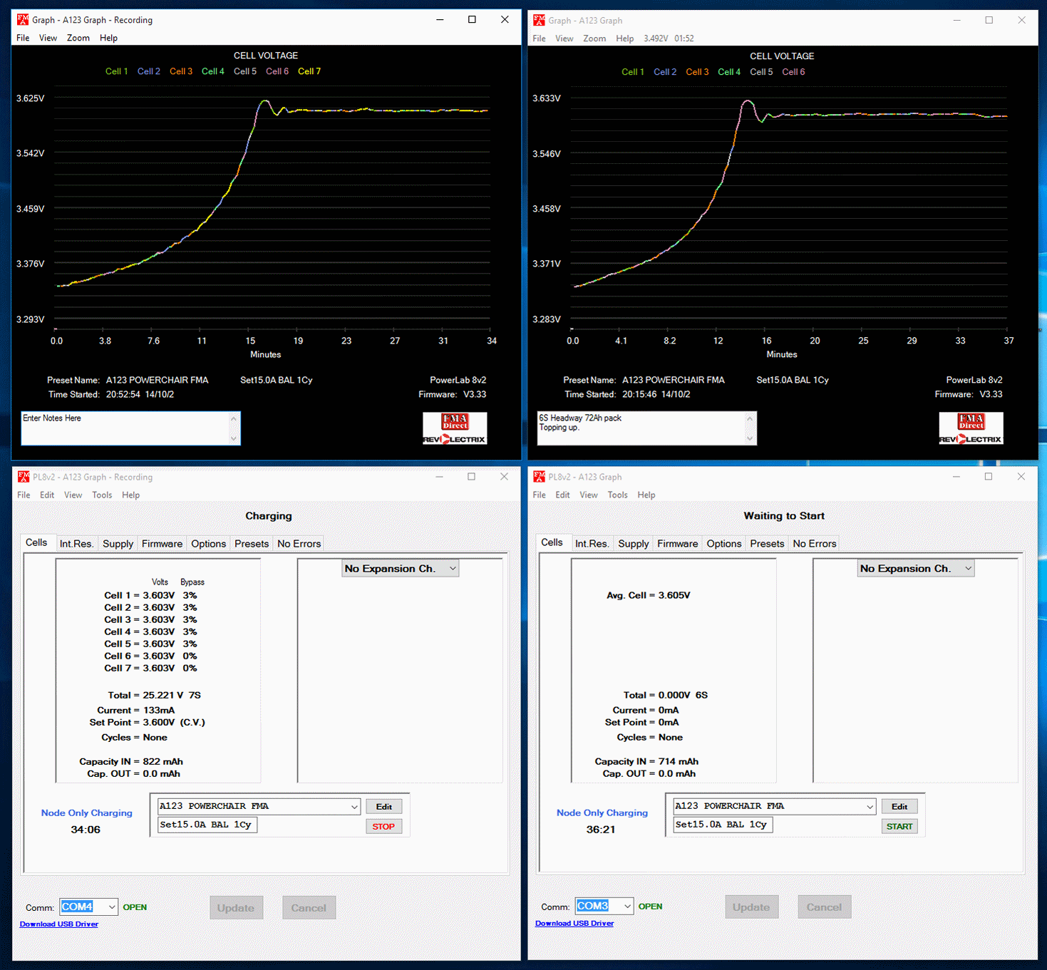

BM2 one (2 connectors, as a 6S and a 7S pack at once).

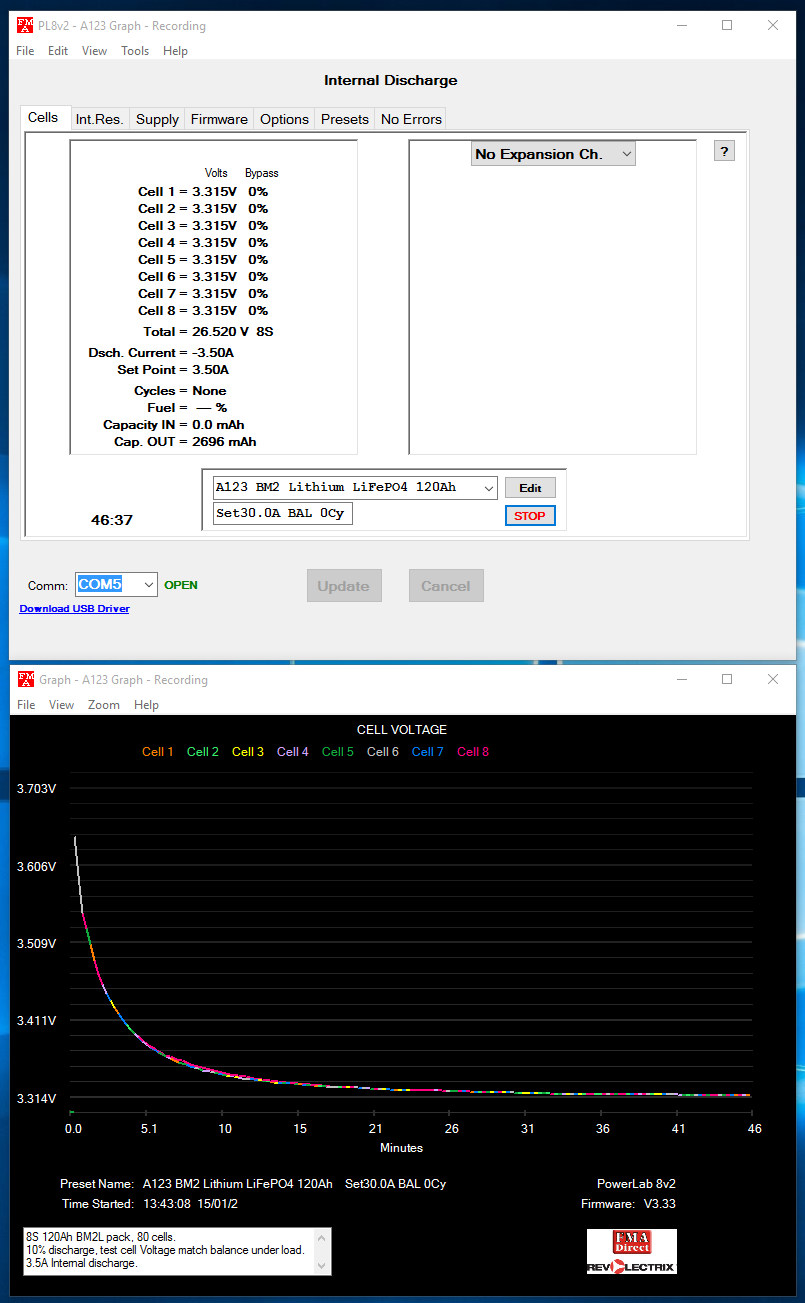

And an 8S 120Ah discharge shows why voltage tells us nothing useful... Temperature varies the voltage far more than discharge level:
First charge so not completely together:

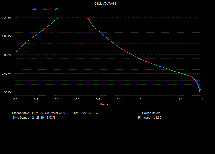

Discharge testing my quadcopter battery, through same connector while testing (only 3 cell, and all 3 well matched, this is LiPo so different voltages:

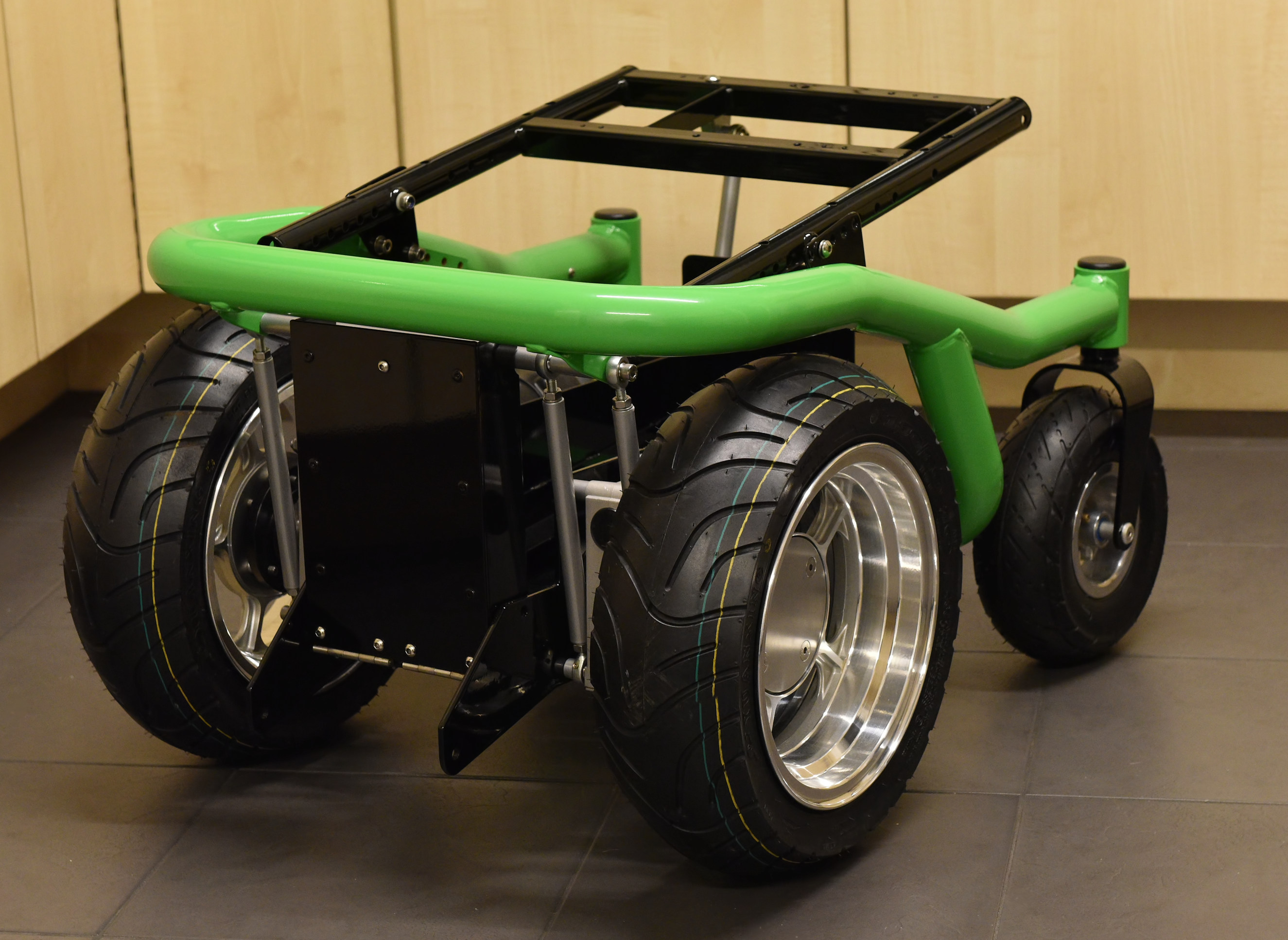

More pics while it was in the kitchen... Bit of space.
BIG ONES!
Just ordered anti tip wheels (80mm black hard urethane inline skate wheels) and spacers, and bearings. And a 120mm M16 8.8grade bolt for the tie down. Those have to be fitted, tested for fit and angle befopre battery can be added as I cant get it up on the bed afterwards. Too heavy!

Once the tie down bolt is in and the correct length, anti tips on, and battery in place then its all over. Just bolt the seat together. And then make a footplate (by a beermat drawing and a online laser cutter!) and drill a few holes etc to fit it. Then we can go for a silly mileage marathon!
At a narrow 24.6 inches wide its the same width as most 55Ah 22nf battery INDOOR/outdoor type chairs that use skinny tubed or rock hard flat free tyres with about 15 miles max battery destroying range like the Smaller TDX chairs, the Pride Quantum 600 and Edge chairs etc. Only with about 60 miles or 4x the range. And the ability to work properly outdoors without filling loss or the casters sinking in or high centering. Its also shorter.

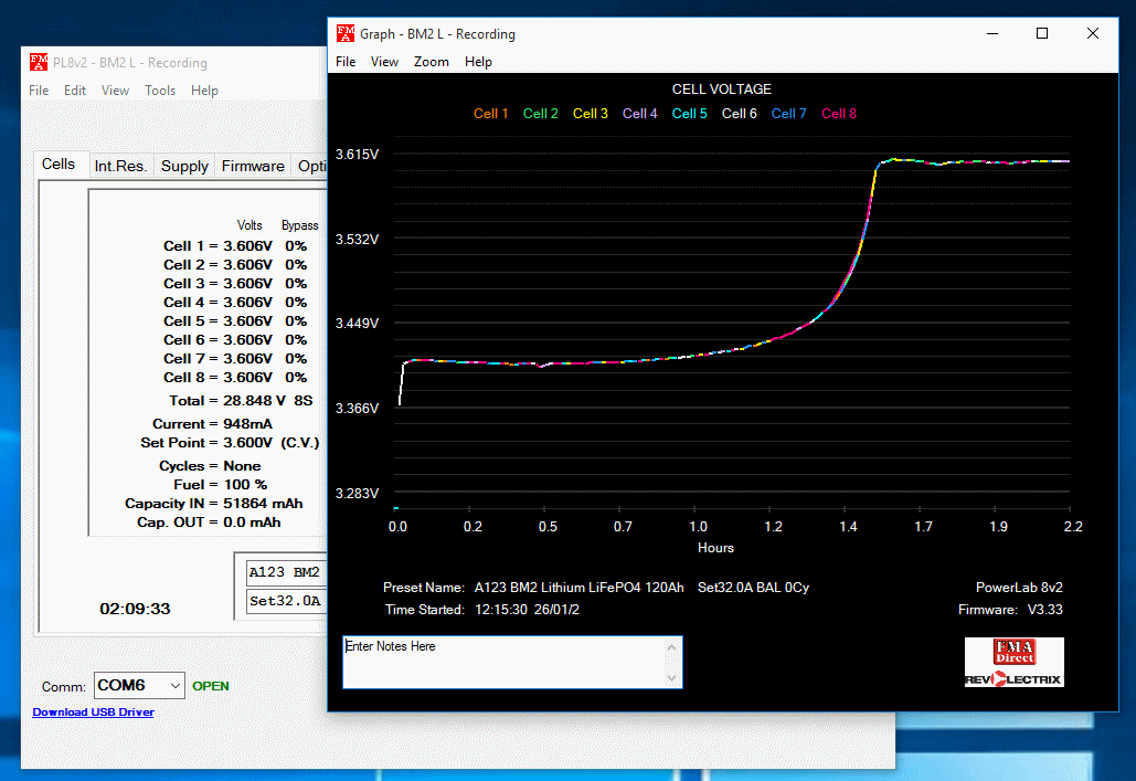

Battery testing complete.
Discharged by 50Ah and left for 10 days.
Recharge test, all cells remain in perfect balance, and 50Ah returned at 32A recharge rate in under 2 hours. Will fit battery on Wed.

BM, can you post pics of both sides of the battery pack please, so I can see how the balance wires connect. If I see rightly, you only have them connected to 9 places on your pack.
Posts: 3224
Postby Burgerman » 26 Jan 2016, 23:19
Yes. 8S needs 9 wires...
I can take one shot of the other side, but the cell layout is very confusing!
1 - 2 - 3 - 4 - 5 - 6 - 7 - 8
Theres a wire at each end (plus 24V and minus or 0V) and then 7 wires on every one of those hyphens above.

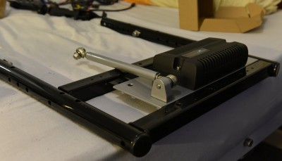

Postby Burgerman » 27 Jan 2016, 21:05
And the PM is mounted to the alloy plate, bolted to the seat frame under the front. I am considering adding 2 computer fans...

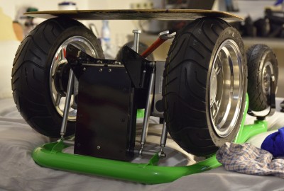

Postby Burgerman » 28 Jan 2016, 13:51
Checking wheel, tyre, run-out, balance & bearing seating etc, caster stem bearing preload, and finally adding the puncture seal. Because once you have there's no way to test balance for eg.
Run-out of tyre or wheel does make a difference. Caster preload does too.
Does balance "matter"? Not much if at all at 6 ot 8 mph. Unless its really bad and not central. But I use the same casters/wheel on my chairs and these are swappable. So these may end up on the 16mph chair. And then it does matter.

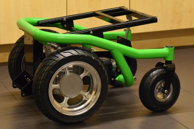

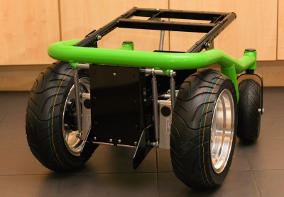

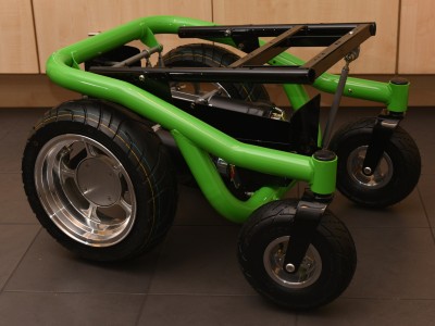

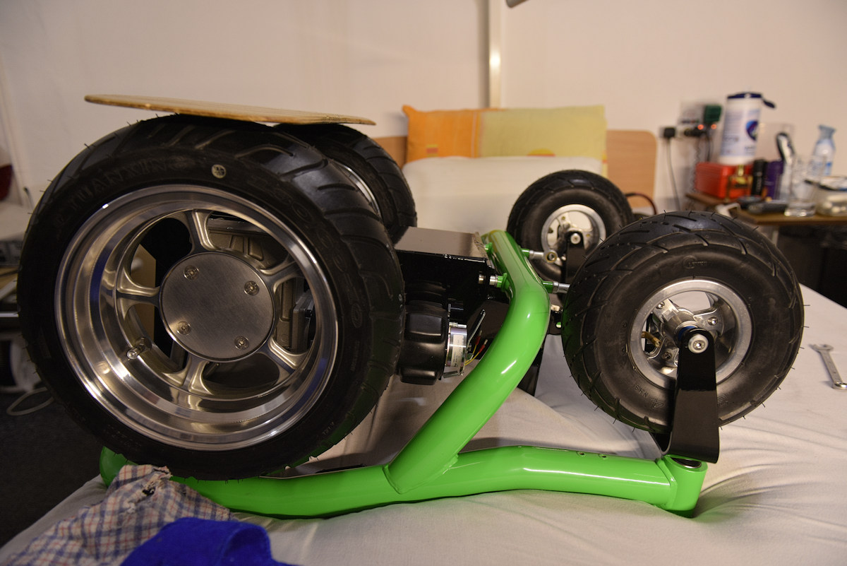

Postby Burgerman » 30 Jan 2016, 14:55
Anti tips fitted. 80mm inline skate wheels. 8 new stainless steel bearings. Because the new 10 inch wheels are about 30mm higher overall.
