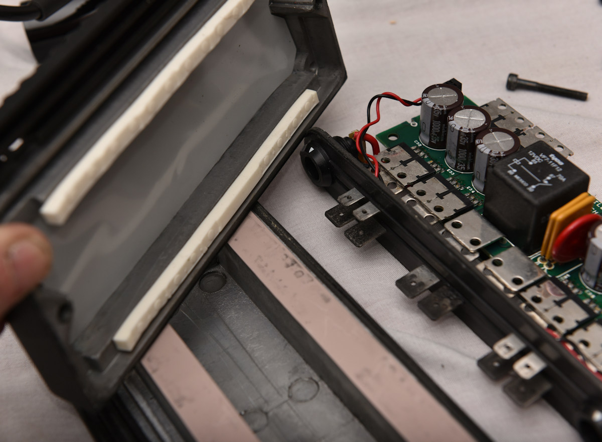

I am just checking out my Pilot Plus well used 100A unit.. All the contacts need cleaning up as they show signs oif burning. on the INSIDE and outside!
Take a look how the contacts connect battery and motos INSIDE. They just press togetheer with some foam strrips...

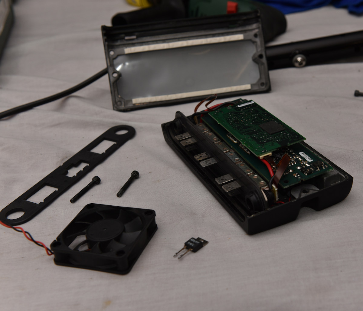

I am also adding a 45 degree thermostat switch. Because I am adding a fan to keep things cool. This will stop it rolling back and reducing power so soon. The best place for the tiny thermostat is inside bolted to the mosfets. But thats not easy... So will be next to them instead.

Postby Burgerman » 02 Feb 2016, 22:15
And now the thermostat is inside the case and the fan fitted behind the mounting plate under the seat cover.
So the power module can sit over the hole on 2 8mm spacers so the air can escape underneath in all directions.
And the fan will come on any tie the mosfets reach 45C.

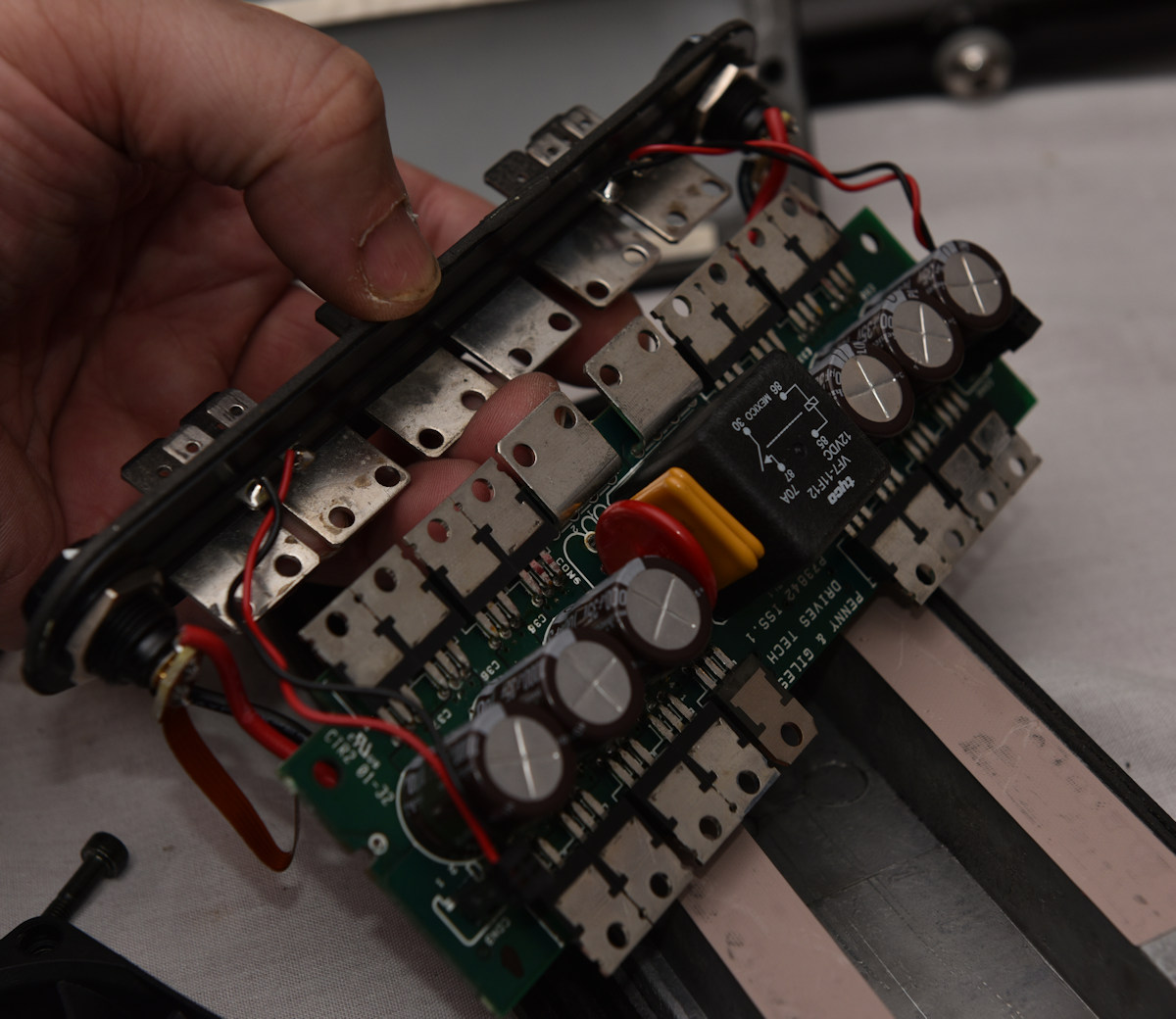

I presume you haven't looked inside your power module yet then?
Image :lol:
Nothing to be scared of. You just get to see how crappy the build quality is, wit only a rubber foam pad making the pressure for all the connections to the power mosfets. Amazing they don't fail more often. And that they are using just 8 power mosfets. Unlike the Roboteq with 32... No wonder they get hot really is it.

Well surprisingly it does appear to work pretty well! I and the rest of us using all of PG Drives systems, inc Rnet should take the thing apart and use a scotch bright cloth or fine glass paper to clean those contact point every year or so though. It will likely prevent failure.

Postby Burgerman » 03 Feb 2016, 17:03
Look at the pictures. Inside. They just press together with a bit of foam! That is supposed to be OK for 100A per motor.
Outside too.

Postby Irving » 03 Feb 2016, 17:49
I don't suppose you know what MOSFETs they are, or have pics of the other side of the board showing them??
Posts: 992
Re: Rebuild BM2 green...
Postby Burgerman » 03 Feb 2016, 17:53
The side with the writing is folded on to the board so not visible without bending them up. I did compare an 80 to a 100 years ago and they were the same. So its only a firmware difference.

Postby LROBBINS » 03 Feb 2016, 20:32
Could be a firmware difference, or a different shunt in the current measuring circuit.

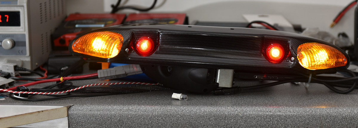

Postby Burgerman » 04 Feb 2016, 16:59
Convert rear light to LED

The reason I was asking what MOSFETs they use is to think on whether they could be replaced with a newer type with a lower Rds(on) (on resistance) and then tweak the current limit. I would expect that current limiting uses a sense resistor that could be changed. The firmware will most likely measure voltage across the sense resistor and once over the limit will roll-back to a lower voltage for a period of time. Changing the limit by changing the sense resistor will retain the same normal v rollback ratio without needing a firmware change.
