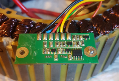

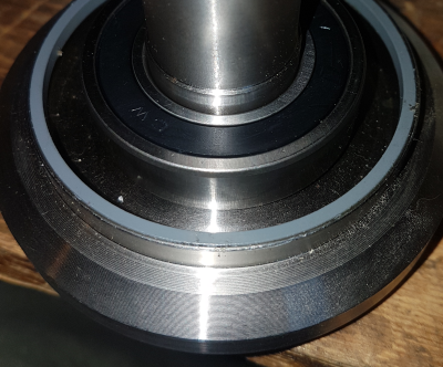

I'm back on my project, and I'm working on getting a pair of GB motors talking to my HBL2372.
At the moment I'm limited to Trapezoidal, but in the future I'll probably get the new 'A' version of Roboteq controller that does Sinusoidal. Can anyone help with info on the small Hall sensor board that sits inside the coils taking readings from the magnetic ring in the picture? You can't see the magnetic ring until you take the axle out. I think Sinusoidal will work with the bipolar latching Hall sensors I've installed, but it would be nice if I could use the existing sensors
magnetic ring
Hall sensors. Are they special ones, I'm not sure what the LF stands for
Six wires! 2 for power, maybe 2 for each signal? Not sure!
On the Roboteq it's 2 power and 1 for each Hall sensor making a total of 5, but thats for 3 sensors.

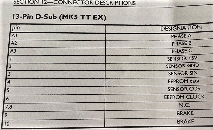

Postby hank » 14 Aug 2019, 19:37
Dont know if this helps you ;)
Wire notes.

It's been a long time since I looked into the GB motors but I do believe they used SIN/COS commutation and not 60 or 120 degree hall. That would explain the number of wires.
Edit: Nevermind. Hank posted the above picture while I was fingering my keyboard. SIN COS it is.

Yes it does, thank you Hank! One of the things that made me think it might be possible was that the Sinusoidal mode of the Roboteq HBL2360A has to do a configuration before you can use it, and the original Dynamic controller has the same requirement. So that little board in the motor has an Eeprom on it seeing as theres an Eeprom feed. I certainly know more now, but I'm not sure if I'm closer or further away from being able to do it.
