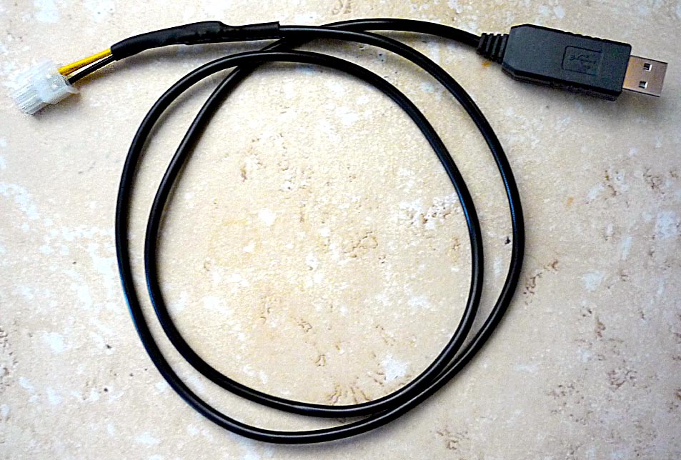

Completed S-Drive Programming Cable

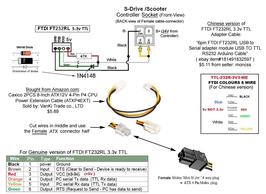

Wiring Diagram and Parts List

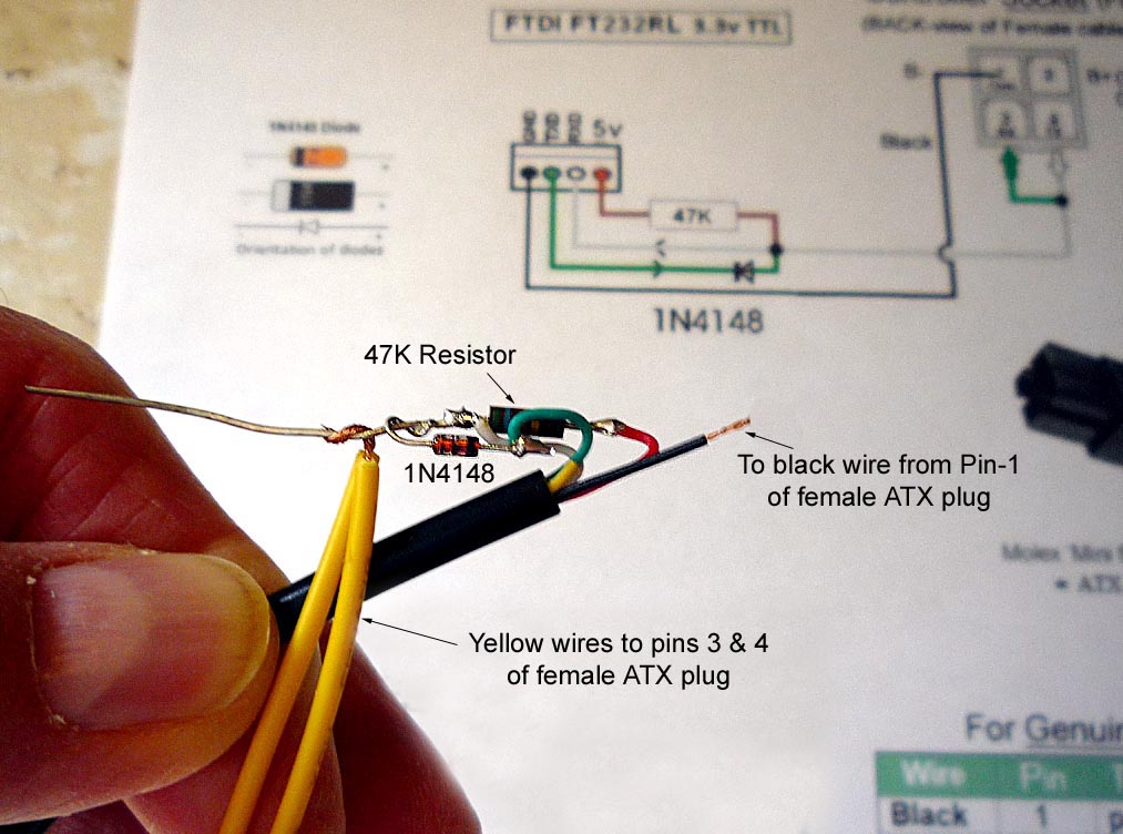

Making The Cable

I wanted to make a programming cable just for my S-Drive controller, so with Woody's help, here it is. The middle photo shows the wiring diagram and parts information. The bottom photo shows the lead modification. The thick black wire under my thumb is from the FTDI USB converter cable that I purchased on ebay. I just cut the original 6-pin flat connector off the end of that cable and trimmed off all but the red, green, white and black wires. I slipped a piece of large heat-shrink tubing onto the cable, then soldered the components onto the wires as shown after cutting the ATX extender cable I bought on Amazon in half and using the female plug part. After testing it to be sure it worked, I slipped the heat-shrink tubing over the components and shrank it to protect everything.
The top photo shows the completed cable. The plug fits right into the programming socket on the S-Drive controller. I plug the USB connector into my laptop and use the PC Programmer software so I can modify the desired parameters to suit myself.... making the scooter more responsive, etc.

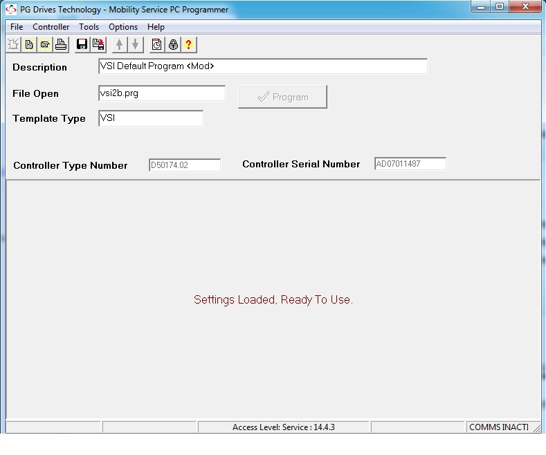

Look for: "To download a free copy of Service Programmer software, please click here." and click on it. This should give you the latest PC Programmer software.

NO! NO! NO! ...the SERVICE software is absolutely NOT what you want!!!!!!

The USB FTDI cable that I use/make ... will ...with the correct end / connector ... perform the same function as both those leads.
I have actually made one for myself that has 3 CONNECTORS on the one USB lead...this lead will program the S-drive and all the PGDT Mobility devices ..( post Pilot ) ...and will "talk" to the SOLO controller ...meaning that the mobility program recognises that it has a SOLO controller plugged in ... but then say's that your using the incorrect software .

NO parameters can be viewed or altered with the Service software.
Service software only allows the downloading or uploading of a set of parameters....
These files which have a .prg extension can be supplied by the manufacturer or created and ALTERED by the other software versions.

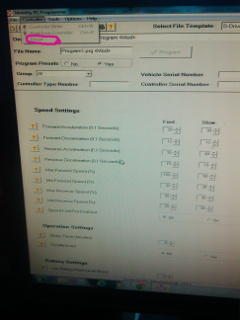

I can not get the preset restart

Never touch preset.

peterik wrote:I can not get the preset restart
Can you upload a better picture please.

I can not get prednastavené reštart It is not

Postby Burgerman » 07 Feb 2016, 10:54
Far too small?

Service software is useless for you ...it only allows uploading or downloading of parameters ..you cannot see them or alter them.
In order.
Service , Dealer ,O.E.M & MAN ( Manufacturers ).
MAN is what you require... and yes the software will tell you of any errors.
