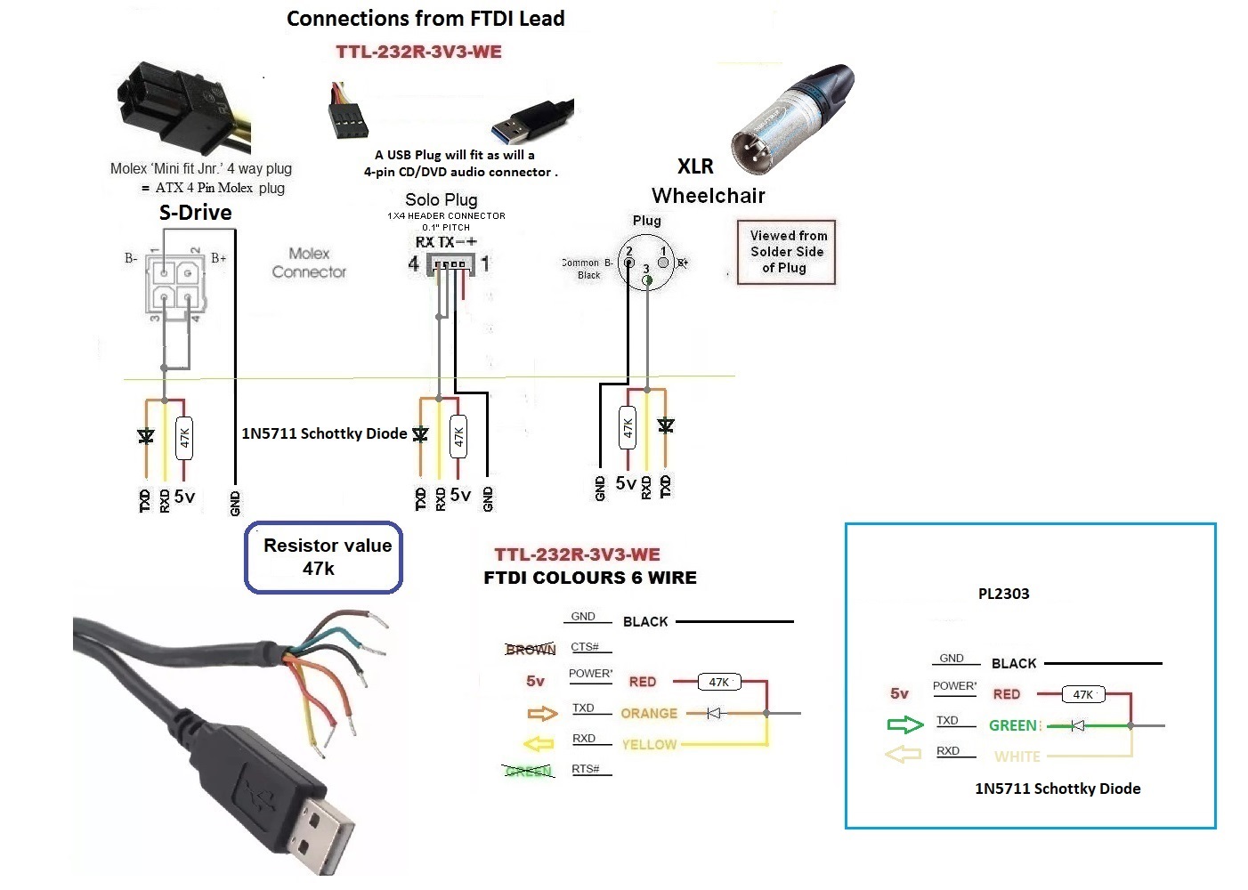

Finally today I did it successfully. The issue was the damn CH340 chip, infact today as I received the FTDI232 I connect it with the same previous wiring setup and it worked like a charm. :dance
So thank you all guys for your time, especially @woodygb, I really appreciate it!

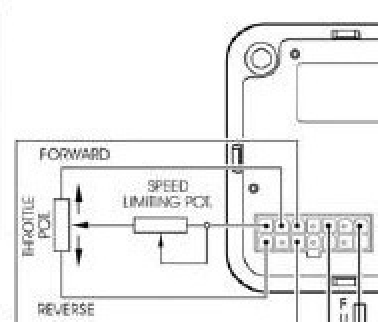

Then i use an curtis 1225, this controller have the abiloty to modify the sensitive of anlog input. So you can install an robust poti (in use https://docs.rs-online.com/56b9/0900766b81584534.pdf), set the parameter to 15 instead of 100 and so you can use a 285° poti as an 20° poti. This works great, but not with PG Controller.

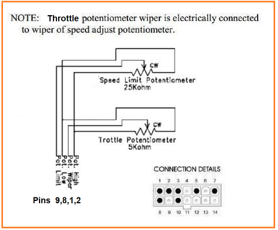

In case of PG controller it seems to be a current sensing system because the second ground speed poti is in serie with the wigwag and in this case only current measuring is avaible or anothe black magic measuring. Now i know that the ground speed is also avaible at a separate pin after controller programming. I hope i got 0V and 5V on the poti-pins to feed the mcu and drive the controller with analog output.

You do NOT need the second speed limiting pot... simply omit it.

You do realise that there are 2 wiring options for the speed pot?

To start with I tried a couple of usb - ttl adaptors I had kicking around , the first was a genuine pl2303. This did not work.
Next I tired a CH340, again I had this and use quite regularly for other purposes, again this did not work.
Today I received a ft232rl, from a uk seller, but probably fake, it worked- first time no problems.
I have seen some discussion in this thread regarding the pull up resistor value, I can confirm that 47K and 33K both worked fine and in fact I still had good comms with the 5v completely disconnected from the adaptor.
I used both the manufacture and oem software versions without any problems, and I was able to turn the annoying reverse buzzer off completely. Happy days.
Big thanks to woodygb for providing the software and manuals.
