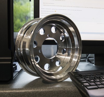

Postby Burgerman » 21 Oct 2018, 16:01
No non are. But you can fit ones that are. And you can fit tubeless tyres like your car now uses for the same reasons. All my chairs use tubeless rear tyres, and in some cases these are also K-Sheld (kevlar bullet proof vest material built in).
And once you have sensible sized front caster tyres (3.00 x 4) 10 inch, they need far less pressure, and with the seat relocated back, to give good control etc, they have very little weight over them. So that they ride over sharp stuff without damage mostly. But even if you DO get a flat, the lightly loaded casters on the modifieed chairs are still useable. I had a flat for about a week once. Didnt stop me getting to the pub every night!
This caster tyre in the video here, was run till it deflated due to the tyre wearing right through! Not really a puncture just a tube worn out against the road...
Do I care? Not really! Its annoying but doesent stop me getting home or into my van. Or to the pub. Its about the whole package, not just a tyre. A puncture cannot stop me. How everything works together. Old tired (as in knackered) chair shows this below The rear are tubeless. And so never get deflations. Casters? Those are not!
VIDEO http://www.wheelchairdriver.com/gopro/puncture.mp4
I practice what I preach. Never failed to make it home in 21 years.
Tubeless K-SHEILD You cant puncture those even with a drill unless very determined!
Tubeless...
MORE TUBELESS
And again, click!
And lastly my TUBELESS salsa.

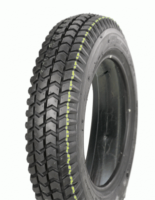

Postby Burgerman » 21 Oct 2018, 16:32
Heres the reason I use tubeless. Puncture seal in tubes works in small holes, if you happen to be pretty lucky. I mean a thorn... Anything bigger and it may work for a few mins. Or more likely you just get a load of tyre sealant everywhere and aa flat tyre.
Puncture seal designed for off road use, seals even 6mm DRILLED holes reliably but only in tubeless tyres. So its all but impossible to get a flat tyre. In tubeless it WORKS!
Your chair in common with every powerchair will come with fragile construction (flimsy compared to real road tyres) grey or black chinese tube type 3.00 x 8 on the rear.
Same as every chair. tubed, and weak. One bit of glass, one small nail, and you are screwed. (Esp if its a screw!). Its why I dont use them. I tried that in year one. I had at least 4 punctures in the summer alone. In every case the chair would not drive. So f**k that for a lark, I cant walk! Since using tubeless tyres, I never once had a problem. Thats over 21 years. I have pulled out large nails, lumps of glass, etc. But they just reseal in one revolution of the wheel. And never need repairing.
Like this below. A Kenda tyre as you will likely get. And so flimsy you can squash it flat with finger and thumb in any direction if not fitted and inflated. Theres no strength or thickness to the treaded area or sidewall. Cheap chinese rubber. Or worse, copies! Still its better than the spine jarring and battery eating flat free option!
