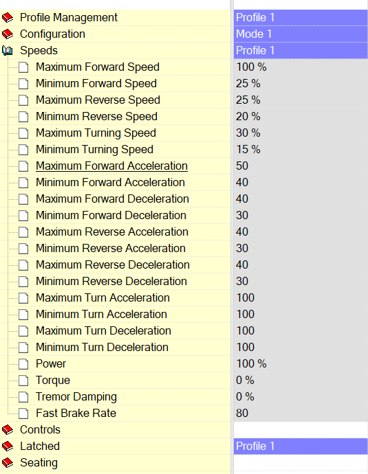

Postby Scooterman » 15 Nov 2018, 14:30
New speed settings. I'm not very good at pulling back on the stick so for now I will leave the fwd dec settings as they are in attached photo. But practice with the back stick so I can reduce fwd dec if need be before the dongle goes back.
But I'm pretty pleased with how the chair drives now. I particularly notice how much better is drives at speed and also it's not as lurchy, clunk clunk everytime I start from stationary.
That's one of the main things I didn't like about the chair. As the power delivery was smoother on my scooter, but now the the torque is set to 0% the chair isn't as clunky.

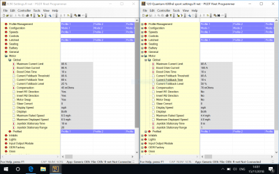

I just swapped controllers. The EL90 for the PM120.
I've written to EL90 settings to the PM120
But the software won't allow me to increase the PM120 maximum and boost currents to 100A and 120A respectively.
But if I re-write the PM120 original settinngs back to the PM120 then I can change the max and boost currents to 100A and 120A.
But I'm worried the other motor settings are wrong for my motors.
NB: The PM120 is off a Quantum Sport 600HD
See attached,
LEFT = EL90 RIGHT = PM120

Postby Burgerman » 15 Nov 2018, 15:38
Use the original, and CHANGE all the settings.
Posts: 49044
Postby Scooterman » 15 Nov 2018, 15:45
Ah!
Do you mean print out all the 90A settings.
Then one-by-one change all the 120A Quantum Sport settings so they mirror the 90A Sunrise settings. But change the motor max and boost currents to 100A and 120A respectively as it’s a 120amp controller
Is that what you mean?

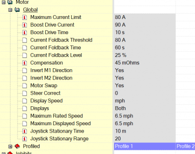

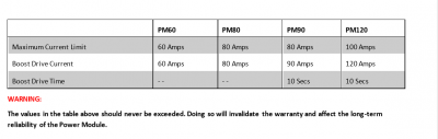

Postby Scooterman » 15 Nov 2018, 16:19
I managed to up the currents on the 120A.
I managed to edit the 90A motor current settings using the generic r-net software instead of the sunrise. Then it allowed me to change the motor current.
I also change the motor comp to 40%
When you get time can you have a scan through the 120A settings r-net file https://drive.google.com/file/d/1u6BThE ... sp=sharing
I'd really appreciate it :thumbup:

Postby Scooterman » 15 Nov 2018, 16:57
These are the 90A settings which are indentical except for the motor currents which are 80A and 90A respectively.
I must say I can't really notice any difference between the two controllers. If anything the 90A seems very slightly quicker but that may be my imagination. Changing controllers between test runs it's hard to judge the two controllers side by side.

Postby Burgerman » 15 Nov 2018, 17:07
The ONLY time you will see any difference at all, is at high torque or high Amp situations.
Ramp climbing power. Turn in place in difficult situations. Curb climbing. And roll back occuring later when worked hard like climbing a long hill, or 10 mins driving like I do. Digging yourself out of a hole, pushing something hard.
Ultimately you will have 25 percent more max torque.
Posts: 49044
Postby Burgerman » 15 Nov 2018, 17:12
120A one looks OK. You might get a little more speed out of it if you set motor> voltage from 21.something to 23.5 though. Although this works much better with lithium.
Posts: 49044

Postby Burgerman » 15 Nov 2018, 19:29
There wont be. Once above about 1mph theres zero difference. The ONLY difference is in stall torque. The sort of speed that will get you up a curb from stationary. Or trying to turn in place, and its stuck, where the 120A version will not be.

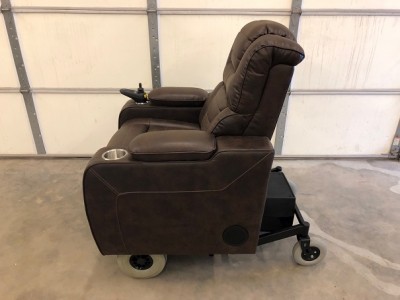

I need some experienced help.
I reprogrammed my PG Drives VR2 mobile recliner and turned up the forward acceleration and changed a number of other things. Now it works beautifully. Now it actually feels natural. Before it felt like like you had to learn how to drive it. It is much faster to boot. No longer the ultra slow program.
The notable flaws in the programming that I fixed were:
1) Front wheel drive rate was set to 50. This was odd since the module came from a FWD chair. I set it to 100 as my recliner is fully FWD with a long wheel base.
2) minimum accelerations were 75. I set that to 45 which made the joystick more like a throttle and easier to control.
3) Turn deceleration was way too high. It was way higher than the turn acceleration. When the top speed was limited, you never really noticed it. When you turn the speed up, the chair will throw you around due to the turn deceleration. I turned it way down.
(FYI, The VR2 module came from a Hoveround Teknique FWD)
I played it for a while and really love the new program so I saved a copy.
I loaded the program in another chair that I just finished building. The new chair is physically identical to the first one.
Now I need some advice from the experienced veterans here.
The new built chair has a tendency to go into sort of a runaway situation in a turn with the highest speed selected on the joystick. It doesn't always happen, but when it starts to turn too fast, I push the joystick forward or to the opposite side. This causes the chair to accelerate in the turn instead of going forward or the other direction. This is the exact thing that would happen on an invacare M41. I picked that one up for cheap, fixed the batteries and sold it. It is interesting that chair would do the same thing occasionally when in the highest joystick speed setting. Is this a fluke in the design or is there a parameter that I need to adjust?

Postby Burgerman » 14 Dec 2018, 11:28
Set turn accel, and decel to max. And min turn acc and dec. Anything else leaves a load of delay in the steering input, and reduce turn rate or speed until comfortable. Or it will never hit a doorway.
The control situation you experience is physics. You cant fix it. It because you are using front wheel drive with casters on the rear which is an unstable configuration. Just like throwing a paper aeroplane backwards. Of expecting a flag to be able to point upwind. Its the reason I wouldn't ever want a front drive chair. Hoverounds are for older people that go slowly mostly indoors.
But looking at the position of your joystick I think you have other issues to sort out irst. Please read the first few posts here. Carefully!
