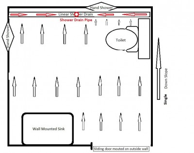

This is the plan. Single slope, linear drain wet room. At one time it was a tiny bathroom with an enclosed shower and barely enough room to walk in. I had it gutted and now we're removing the concrete and rearranging the toilet drain. I'm trying to keep it open and simple.

Postby martin007 » 25 Mar 2025, 22:02
A picture is worth a thousand words...

Postby Burgerman » 26 Mar 2025, 11:47
Hes making a wet room that drains dow to one end.

Burgerman wrote: Floors are just poured in later. They dont go under any walls. So chopping one up just means a big hammer.
That would make what I'm doing much easier, but it's a solid pour under the whole house. My bathroom is pretty small. I gave that bathroom layout to all the plumbers, but it makes the space look a lot larger.
