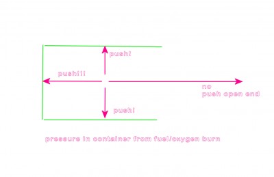

I did a crap drawing. Its the pressure on the inside the engine on the face on the left side here that pushes the engine left. Because up/down is balanced... On the right it cant push theres an open end! The gas just escapes! It doesent push against anything.
THAT is how rockets, balloons, even turbojet engines work.

Engine thrust then is:
Pressure inside combustion chamber X Exit nozzle area = thrust.
So: If it has 100PSI inside the engine casing, and the exit nozzle has 2 square inches, then it will make 200lb thrust.
Easy right?

Yes, but I didn't know it, but it makes sense. I've seen demos where they set off a fire extinguisher while sat in a swivel chair on castors.
