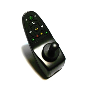

Postby Vitolds » 05 May 2014, 21:42
this way joystick

Re: DWIZ-ADAPT
Postby woodygb » 05 May 2014, 21:46
Those two wires are inside the joystick pod? .... just the black and green?
The Hirose plug is in the black housing?

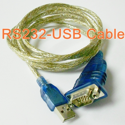

I use the Google translator, sorry. Connection of such
pc
DWIZ-CABLE
DWIZ-ADAPT
Dynamic Shark
