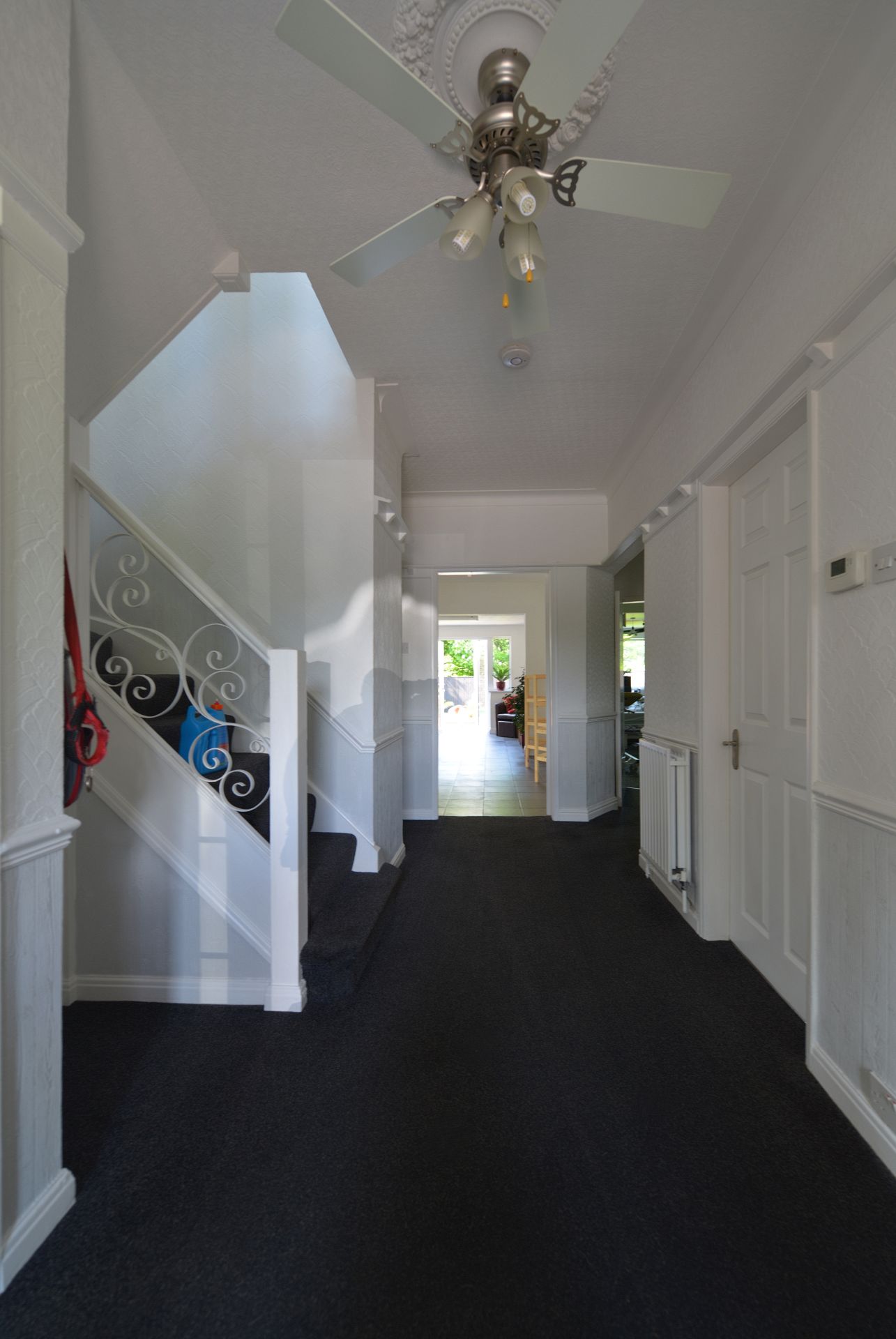

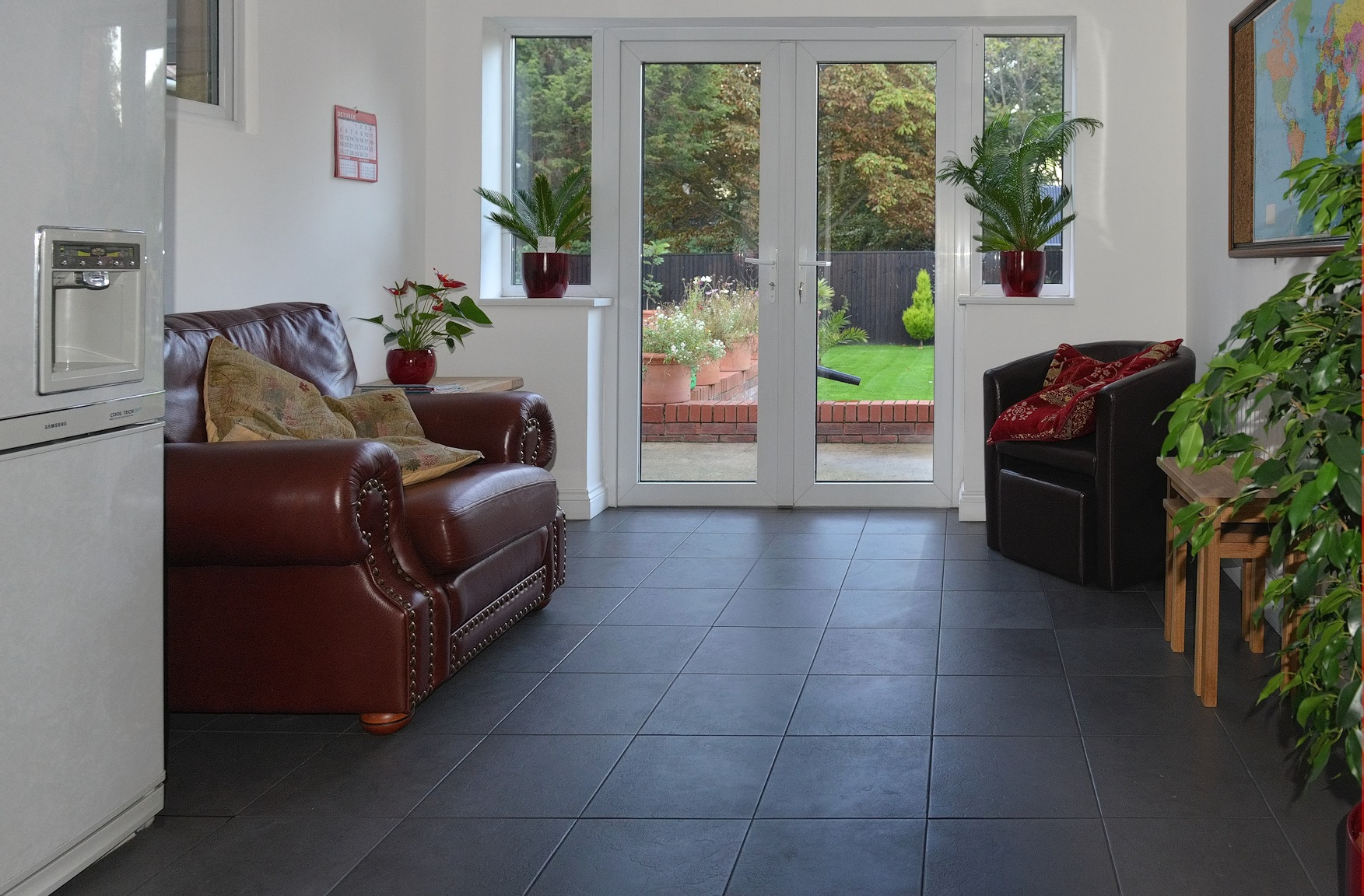

Postby Burgerman » 06 Jan 2015, 14:28
Been using black for 17 years. There's no marks in my house. Because my entrance hallway carpet is quite long and (carefully chosen) black... As I come in this dries my tyres.
Kitchen grey tiles. It leaved tyre marks from back garden if wet but so does grey. Mostly muck. Mops up once a week as new. Other rooms grey or dark colours as they do leave some dark colouring over time. But again only if tyres or carpet are damp/wet.
I also keep a hose (reel) connected so that down the side of my house I can blast all the salt, black road crap or mud /dog shit etc off as needed. Quick blast with a hose and then up the street and back to dry off the water...
http://www.wheelchairdriver.com/images- ... /tiled.jpg grey tiles. Because I am organised! I wanted grey because of wheelchair muck. Nothing fancy, cheap disabled accessible kitchen and everything easy clean. Walls removed to make space! You gotta be organised.
http://www.wheelchairdriver.com/images- ... -dirty.jpg needs a shine, dirty 2 weeks... Quick mop, and a carer with a towel and shuffle about using feet and it shines again.
http://www.wheelchairdriver.com/images- ... carpet.jpg
Black/grey carpet, same reasons... 7 years old.

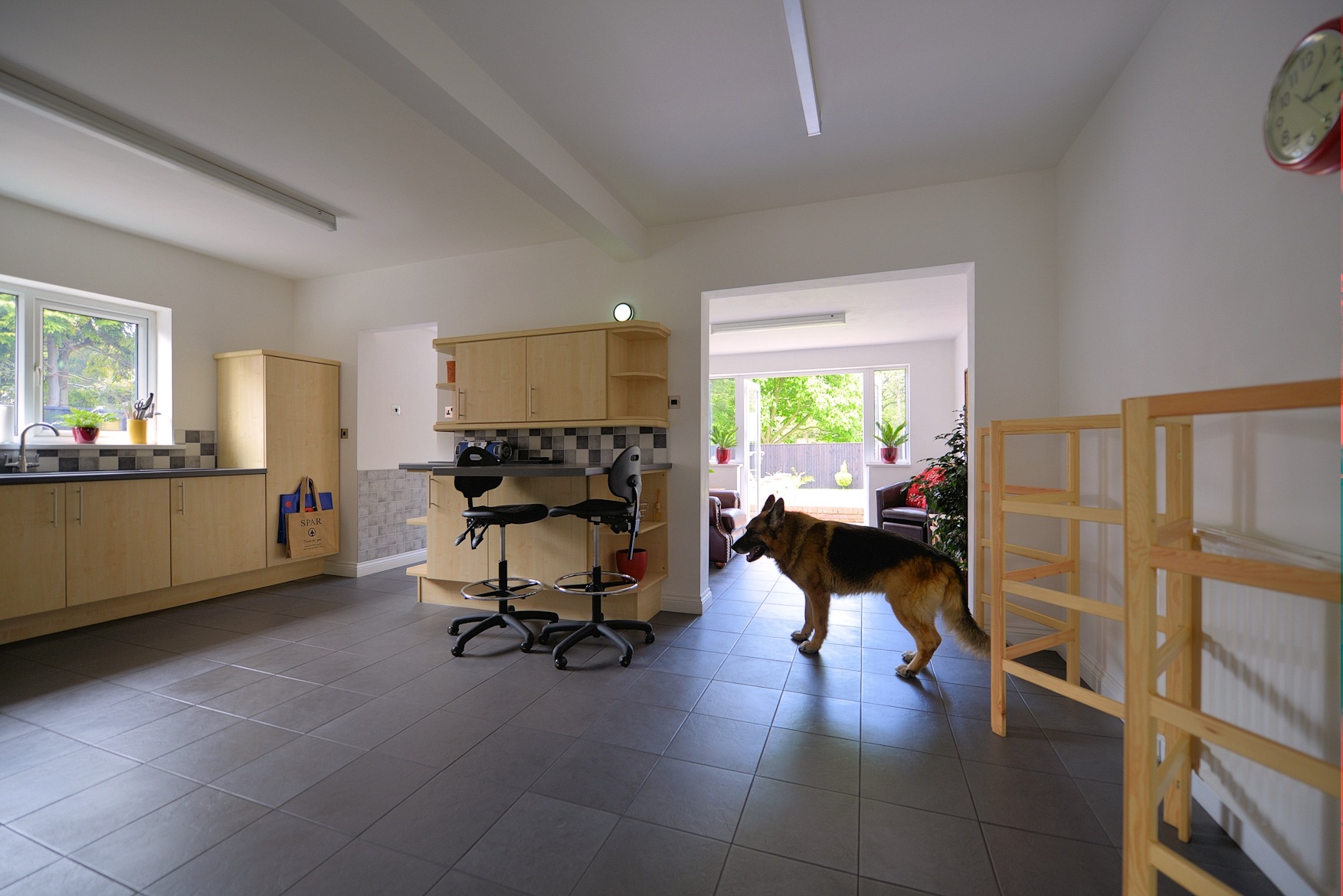

I had a new pale mud coloured carpet that is a good match for our local sandy soil that the dogs can't mess up too much, throughout the house just weeks before I had to start using a chair. It's still too good to replace and I don't have the cash anyway, so the cheapest option was to go grey on the powerchair tyres. They don't look as nice as black though but, for me, they're more practical at the moment.

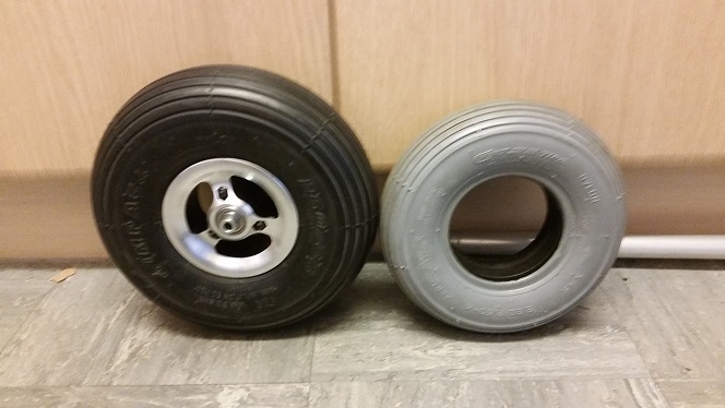

My new tyres have just come. But they're both 1-1.5 inches taller then what I have on now. And the back one is thinner.
We this cause a problem with torque\speed? I'm feeling useless at the moment :(

My mate put a front tyre on and it's to wide, scrapping on the side :( and a good inch taller.
Back to the drawing board.
Re: Can someone check this for me please.
Postby terry2 » 12 Jan 2015, 11:52
Picture of them together.

The black one in the picture is a 3.00-4 mate :)
http://www.mobilitysmart.cc/impac-pneum ... -4225.html
And the back tire doesn't fit either :( it's to high and hits the mud\rain guard.
Looks like I've got to stick to light color tyres. And close on £100 down the drain. Oh well you live and learn.

Black tyre is 3.00 x 4 as your first post said was correct. That's a 3 x 4 tyre.
The grey tyres are 2.50 x 4 -- which is 2.5 inch x 4.
Posts: 70109
Postby terry2 » 12 Jan 2015, 15:42
Burgerman wrote:Black tyre is 3.00 x 4 as your first post said was correct. That's a 3 x 4 tyre.
I did put "2.80/2.50-4 the manual says "23 cm (9”) solid (front)" :D :D no matter they can go in the bin.
But why the back one won't fit is beyond me. Looks like another one for the bin :D oh god I hate power chairs.
