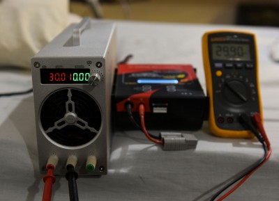

Odyssey AGM say as high as possible AMPS and at 29.4 Volts. I typically charge at 30A next to my bed, 40A next to my computer, and up to 100A in my van as I drive to wack some energy back in fast on my way home.
In ALL cases you MUST charge for at least 16 to 20 hours once a week or more or the batteries will sulfate and die an early death. Because thats how long a FULL charge actually takes regardless of what your mobility charger or joystick tells you. And its required to return the lead sulfate back to the electrolyte.
All via a better (anderson) connector. Do these things, throw away your junk mobility chargers and your batteries will thank you by living many years instead of around 15 to 18 months. And range wont die off in the first few weeks.

Postby Burgerman » 22 Apr 2022, 11:40
ZXD, PL8v2 lithium balance charger, multimeter...
Posts: 70138
Re: Permobil joystick & rapid charger issue
Postby fishinjunky » 22 Apr 2022, 12:48
Burgerman wrote:ZXD, PL8v2 lithium balance charger, multimeter...
I didn't realize the ZXD was that compact. I can see the size compared to the PL8. I've really got to get a couple of these psu. Especially with a iCharger it's less risk of damage. An every couple months use one to charge the mk bricks I took out. But with how good my 200ah lifepo4 pack is doing I may not even bother keeping them around. Maybe I'll just donate them like you did BM.

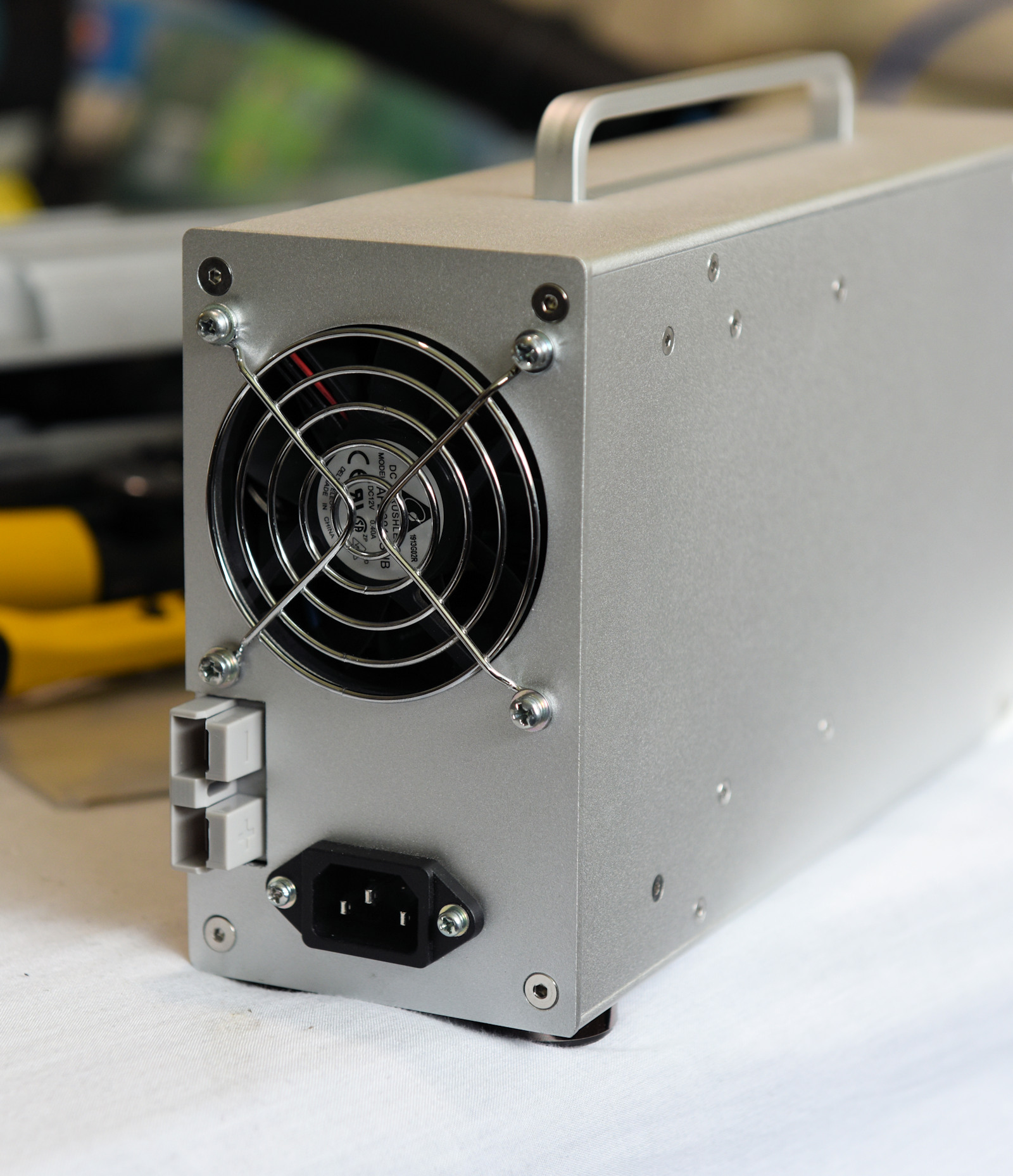

Postby Burgerman » 22 Apr 2022, 19:20
Heres the rear of mine. Note Anderson. Thats what I use for charging at high amps...
Also understand that in europe like most of the planet we all have 240V outlets everywhere. And this ten allows up to 0 to 60v, and 0 to 50Amps.
In the US you have low voltage 110, so will still be able to use it but current us half. So reduced to 0 to 25A.
