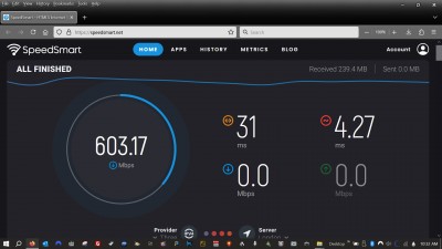

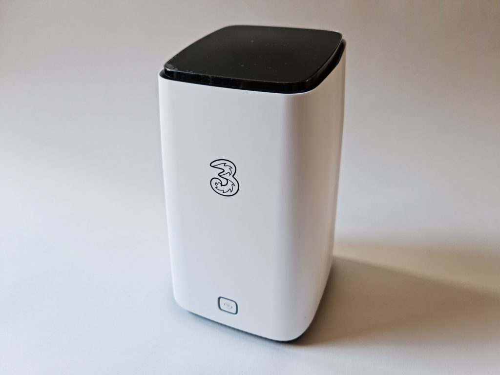

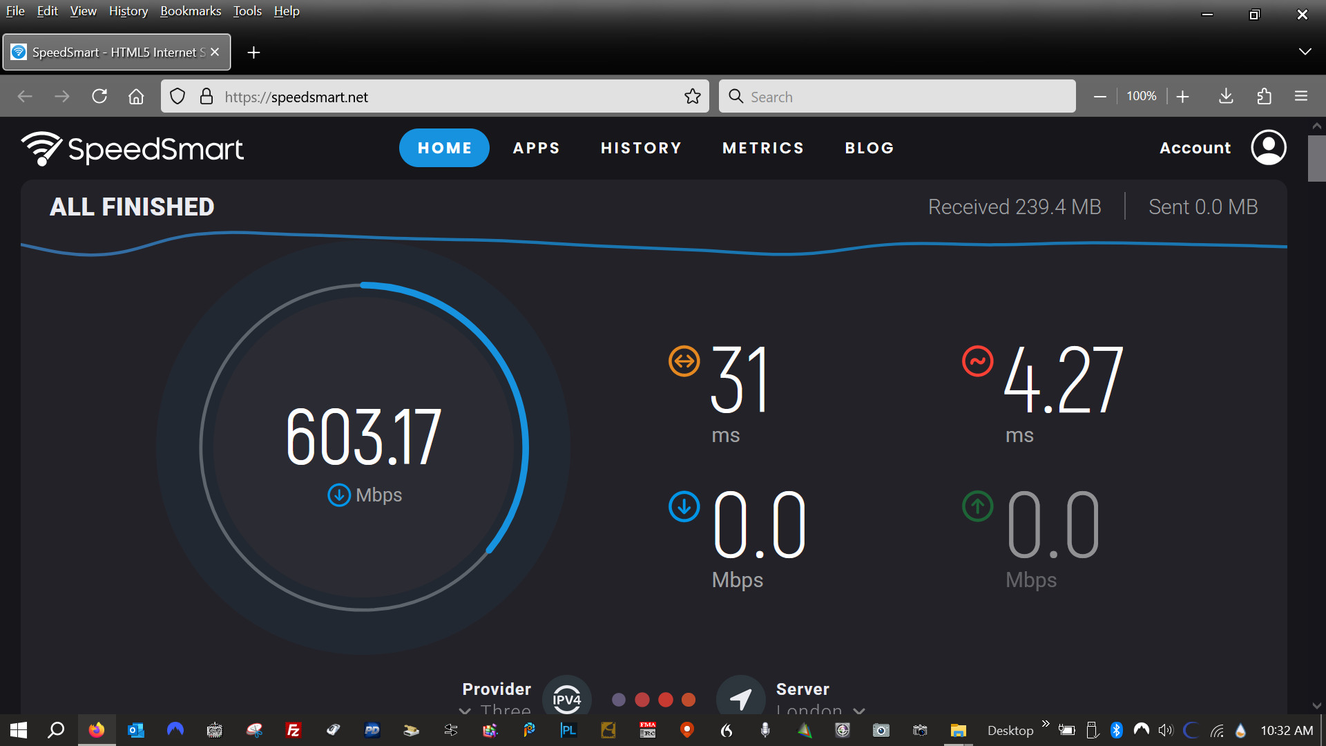

Postby Burgerman » 23 Oct 2025, 00:19
Its all a waste of time now anyway.
I used to do cable, with terrible companies, occasional downtime, slow upload speeds and too much £££.
Now I bought a decent 5G antenna and never get slower than 450mbps and frequently get 700 down, and half that up. For £10 a month! And no limits. I regularly exceed 1TB download bandwidth a month and they dont care.
You just need a GOOD 5G router like the 3 branded one I got off eBay and a 3 sim card (£10 a month, unlimited, 5G).
Then tell the cable internet companies to get lost!
Its never actually down. Because on the odd occasion that one 5G mast is not working for a few mins it just connects to a different slower one for a while. Its like having your own backup internet!
Posts: 70152

Postby Burgerman » 23 Oct 2025, 00:23
Soon we will all have one of these.
Unlimited bandwidth, 700mbps, £10 a month...
No wires needed!
See above 2 posts up...

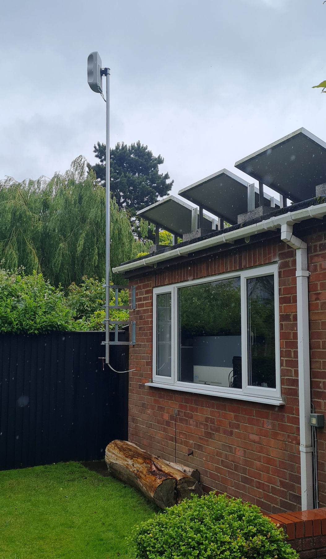

Postby iansp » 23 Oct 2025, 00:26
I have seen your post and picture of your antenna or as you said erection. Many rural locations round here have connectivity problems, I’m ok as I live one mile away from the exchange.

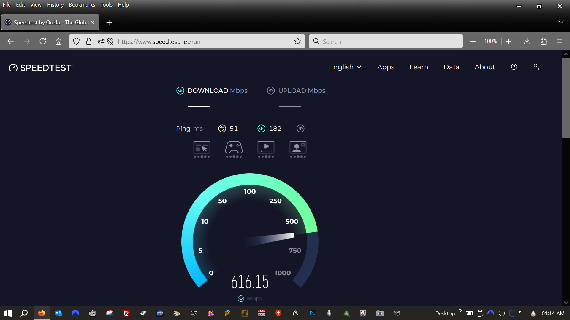

Postby Burgerman » 23 Oct 2025, 00:27
I used to get 500mbps and sometimes it dropped to 300...
So I fitted a 4 x 4 mimo wideband antenna...
Now its super fast.
