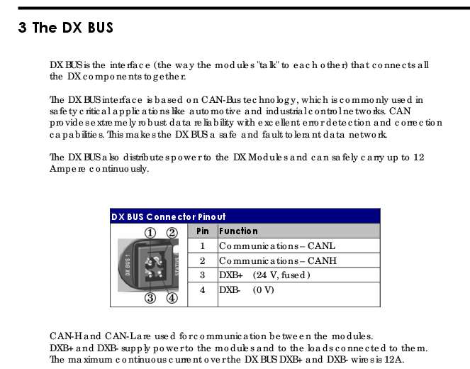

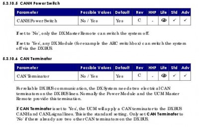

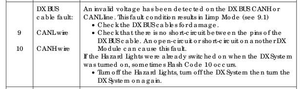

Postby LROBBINS » 17 Jun 2016, 02:08
Is that a DX or a Shark power module?
Here are three snippets from the dx-system-manual-issue1:

Postby LROBBINS » 17 Jun 2016, 07:33
For other models of Dynamic controls it could well be CAN Bus.
What do you mean by this? The Shark and DX (or DX2) are different systems though both use the DX bus cable. I no longer have a DX system active here, so can't check voltages and waveforms. Have you checked this on an actual DX system?
Posts: 5788

Postby LROBBINS » 26 Jun 2016, 17:18
Just to confuse you, here's a correction to something I wrote a couple days ago. I'd written (re the Dynamic DX bus):
it is CAN, though a restricted version limited to a max of 125kbps, with 3 rather than 4 data bytes per frame
The correction is that the standard CAN frame contains 8 bytes of data, not 4. I have 4 in my head because in my system I send (up to) 4 bytes of data and (up to) 4 bytes with the the bitwise complements of the data bytes so that the receiving node can make an extra check (beyond those provided by the CAN protocol itself) for the validity of the incoming information. (This is similar to what's done in the "safety critical" flavors of CANOpen.)
