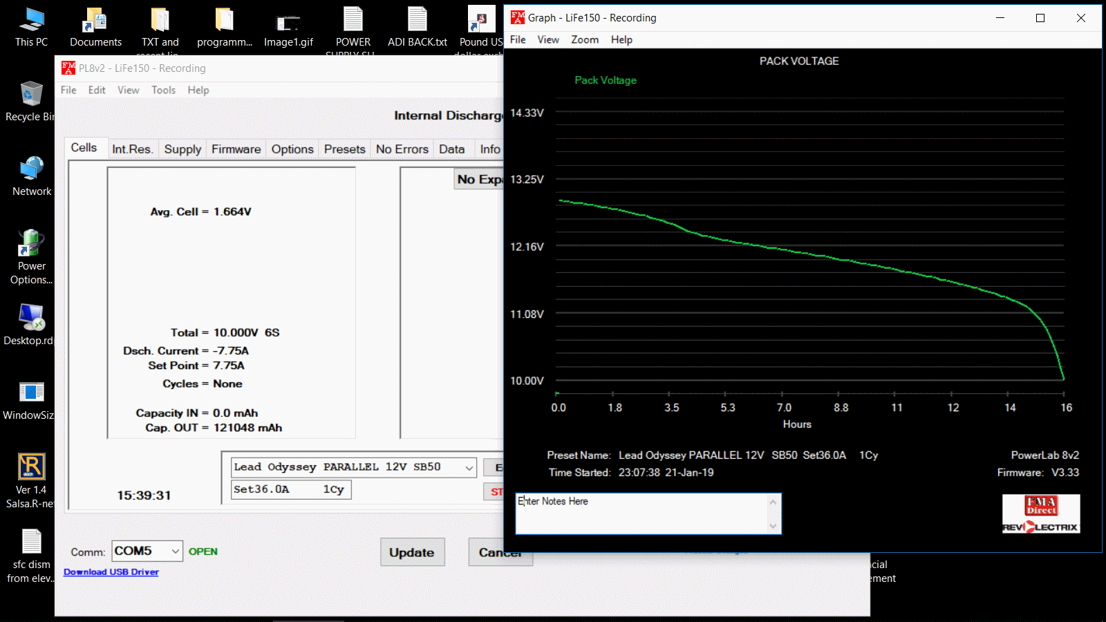

Postby Burgerman » 20 Jan 2019, 00:15
Battery was not great. It didn't want to drop down to the 1000thC termination point, and didn't have much capacity on test.
So I charged again, at 14.70v till current stopped falling. CV for 12 hours. Then set it to 15.6V, and to 1A and left it for another 12 hours. Nothing to lose. Remember that this is 2 batts in parallel.
Obviously it was deeply sulfated. So slightly more volts, constant 1A current to desulfate it as far as possible. Because current is limited to .5A per battery, it can cope with the gassing level and recombine the gasses. The controlled overcharge is ok occasionally, as these are pure lead batteries and so almost no grid corrosion compared to doing this to a normal AGM. Then let it cool for 4 to 6 hours
Discharged a few Ah. Then charged at 14.70V and to 1000thC no problem. (68mA) termination. I actually took it to 55mA. Capacity now at least 80% as good as new.

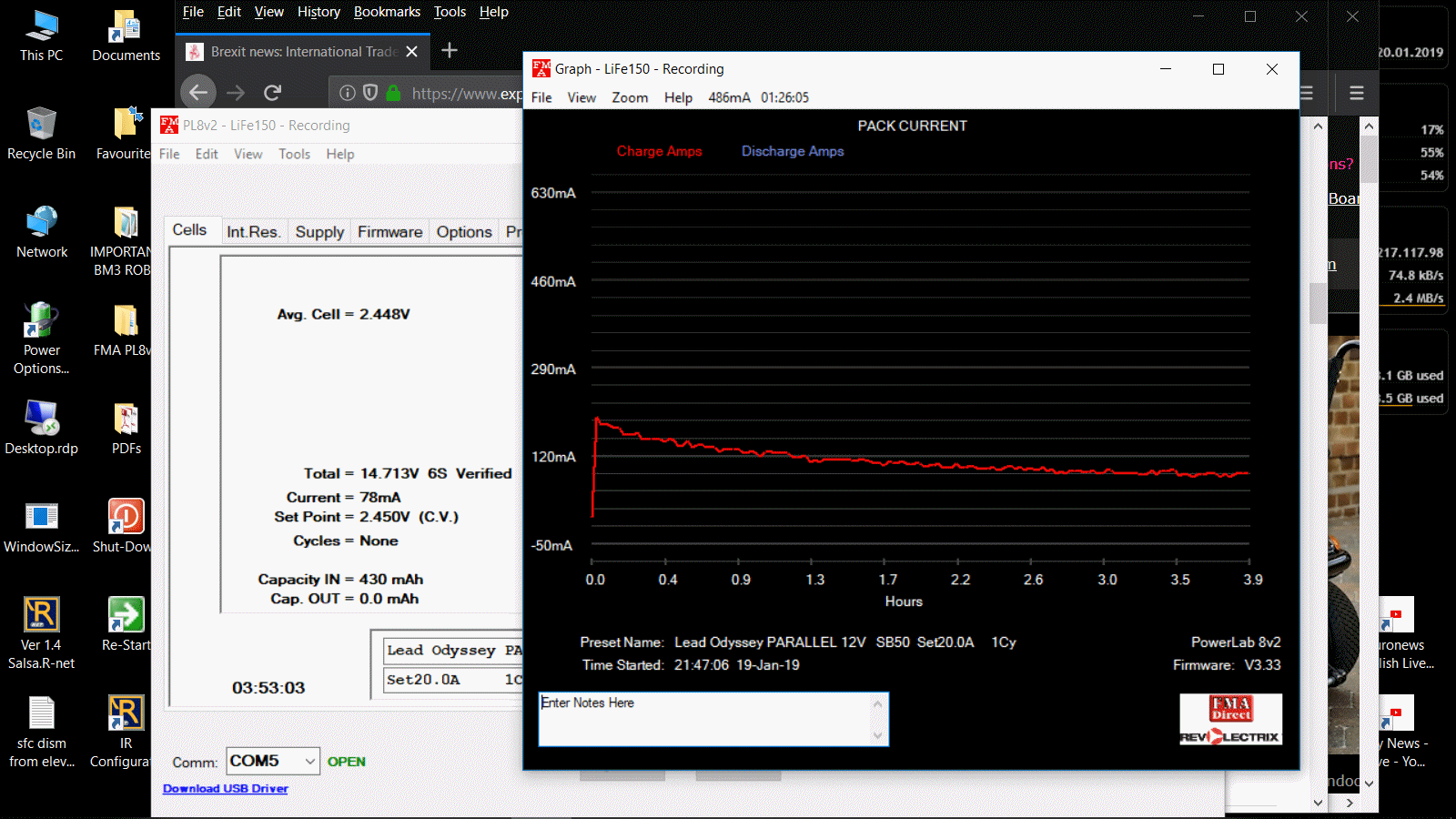

Postby Burgerman » 20 Jan 2019, 02:47
Charge current at 14.7V across 2x 68Ah odyssey batteries has now fallen even more to 78mA. Thats just 39mA per battery! Almost 2000thC. Those batts are 101% full...
It just takes time. This means its returned a little more of the sulfates caused by years of use and being dumped in the garage, back to the acid.
But its been at CV voltage for maybe 2 days almost on and off. This isn't healthy to do all the time, only to occasionally restore a flagging battery.
The normal limit for odyssey is 8 hours CV at 14.4 to 14.7V or till charge current falls to 1000th C whichever occurs first.
And voltages matter. Different types need accurate correct voltages. Likewise there are many float voltages.
-Overnight after a charge in DEEP CYCLE use where the charger stops CV too soon, or gel charging for slow charge use float cyclic use 13.7 or AGM 13.8.
-Overnight after a charge, safe for up to a week, 13.6V slower but safe for all.
-Longer than a week, up to a few years or standby, 13.3 to 13.4 depending on chemistry. Charge at CV 14.1/14.4 dep on chemistry every 4 months.

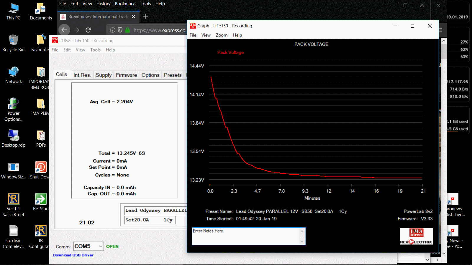

Re: Just dug an old chair out
Postby Burgerman » 20 Jan 2019, 03:15
I ended charge.
I choose MONITOR.
Its fallen as it should to 13.24V and will continue to do so. In the morning it will be 13.18 to 13.20.
In a week it will be 12.95 to 13.05 volts. If full, and healthy.

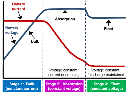

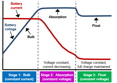

In CYCLIC USE (us!) float is not required, if instead you continue CV (Absorption) stage until the Amps fall to a low 1000thC. As thats the fastest and best way to get a full charge in a limited period. But needs careful setup. And an 8 hour CV limit.
CV (or ABSORPTION if you are a dummy), Voltage depends on battery spec. But 14.1 or 14.4 or 14.7 for gel, AGM, and Odyssey.
The CV or ABSORPTION end point can be about 1A and followed by a l o n g float time. Or better, a low 1000thC point and no float needed.
CC is called BULK by dummies.
FLOAT is always called float, and is a lower voltage top up and long term maintenance CV.
Posts: 70141

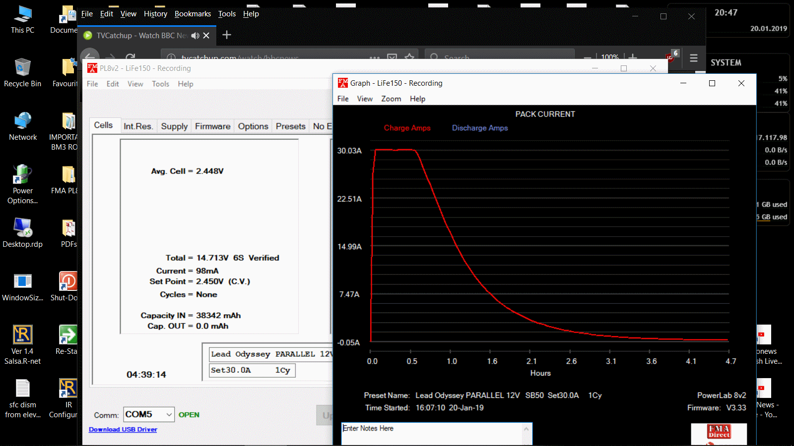

Postby Burgerman » 20 Jan 2019, 20:17
Here is the real world version of that drawing/schematic above. Only the AMPS shown.
Still charging.
Charge at 30A. (the CC part) till it reaches CV level. Took 1 hour. With an 8A charger that would have taken 4 to 5 hours.
Then hold batt 14.7V and watch the amps naturally fall away as the battery charges up.
Its dropped from 30 to .8 of one amp. This is where your mobility charger stops CV and shows you a GREEN READY light. Usually before even this.
The battery is not yet fully charged, but you think it is. Its mobility charger will then either do nothing, or go to a lower float voltage that takes at least another 8 to 16 hours to achieve a full charge if ever.
But my PL8 is configured to keep going till it sees a low 100mA. 2x parallel Odyssey batts. Less current than even 1000thC. And then to charge at at CC 100mA for 1 hour on top. It will then be FULLY charged.
Posts: 70141
Postby Burgerman » 20 Jan 2019, 21:49

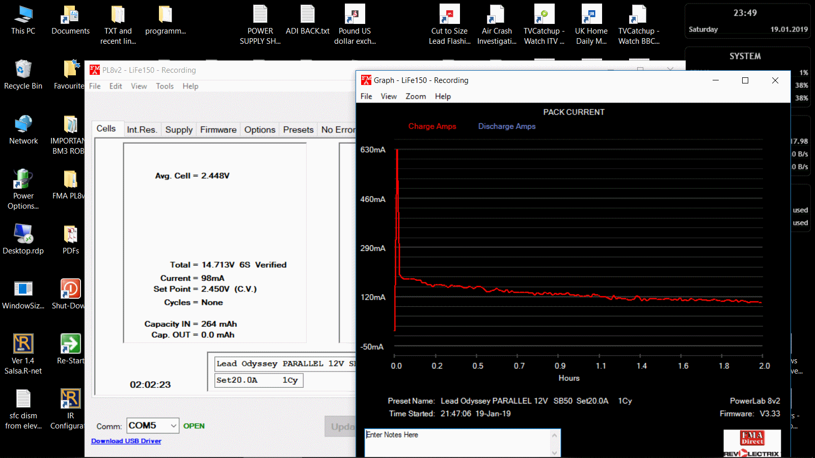

And a few hours later, finally reached 98mA. And stopped CV.
Posts: 70141

Postby shirley_hkg » 21 Jan 2019, 07:50
98mA for one pair together is a very small current .
They will hold a charge .

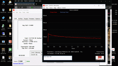

Postby Burgerman » 21 Jan 2019, 12:09
Yep. Dropped to 70 after another hour or two.
Heres the thing.
If your battery DOES NOT drop this low, it is sulfated. Much of that isn't permanent. A slow controlled overcharge at CC can fix it.
To fix it, and gain a lot of performance and charge efficiency, do a one off 2 day controlled low current 15.2V max overcharge at .5A AFTER charging normally. Even on old gels. You have nothing to lose. If current falls to almost zero, stop. Remember that at higher voltages like this current often remains high. So now and again, give it 10 mins rest, and try charging at the correct CV voltage. See what current it drops to.
The Shirley power supply NOT set to 3 stage, can do that. Any adjustable supply can.
What you are then doing, is removing the deeply embedded sulfates from the lead pasted grids, whilst not damaging the battery (much). The idea is that at .5A max the higher voltage doesn't matter because the recombinant chemistry can cope with the gas produced at this low current level. And the controlled continual slight CC overcharge forces any non permanent sulfates to return to the acid. Dangers are loss of electrolyte and grid corrosion. But if the battery is dying from sulfation due to undercharge then thats a bigger problem.

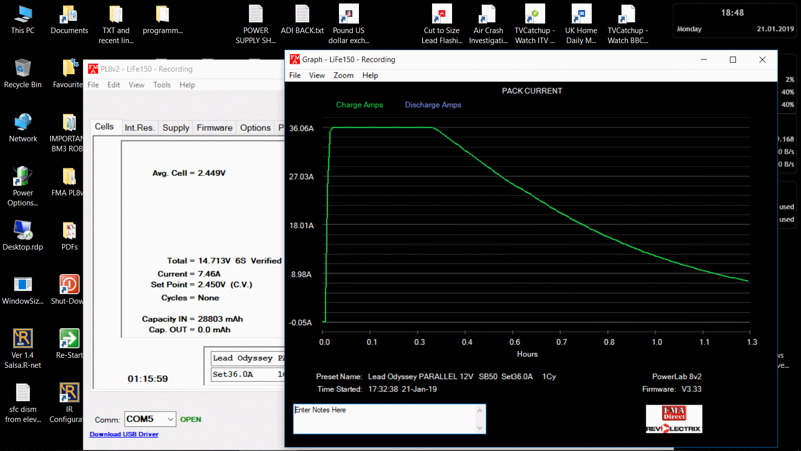

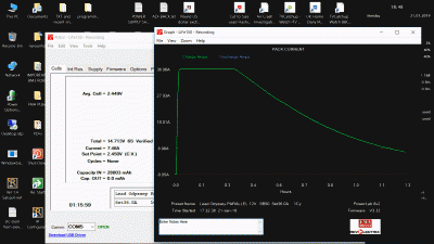

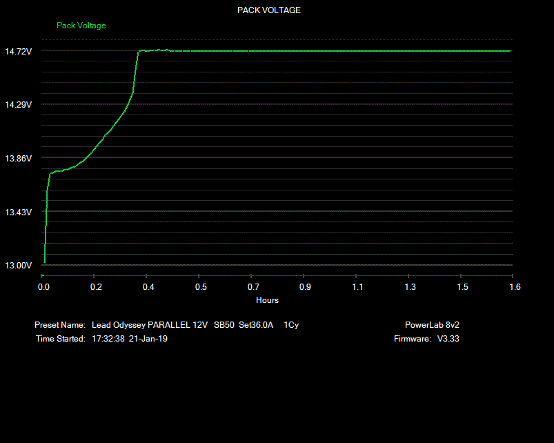

Postby Burgerman » 21 Jan 2019, 19:56
Took out 33Ah yesterday.
Today putting it back, and choose 36A and 14.7V.
After just over an hour, much of it is back. And we are down to 7.5A charge... The same as a stock uselessly slow mobility charger at max power!
Remember that we do this overnight, so about 8 hours. With a fast charger at 30 to 40A the bulk of the Ah is back in in an hour. Leaving 7 hours to let the ever slowing CV stage to get as much back in before you unplug the charger. With a 5 or 8A mobility charger you waste 5 hours at CC going slow, before you ever reach the CV part. And so run out of time to complete the charge. But it gives you a green regardless! Sulfation city ahead.
Here is Amps V time. Down to the Amp point where a mobility charger begins...
So after 1 hour you have a huge head start of 29Ah. With 5Ah remaining. If I charged at 7.5Amps like a mobility charger it would have taken 5 hours to get to this point. Leaving just 3 for the CV stage before you get up.
This is why, ANDERSONS!
And a powerful charger. It allows 7 hours of CV instead, so gives a much more complete charge over an 8 hour night.
Amps.
Volts, held solidly at CV 14.7V. While the current naturally falls away.
Posts: 70141

FINAL step before storing the old chair back in the garage.
MEASURE AH OUT!!!
We need to know the condition of these batteries after approx 250 cycles, and 10 year calendar life, inc being uncharged for a year in my garage. Before being abandoned in favour of lithium, etc they did around 200 to 250 cycles. And are now a decade old. They WERE stored for 9 of those years on a low 13.4 float.
So lets see whats left of them.
They are currently on a discharge of 7.75A. As a pair, in parallel. We are then discharging at around a 17 hour rate.
So thats 2x Odyssey PC1500, which should give: 68Ah@20Hrate, or 65Ah@10H rate. To 10.2V.
So would I expect to get about 66Ah from this set if they were as good as new. right now we are up to 99Ah or about 50Ah per battery. Ans still going.

Postby Burgerman » 22 Jan 2019, 16:06
Empty is a matter of how discharged you decide empty is. And that voltage depends on discharge rate too. Discharge in 2 hours and 9V is not empty. Discharge in 24 hours and 10.8V is empty. When does a chair stop? They vary, and average voltage depression, but at about 11.5V average unloaded it dies, 10V peak under load.
This battery has 2 capacity ratings.
10h rate is 65Ah.
20h rate is 68Ah.
THIS discharge was at the 17 hour rate. Actually took 16...
Results are for 2 parallel batteries so divide by 2:
10.8v = 117.1Ah
10.5v = 118.9Ah
10.2v = 120.0Ah RATED
10.0v = 121.0Ah
Actual rated storage capacity at 15 hour rate as new would be 67Ah. I just measured 60Ah, so this battery is missing 7Ah. About an 11% capacity loss over its life. The PL8 is a very useful tool, IF you know how and what you are measuring.
