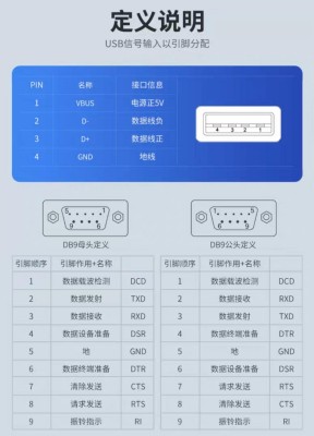

Postby shirley_hkg » 16 Aug 2020, 06:31
Hi woodygb, gonna get a usb cable.
With reference to pin assignment , is the following suitable ?
Female is on left , male on the right.
Posts: 4656
Re: Programming leads
Postby woodygb » 16 Aug 2020, 08:08
They look fine.
I would go with the Y108 that appears to use the FTDI Chip set...but any of the Male type should be fine.

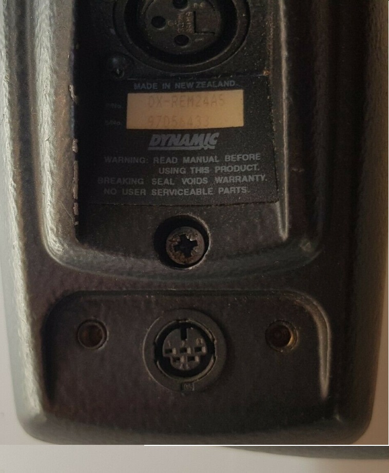

Postby cositom » 08 Apr 2021, 13:15
hello to every one, I am new to this site and the new chapter of becoming more familiar with power wheel chairs as i am getting older I find i need something electric being born prematurely, with many physical issues, I can not believe how complicated these are now, at time i bought one working shop rider MWD, it controls like a drunk sailer on deck in a storm, I also have a you-Q alex FWD given to me as a none runner I discovered it needed a new main controller, having sourced one and fitted it, pleased to find things come on, but here is big but controller firm ware is incompatible with jolly joy stick, having found how to marry the two all still incompatible, I guess my query is its clear i need some sort of cable interface or programmer, if i can im looking to get one device to deal with programming both these machines, would any one be able to guide me through this mine field so I can avoid costly errors i can ill afford only receiving state pension, I would greatly appreciate thank you.
cositom
Posts: 21
Joined: 26 Mar 2021, 12:47
Location: yorkshire uk
Postby woodygb » 08 Apr 2021, 13:22
Can you identify the joystick make / model?
http://www.electricwheelchairparts.com/ ... ation1.htm
Hmmm...probably a DX2
Postby cositom » 08 Apr 2021, 13:42
sorry i very new to forums so hope i am doing things correctly ,dynamic dx2 not sure if r net
cositom
Posts: 21
