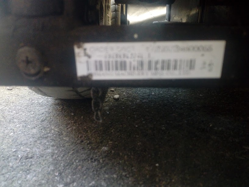

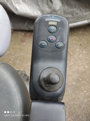

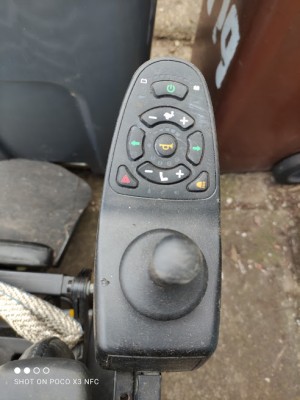

these are the images of both machines, i included the invacare label off the machine in case needed

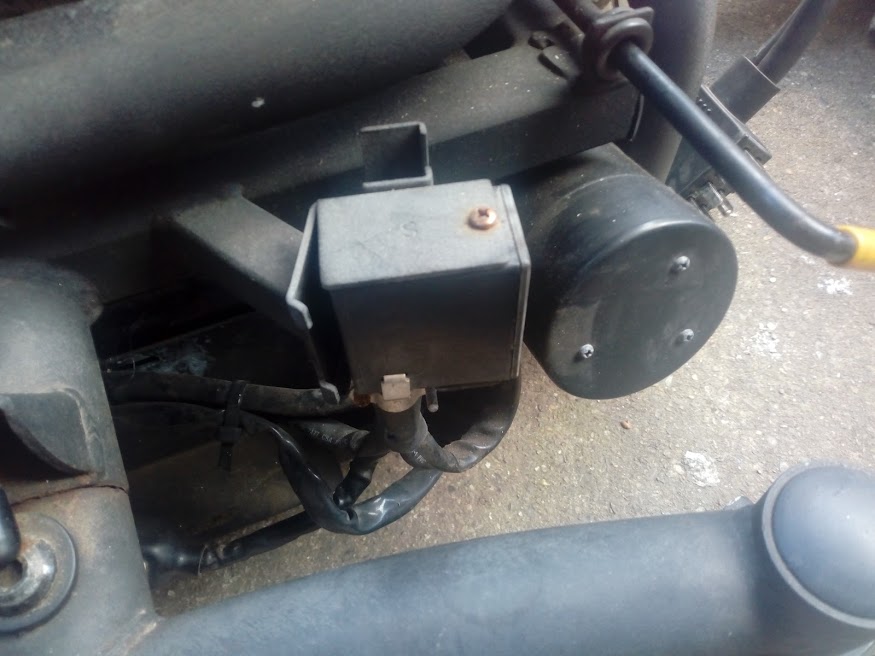

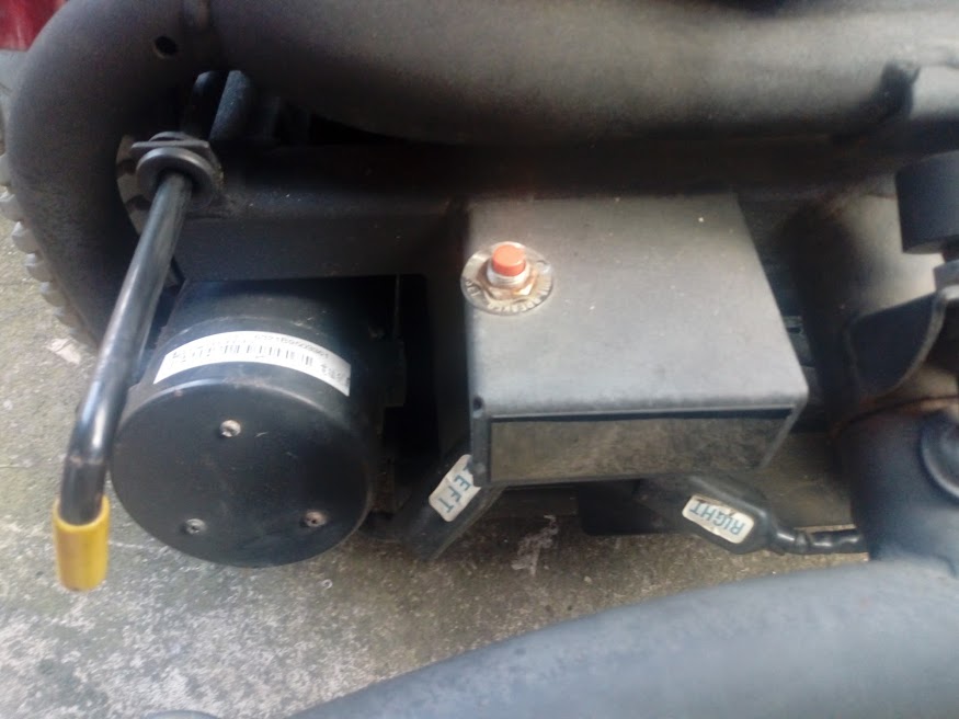

the closest model it shows to be shop-rider Lugano 888WNLL I have also attached images from shop-rider that all cables go to, I hope this helps, unfortunately I unable to find any other information of this machine at present,

The first pic is a Penny and Giles Vsi 4 key.
The second is a Dynamic DX2.
The programming lead will have a switch to toggle between the 2 types.

woodygb wrote:The first pic is a Penny and Giles Vsi 4 key.
Woody is fine .. :thumbup:
Second is Dynamic Shark
gcebiker
Posts: 879
Joined: 11 Jul 2015, 14:20
Re: Programming leads
Postby rover220 » 10 Apr 2021, 06:35
no it isn't, it is a dx2.
Postby gcebiker » 10 Apr 2021, 09:24
My bad, should have blown up the picture. :worship

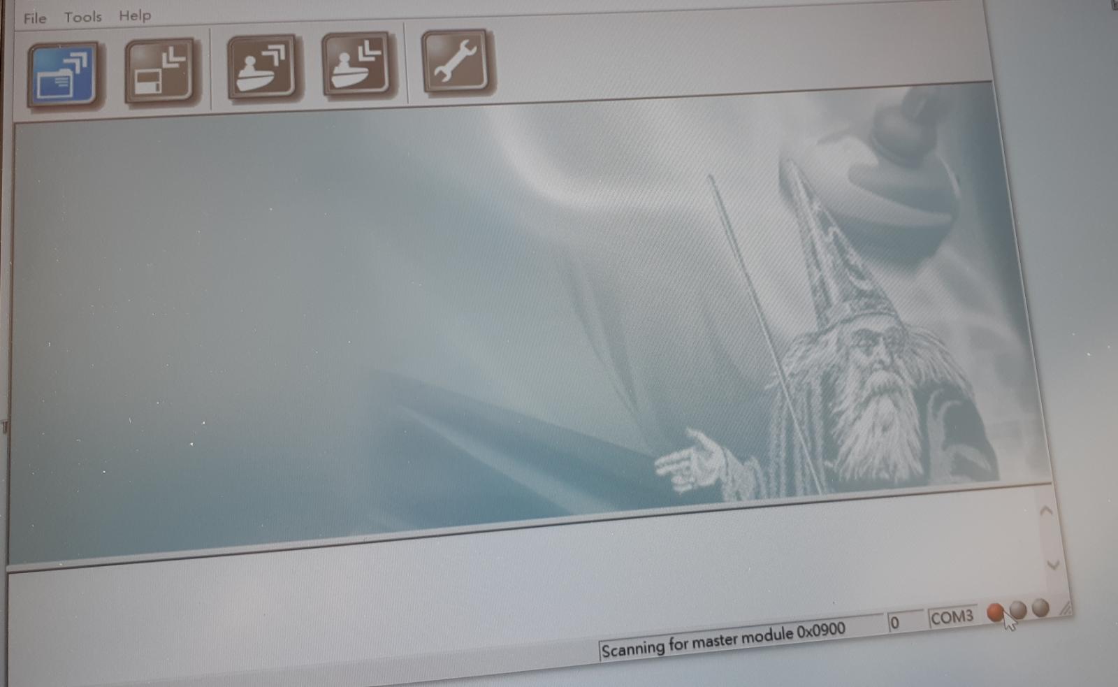

Postby shirley_hkg » 16 Nov 2021, 15:18
shirley_hkg wrote:woodygb, what is the proper connecting steps ?
I have the USB converter installed.
Plug in your lead. Joystick shows an inhibit.
Connect the other end to USB converter. Inhibit goes away. Is it normal ?
Launch Wizard, but see it is not connected yet.
Any advice ?
Is there a proper sequence of connection ?
Postby woodygb » 16 Nov 2021, 17:24
I think that any sequence will work.
HOWEVER...This is my normal procedure.
Plug in USB lead
Start Software...
Select Coms Port...
Turn ON Controller / Joystick
Wait while the DYNAMIC software searches for controller ... ( You can see the search bar in the bottom right hand corner )
Postby shirley_hkg » 18 Nov 2021, 11:48
Everything worked fine last year .
Try to program it last month but couldn't connect.
Today I tried again on another Win 10 laptop.
Same result , with endless scanning .
Any advice ?
Postby woodygb » 18 Nov 2021, 12:03

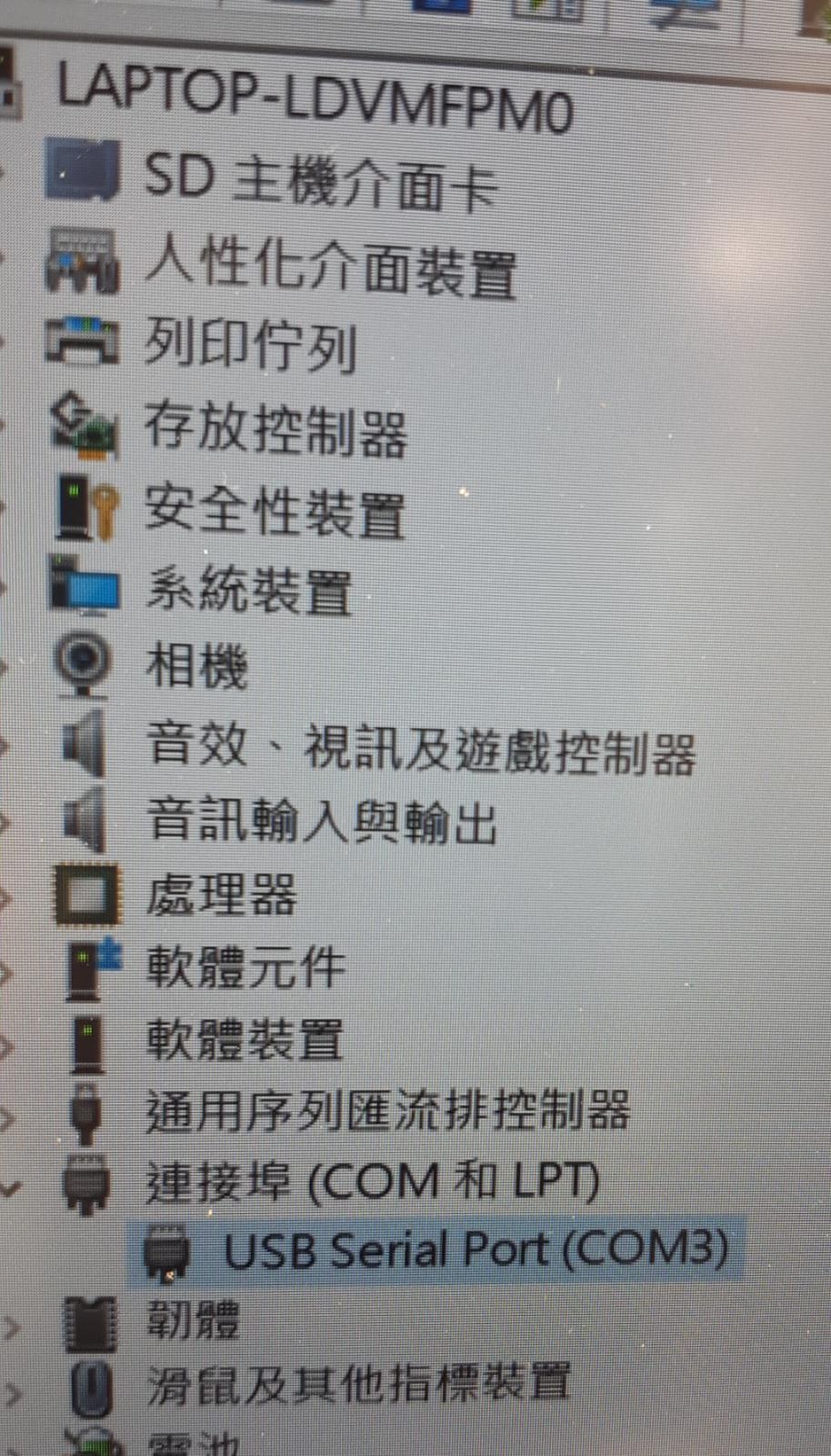

What controller ...what programming cable and is it possible that the device driver has updated in the last year?
Can you open up COM3 in device manager and show the driver version / date etc.
Postby shirley_hkg » 18 Nov 2021, 13:07
OK. Will check on it and return back . cheers Thanks.
Postby shirley_hkg » 19 Nov 2021, 01:13
Dynamic and the lead from you.
Will find out tomorrow , but it already said (ok , port in use) .
