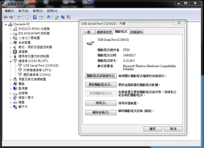

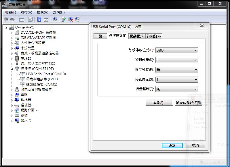

It's my PC @home, that worked fine last year.
Thanks for any advice. cheers
Re: Programming leads
Postby Burgerman » 19 Nov 2021, 07:18
Set it to a lower com port, 8 or less.

Burgerman wrote:Set it to a lower com port, 8 or less.
A previous pic from Shirley shows that he tried COM 3.
Postby shirley_hkg » 19 Nov 2021, 08:57
drunk2
It's my WIN_10 PC @home, that worked fine last year , and it was com 10 too.

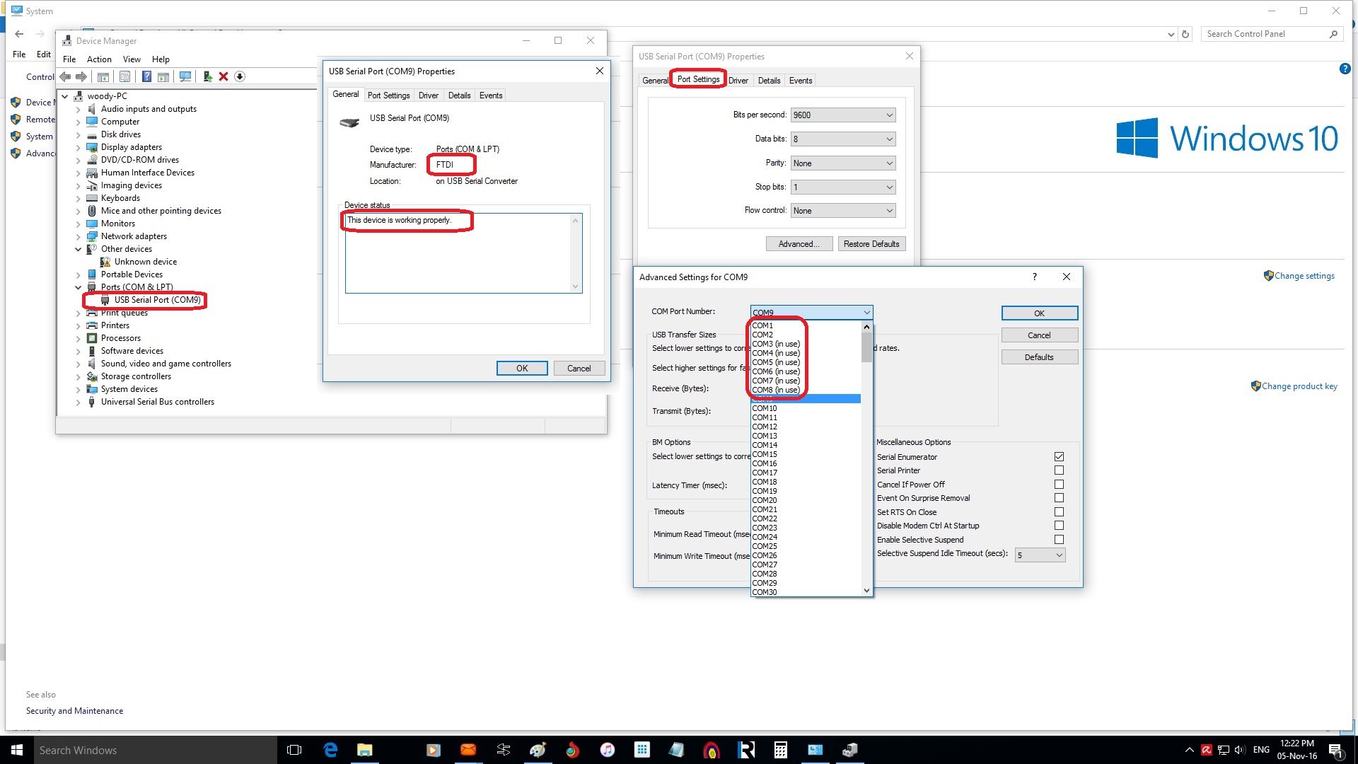

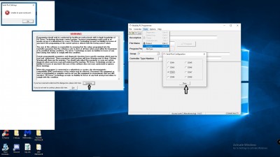

Now the Software is DIM and YOU will need to tell it which Com Port to use and it only recognises Com port 1-8 inclusive..
If the Com Port isn't in that range you will need to alter it.
NOTE ..it may whinge... UNABLE TO OPEN SERIAL PORT ... if the correct com port isn't selected when the software starts.... select the correct port and it will be happy.

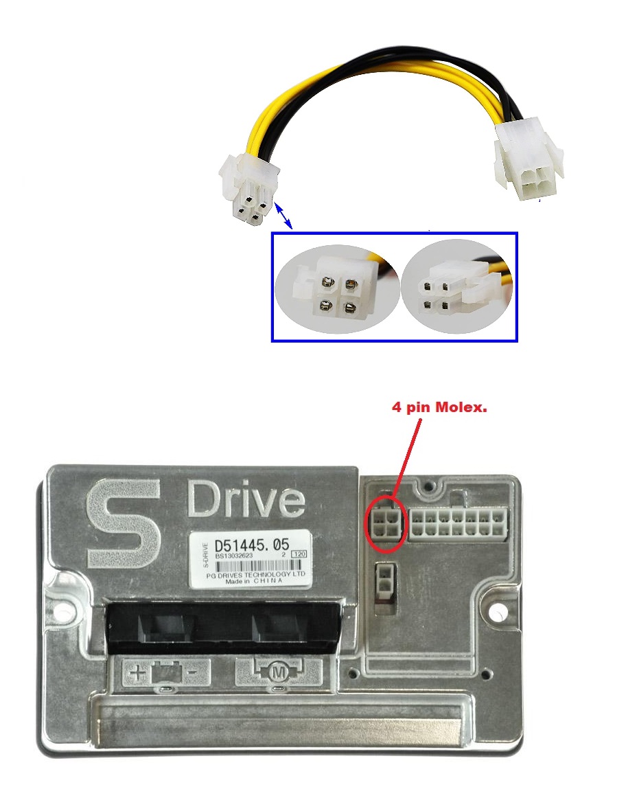

You seem obsessed with this manufacturer added DIN programming port ...why not do as I suggested in the private messages and remove the cover on the S-drive and access the 4 pin molex programming port?
Note that the DIN plug will be connected to the 4 pin molex .... it is also possible that the 3 pin XLR charging port is connected to the 4 pin Molex and thus could also be used as a programming point.

Postby Sutneosv » 04 Mar 2022, 09:39
I don't know what to do anymore....
I am unable to run the program - as David1566 described above....
when I want to set the port there is a blanking see photo, I don't know how to set the FTDI manufacturer. the cable is connected, the ports can't be set (or they can, but I still can't start it)
either I have a cable wiring error - when I measure the cable, it's according to the wiring I got and read here on the forum...

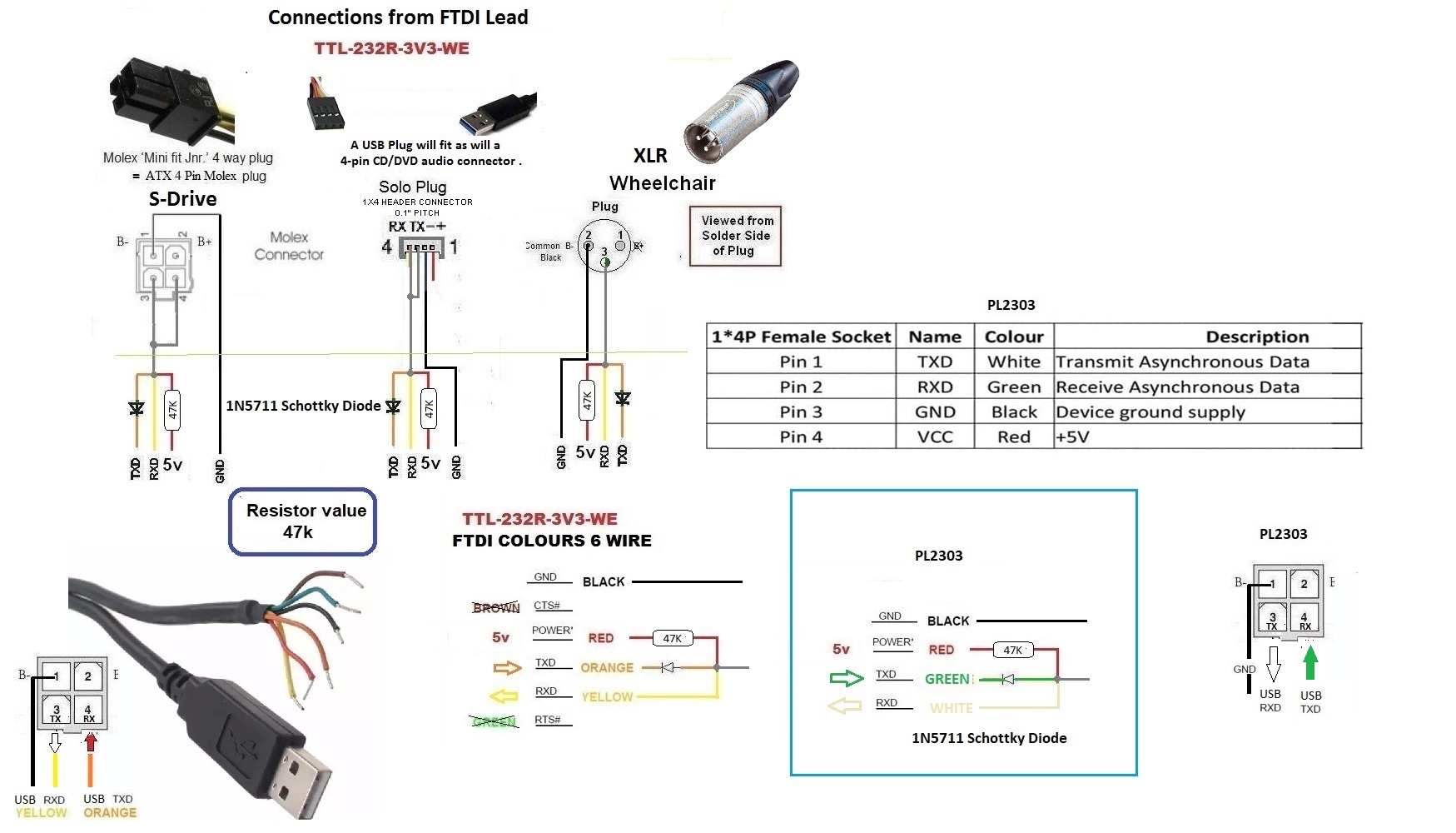

Postby woodygb » 04 Mar 2022, 12:03
I have 3 of those nasty Prolific cables that give the error that you have and have just now been playing with them.
I CANNOT get them to work with the MOBILITY software ...I have however managed to make them work with the INDUSTRIAL software.
I connected to a 45 AMP S-drive via the Molex , wired as shown in the bottom right of this picture.
I will give you a link to the Industrial software via P.M.
