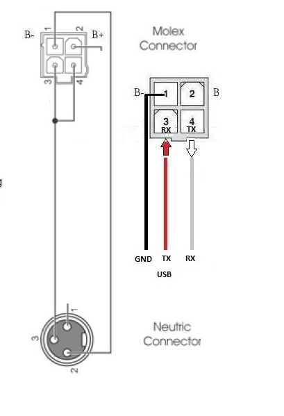

Hi Woody, i purchased an s-drive programming cable from you a while back, which has served me well. I now need to program my latest scooter through the charging port. is it possible that you can give me the pinout for the charge port programming. i.e. connections on the four pin plug that i have go to which pins on the round charging port.
Thanks in advance,
Bob.
bob_viv
Posts: 15
Joined: 25 Oct 2019, 15:37
Location: Nottingham UK
Re: Programming leads
Postby woodygb » 11 Aug 2022, 10:25
Here you go ....
Are you certain that your new scooter uses an S-Drive?

Hi Jeff,
The S-drive lead is NOT compatible with the Rhino2.
The hacked Wizard software doesn't require a dongle.

The parts that you already have will not help.
I can however make you an interface that will do both the S-Drive ( plus VR2 , Vsi ,Pilot+ , Egris and SOLO ) and the Dynamic Rhino2 / Shark...A switch is used to select which make either PGDT or Dynamic .

Hi Jennifer,
I have one here ...it is a dual programming interface that will be suitable for most P.G.D.T controllers and the Dynamic Rhino2.
I do not know if you can program via the 3 pin XLR ...you would have to try and see.
Note the interface comes with both a 3 pin XLR and a 4 pin Molex connection option.
