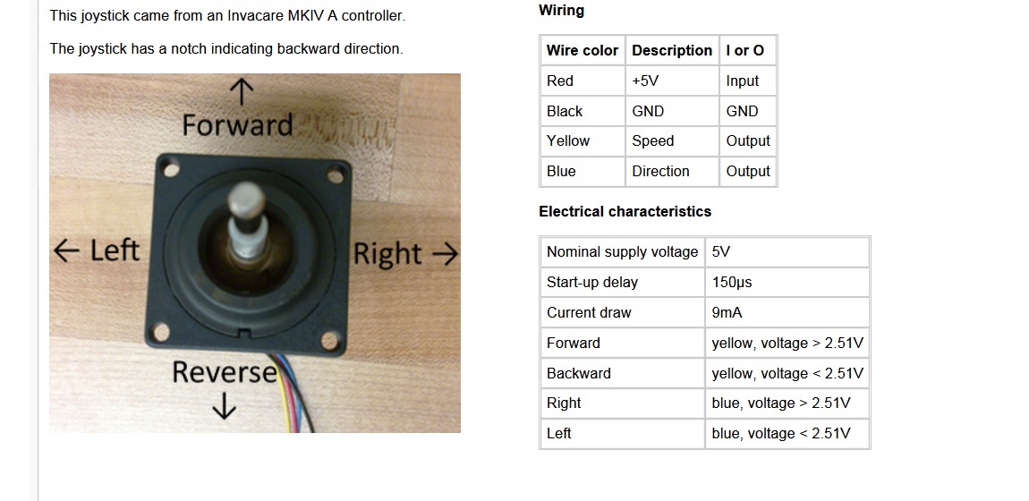

Postby woodygb » 17 Feb 2017, 12:54
My previous internet searches suggest that it is a simple 5v voltage swing .

Re: Programming leads
Postby Burgerman » 17 Feb 2017, 12:56
https://dynamiccontrols.com/en/download ... anual/file
Agrees. Page 3...
5-Volt Dynamic
Joystick
A 5-Volt Dynamic Joystick is used to control the
wheelchair when in ‘Attendant’ Mode.
Posts: 70444
Postby woodygb » 17 Feb 2017, 13:01
I'd certainly require the joystick ...making the interface interchangeable with other 5v voltage swing chairs that you might own would require an external socket and a plug to replace the interface ....this plug would reconnect it back to original config.
