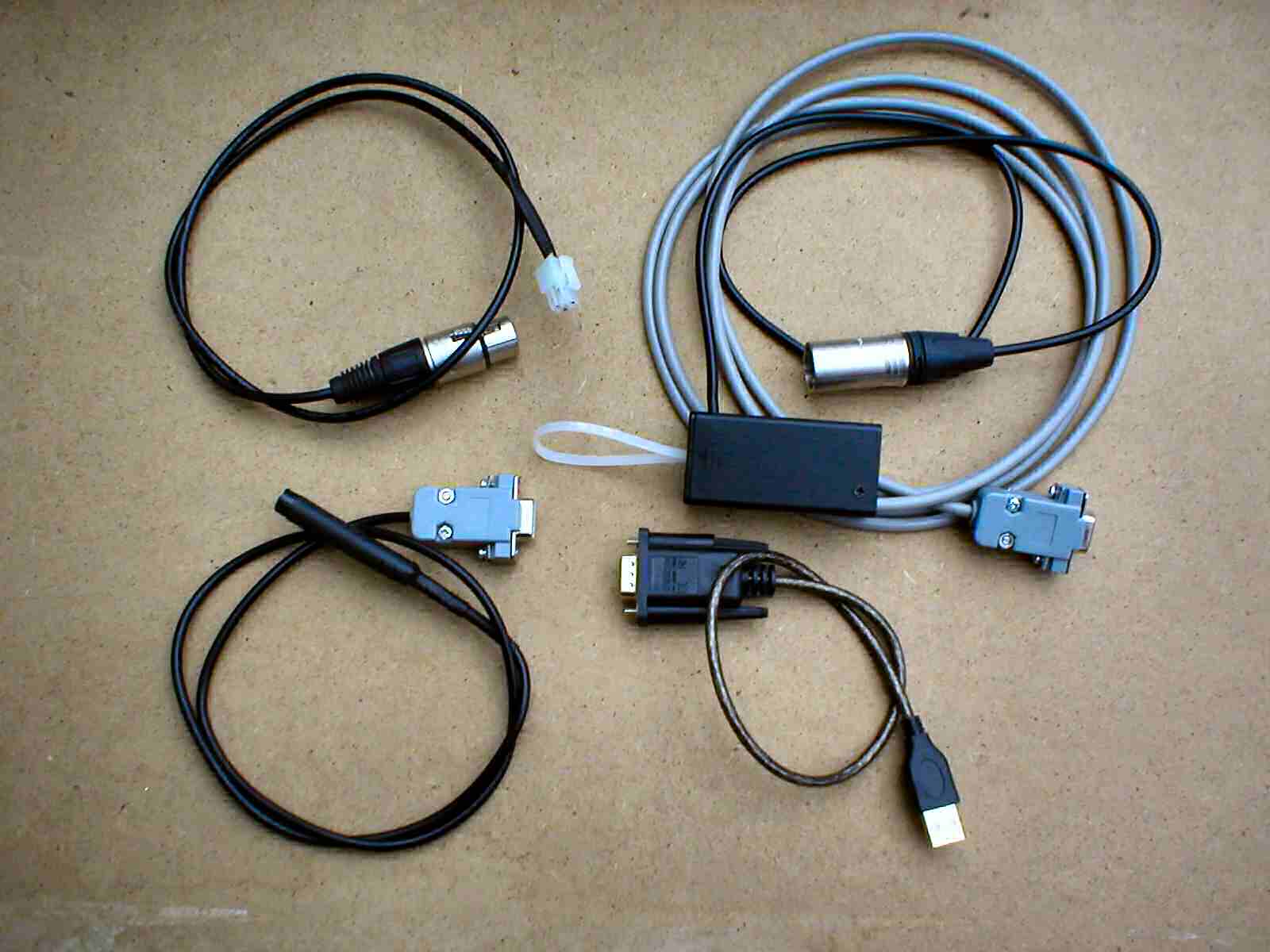

Postby woodygb » 15 May 2018, 11:49
I can supply the various interfaces.
Top right is a HOMEBREW "DWIZ-ADAPT" based on a electronic sketch supplied by Anubis... the other... top left is the Rhino 2 adapter..
NOTE:- You WILL need the modified Wizard 5 software .
